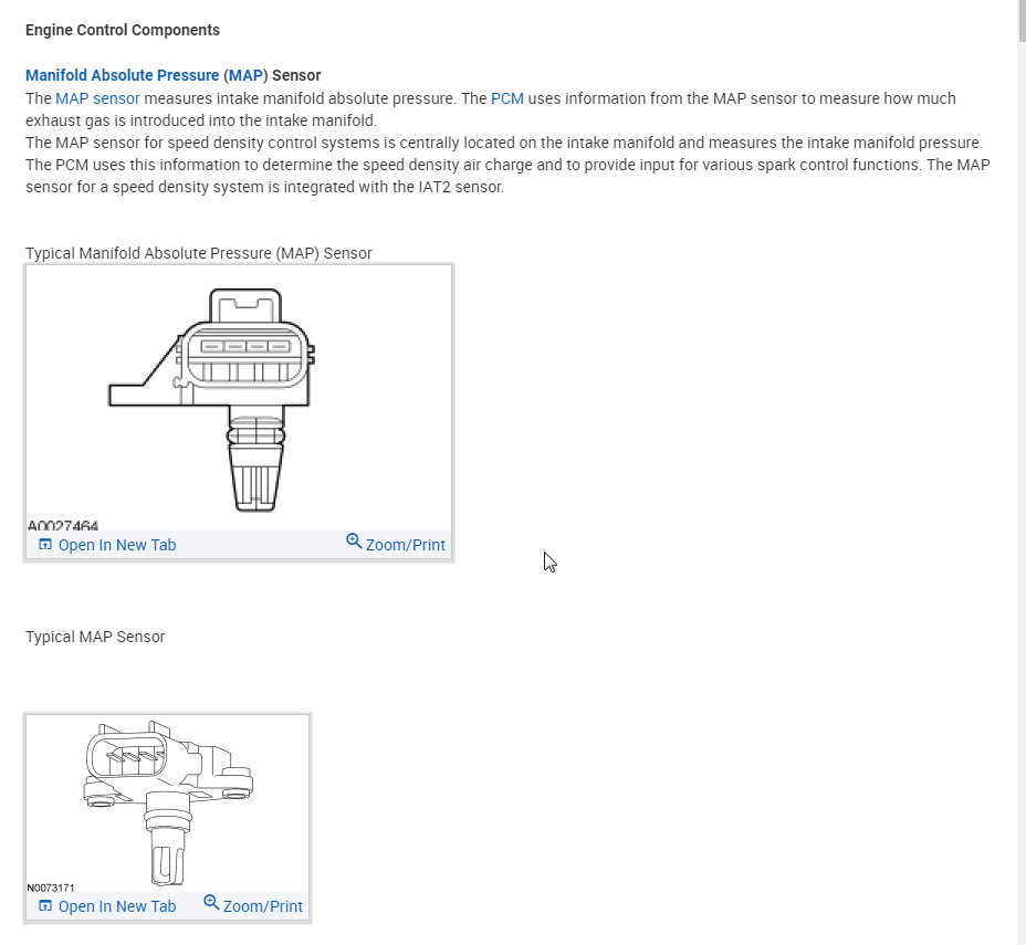

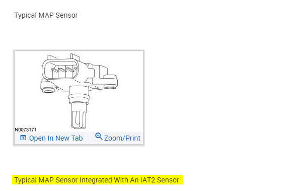

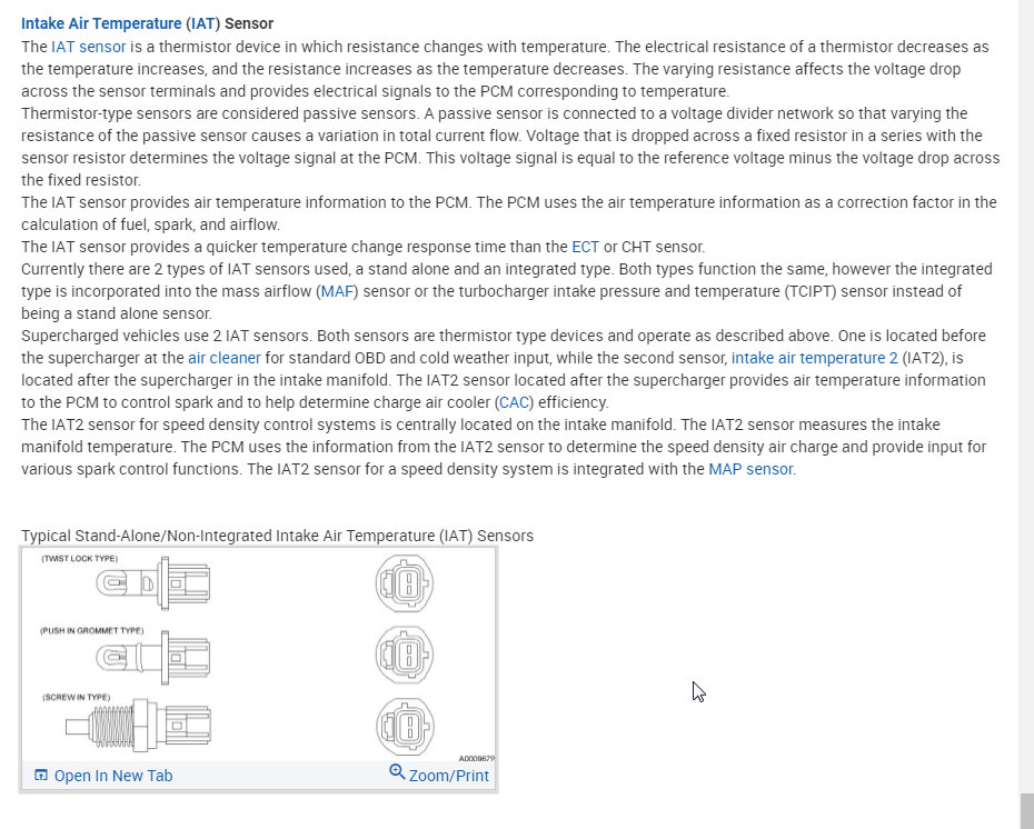

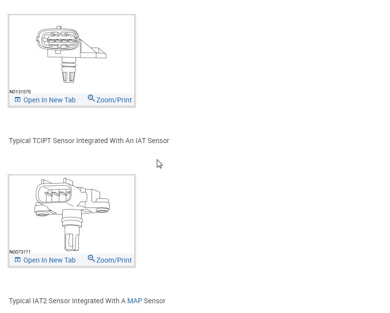

You vehicle is the 1.6L supercharged, correct? If this is the case then you don't actually have a MAP sensor. You have two IAT sensors, one before the supercharger and the other after it. The IAT2 has a MAP sensor integrated into it. I attached the info. It states the IAT2 is in the manifold.
I am trying to find a detailed picture of it as you requested but haven't found one yet. I will ask a contact that I have at a dealer to see if they can find one.

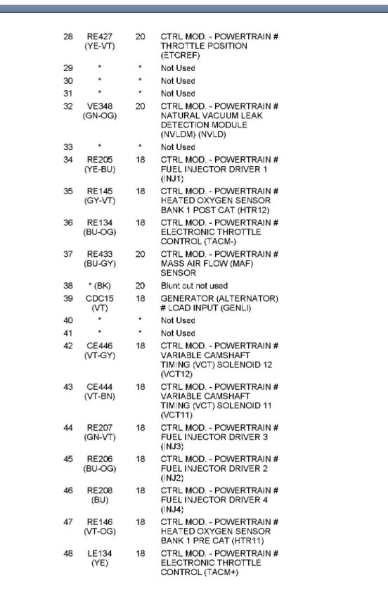

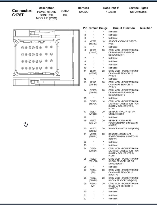

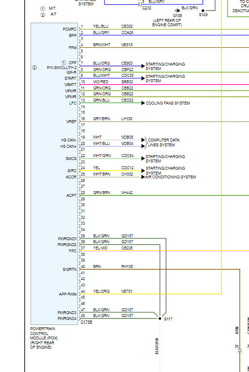

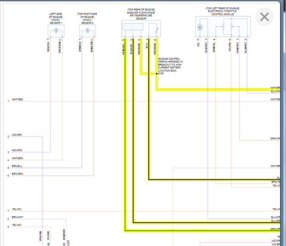

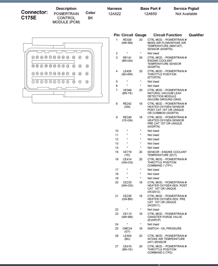

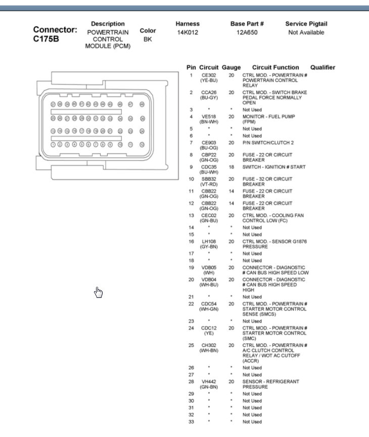

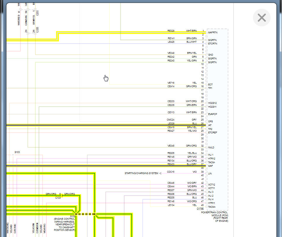

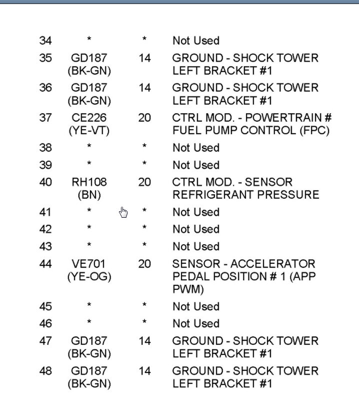

Just running through this and it appears your engine does not have a MAP sensor. It has a MAF and the PCM uses the MAF and throttle input to determine the manifold pressure.
Is there a reason you are thinking there is a MAP as well? There are engines that have both but your engine appears to only have a MAF. Again the MAP is then a calculated value.
Take a look at the wiring diagram below of the PCM and the pinout charts and you will see that this engine does not have a MAP. The PCM would have a circuit for it and it is not there but the MAF is.
Please let us know if you have other questions. Thanks
