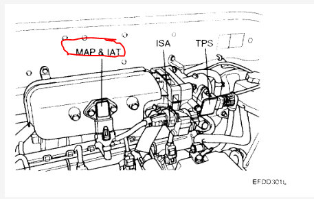

Where is the MAP sensor located?
2003 KIA RIO
90 MILES • 1.6L • 4 CYL • 2WD • AUTOMATIC
PATTYBOY
MEMBER
6 POSTS
MAP sensor replacement.
Oct 21, 2021 at 2:24 AM
SQM
Experienced Mechanic
6,383 POSTS
The manifold absolute pressure (MAP) sensor is located under the air filter box, top of the intake manifold (see diagram below).
Image (Click to enlarge)
