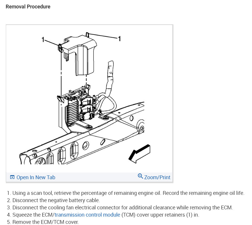

So, I bought the vehicle listed above that was missing the MAP sensor. I bought a sensor and installed it but now the vehicle won’t run. If I take the sensor back out it runs but rough.
Oct 18, 2022 at 6:07 PM
  • 55,399 POSTS

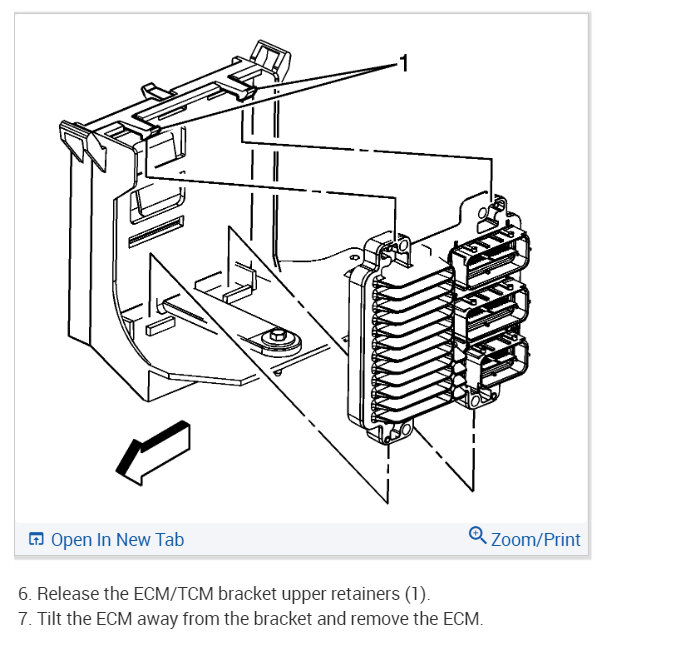

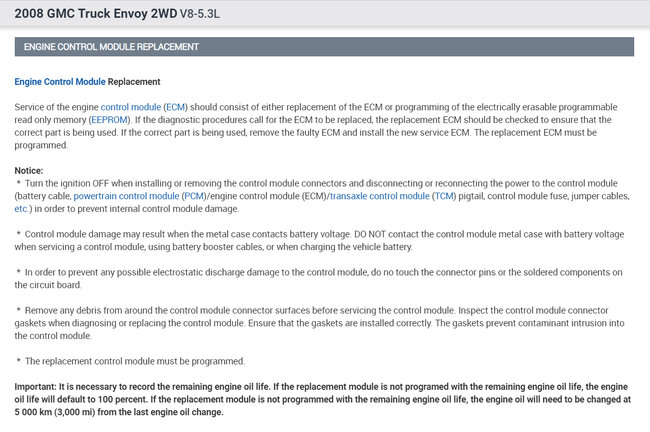

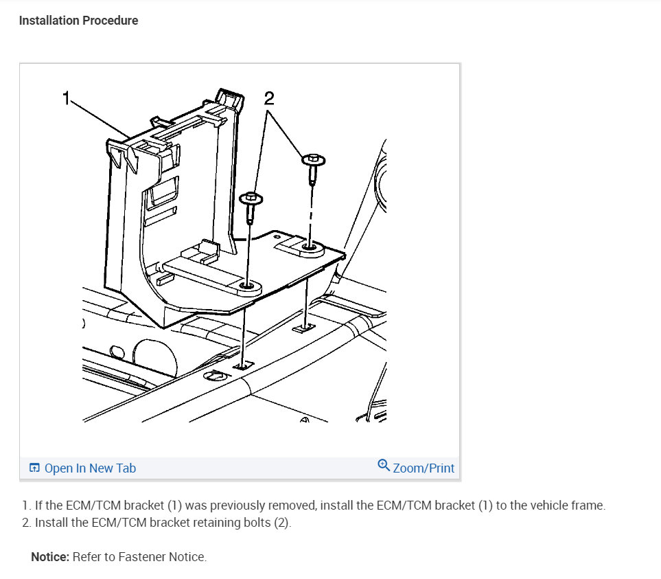

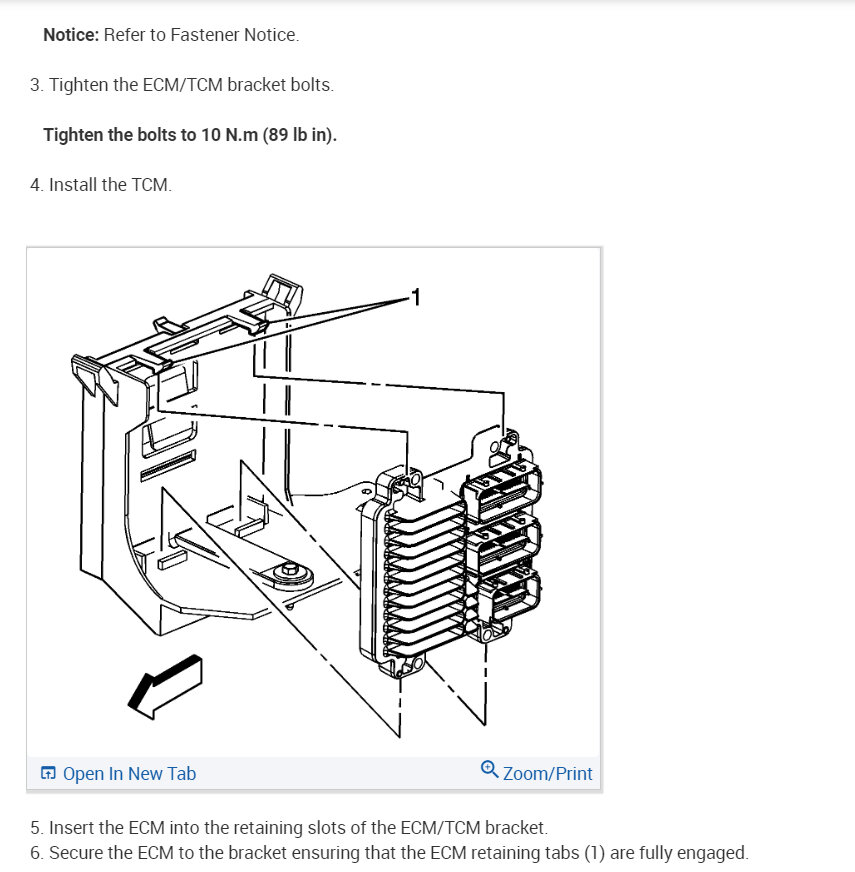

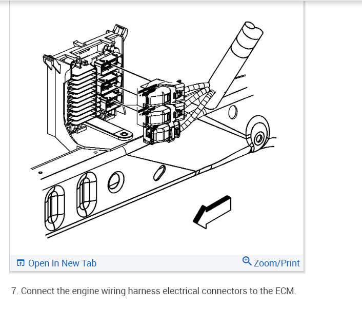

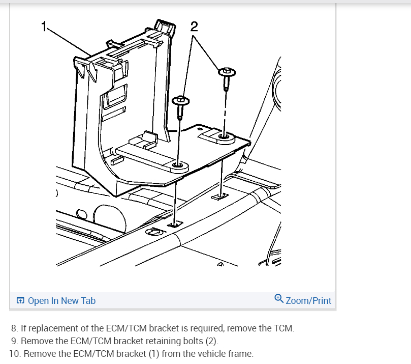

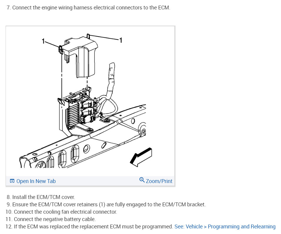

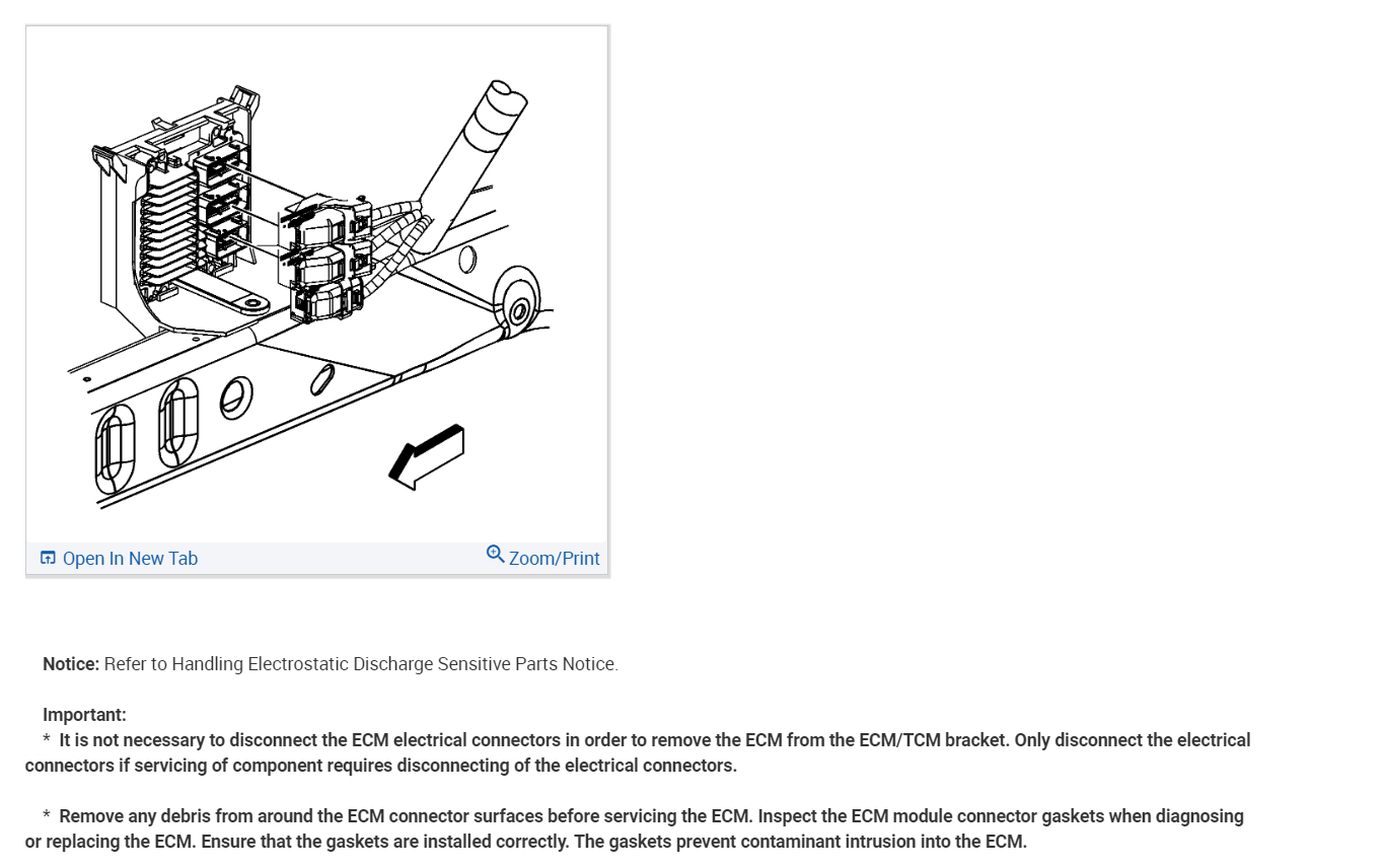

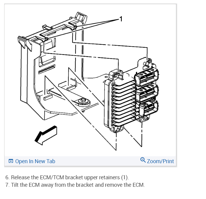

Changes are the MAP sensor is defective. If not, it sounds like the PCM is bad. here is the location and instructions in the images below to help you change it out, you can find a rebuilt PCM by searching Google or eBay. Check out the images (below). Please let us know what happens.
