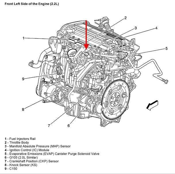

MAP sensor location
2005 SATURN ION
154,000 MILES • 2.2L • 4 CYL • 2WD • AUTOMATIC
BRITNEY NICOLE BARKER
  • 6 POSTS

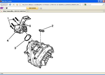

I know for sure it is the MAP sensor. But where is it located at? All photos I have seen on line are blurry and sadly no videos are available for the Ion level 3.
Jun 15, 2018 at 10:09 AM
CARADIODOC
  • 34,382 POSTS
What problem or symptom are you trying to solve? Others researching this might have the same issue.
Check the image below

I did not need to give the code when I know and have the part. If you look at my post I say I know it is that part because that parts code come up whenever we run the computer through a check system. P0106 which makes the check engine light come on, engine rough idles, and the engine hesitates a bit. So no I did not fail to give a code when I asked originally where a part was located.

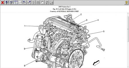

Engine Mechanical problem
2005 Saturn Ion 4 cyl Two Wheel Drive Manual

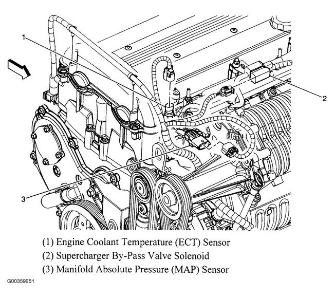

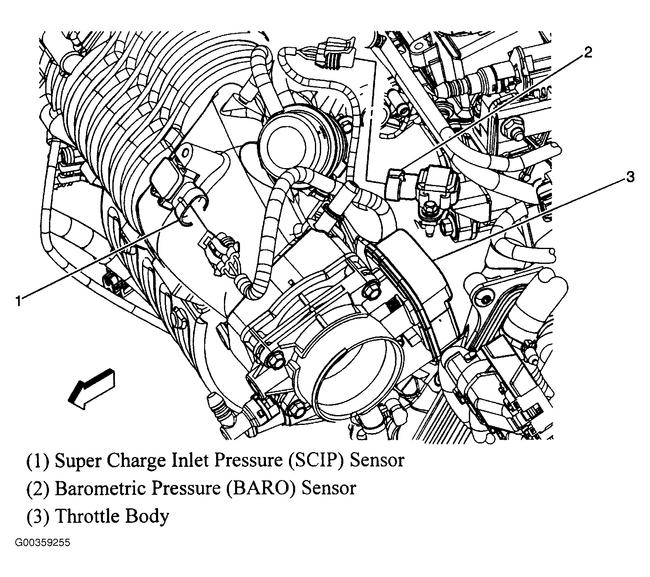

where is the map sensor located
Mar 10, 2019 at 3:45 AM (Merged)
  • 75,992 POSTS

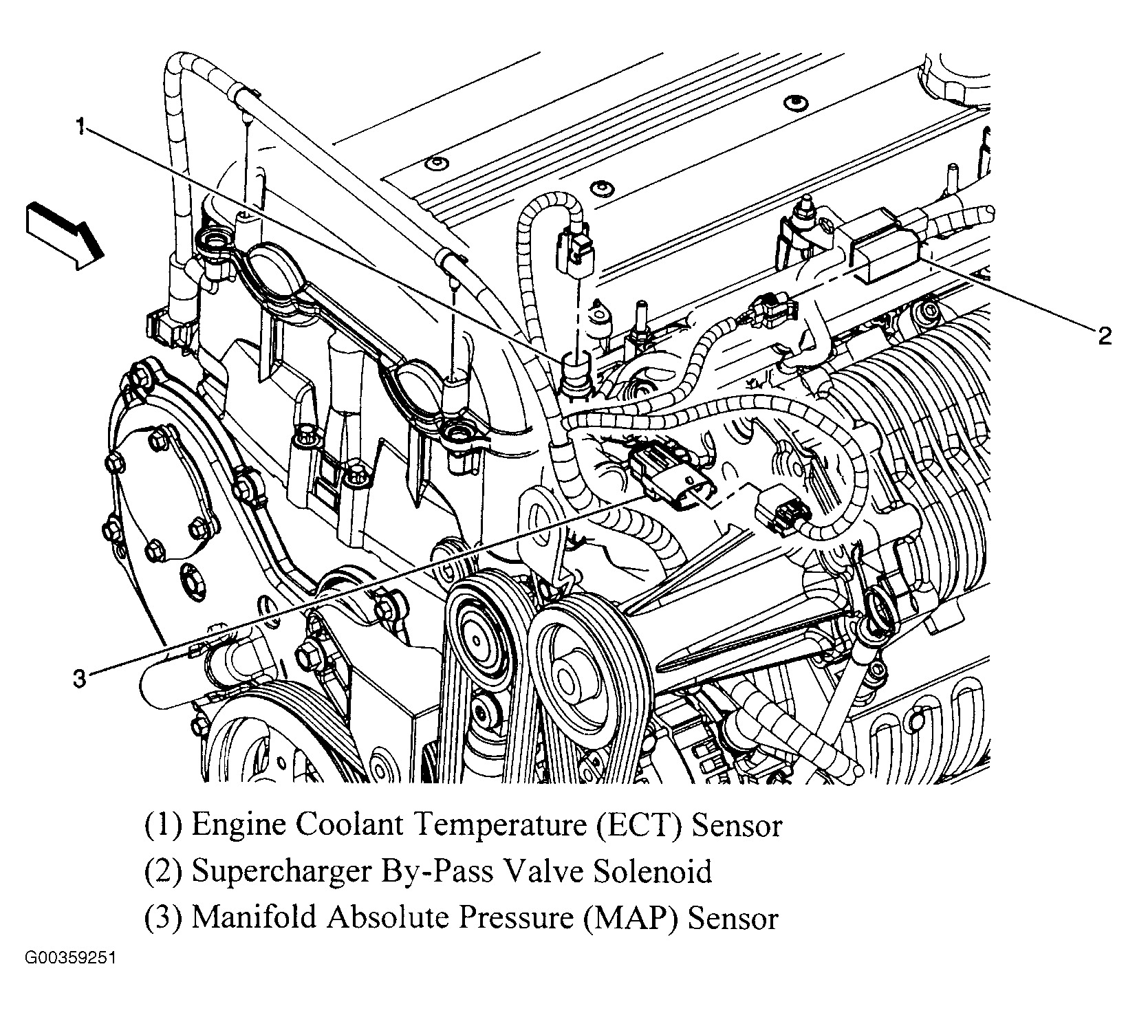

MAP Sensor-Good luck 2.0L is on top right of engine above supercharger
https://images.2carpros.com/forum/automotive_pictures/12900_map1_5.jpg

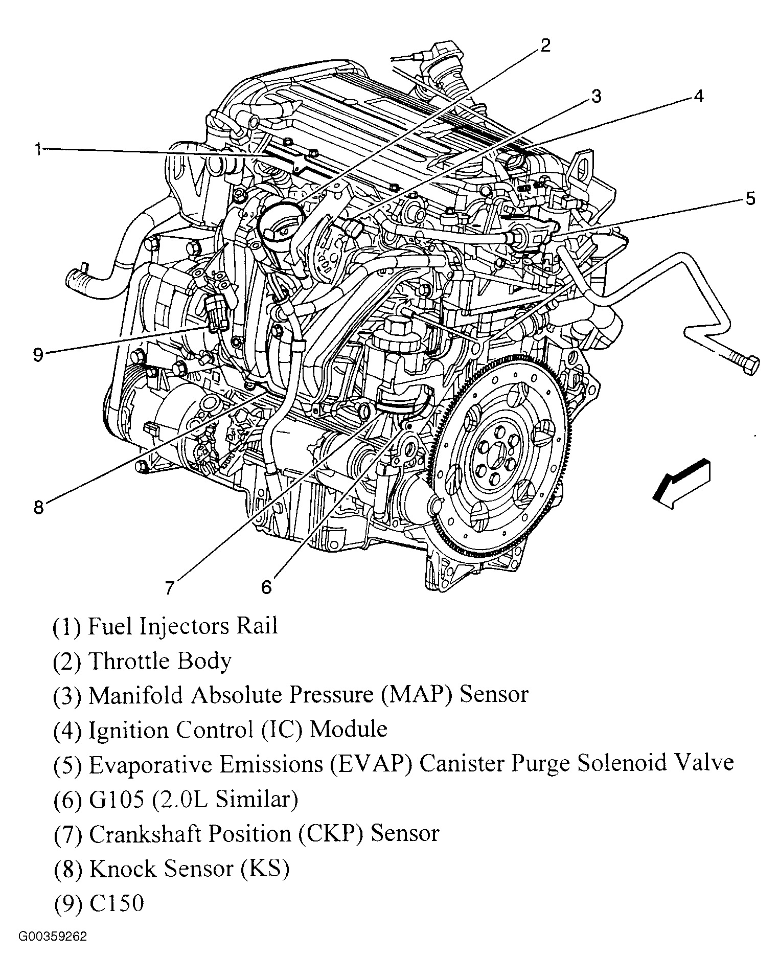

2.2L on top rear of engine behid throttle body at no.3
https://images.2carpros.com/forum/automotive_pictures/12900_map2_4.jpg

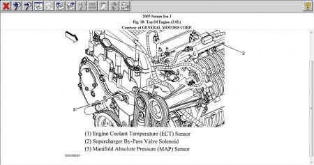

I WENT INTO "MITCHELL I" WITH "ION 2"
SEE IF THESE COULD BE RIGHT
1) 2.0L
2) 2.0L
3) 2.2L
4) 2.2L
LEMME KNOW IF THIS HELPING

TAS76
can anyone tell me where the map sensor is located and if replacing this would fix the intermittent loss of throttle while driving and the intermittent idle at 3-4000rpm thanks
SATURNTECH9
  • 30,869 POSTS
https://images.2carpros.com/forum/automotive_pictures/416332_2003_ion_map_sensor_1.jpg
It's item number 2 in the diagram if you have a 3-4000 rpm idle i would be looking for a vacuum leak when the idle is that high.
