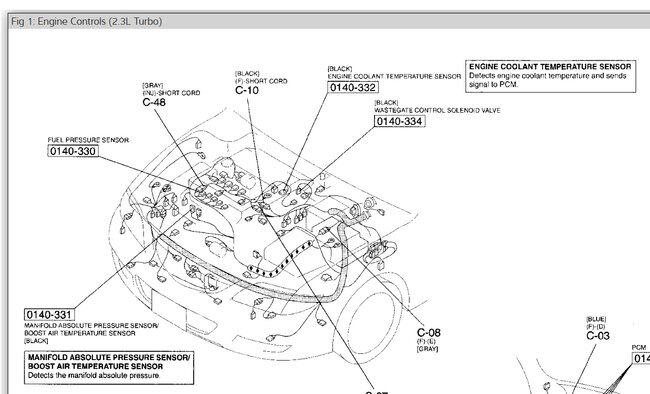

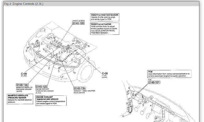

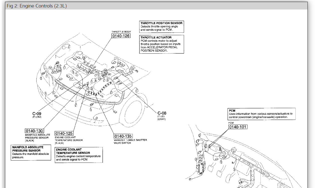

Hey.
Can you send me pictures of MAP sensors location (if there are more than one)?
Apr 16, 2023 at 8:59 PM
  • 55,433 POSTS
Sure, here is the location of the MAP sensor which there is only one of. Check out the images (below). Please let us know if you need anything else to get the problem fixed.
Apr 17, 2023 at 5:58 AM
TONI KUKKE
  • 20 POSTS
I think it's the old model Mazda 6 you sent picture of.
