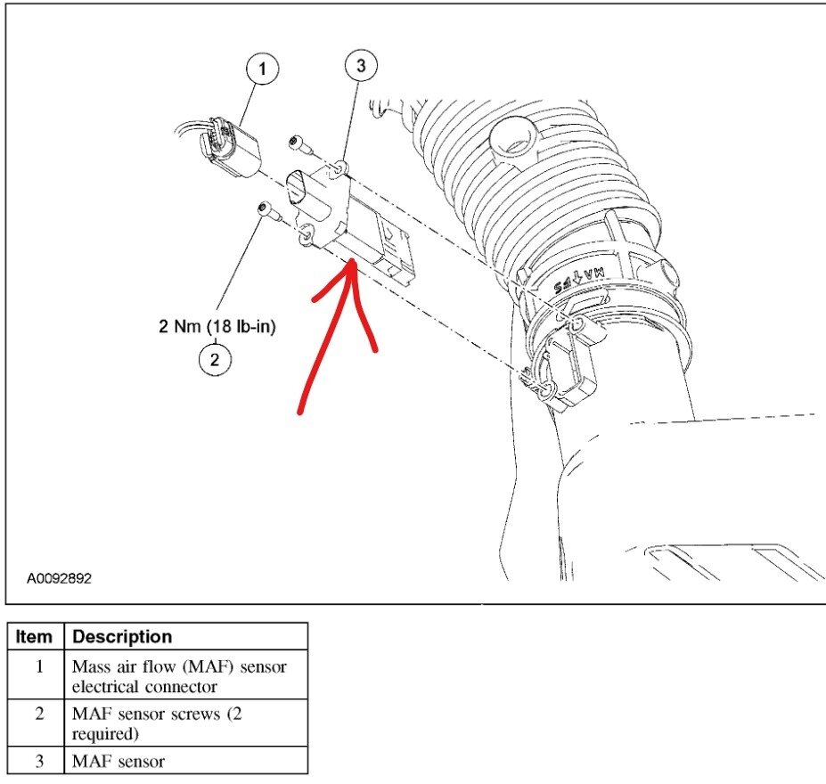

Can’t find my maps sensor location I need a picture and or video
Feb 4, 2026 at 5:58 AM
STEVE W.
  • 15,407 POSTS

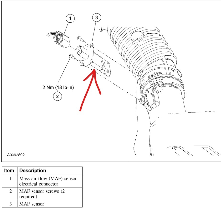

That vehicle doesn't have a Manifold Absolute Pressure sensor on it. It uses a Mass Airflow Sensor system instead. The MAF sensor is in the intake tube after the air filter.
What seems to be the issue?
