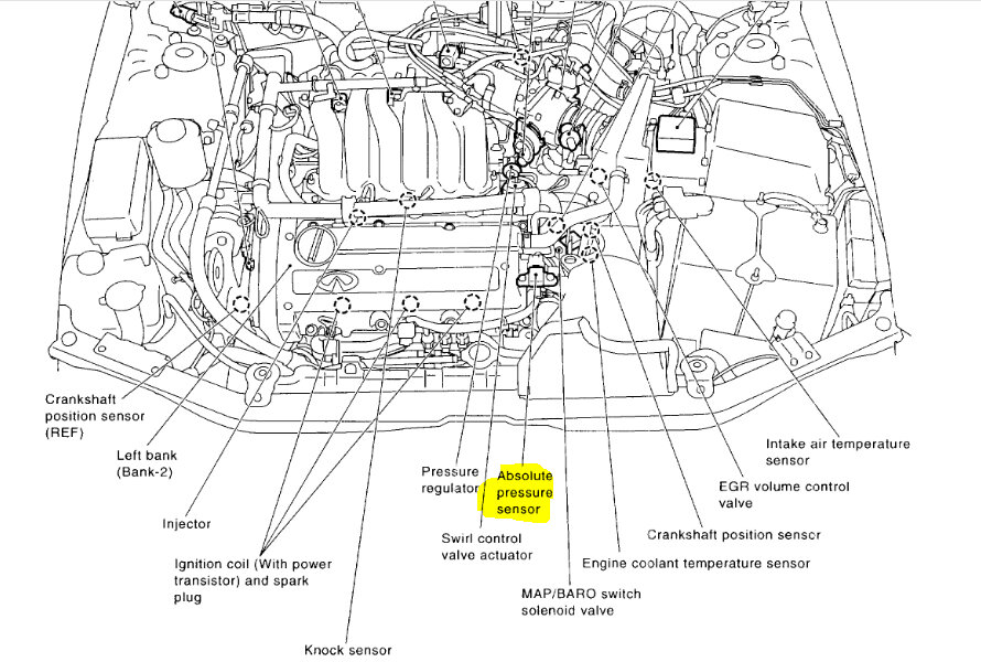

Code p0105, where is the MAP sensor located?
1999 NISSAN MAXIMA
167,000 MILES • 3.0L • 6 CYL • 2WD • MANUAL
JMJR
Went to AutoZone got a p0105 code, strong smell of fuel. Recently changed camshaft and crankshaft sensors. The car is on and stalls while driving. My car does not have an air intake duct. What I saw on posts is MAP sensor s attached to this scoop. My car doesn’t have one.

If you look below, I attached a picture of the absolute pressure sensor. When you open the hood, look to the rear of the valve cover directly in front of you.
Take a look at the picture and let me know if it helps.
See pic below.
