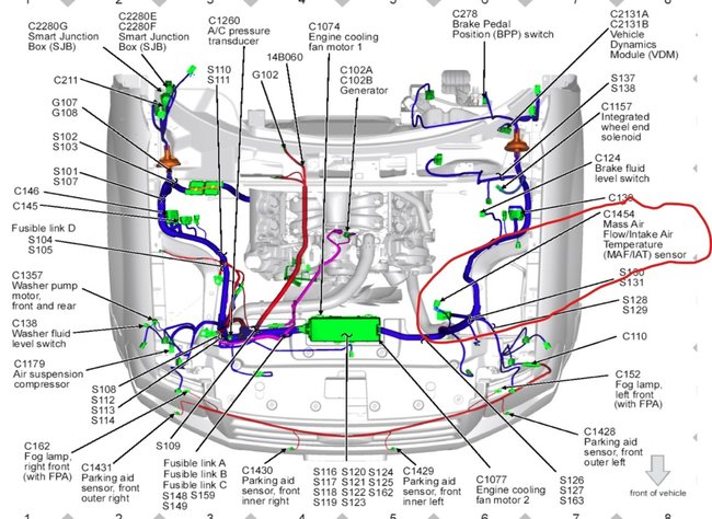

MAP sensor location needed
Nov 24, 2021 at 10:41 AM
STEVE W.
  • 15,295 POSTS
The 5.4 3 valve in those doesn't use a MAP sensor, they use an integrated Mass Air Flow and Intake Air Temperature unit instead.
What is the issue or code you have that suggests a MAP sensor problem?
Have you checked codes?
Thanks
Nov 24, 2021 at 4:26 PM
CMOSELEY
I do not have a reader I am having erratic idle conditions and loss of power and excessive fuel consumption all which can be remedied by disconnecting the battery resetting computer then conditions will come back within 100 miles.

Yes I do have check engine light I will be going to have it set up for diagnostics at a shop tomorrow I changed the MAF sensor with a aftermarket sensor and all the exact symptoms I was having immediately presented themselves I installed the old sensor back in and vehicle operation went back to normal which will change at some point im sure once I drive some next question given messing with that sensor immediately replicated all the problems I was having is this vehicle sensitive to aftermarket sensors non motor craft or is it possible I just got a bad one.
