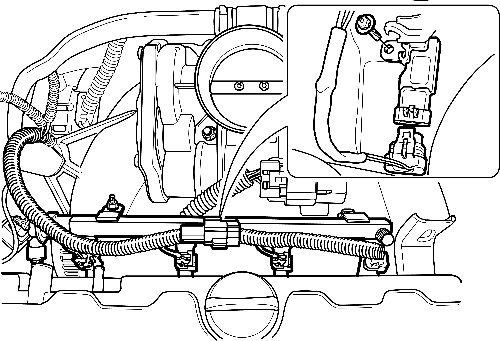

Hi and thanks for using 2CarPros.com. The MAP sensor on your vehicle is located below the throttle body air intake. I have attached a picture to help locate it.

AARONDAHL
Picture does not look the same as my motor even.

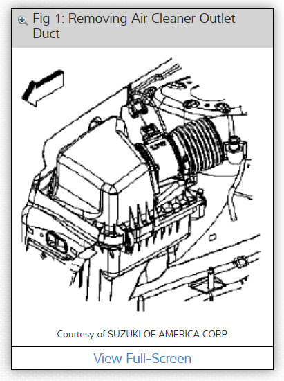

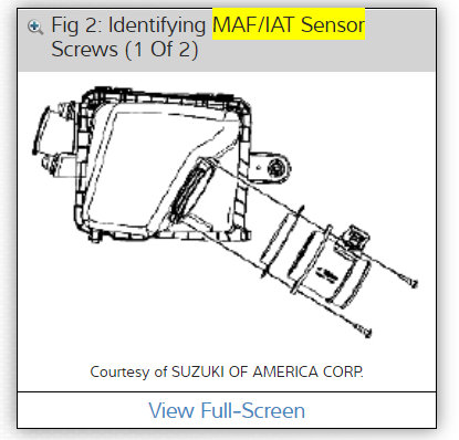

I think this car has a MAF sensor not a MAP. This is what the book shows (below).
This guide show help as well:
https://www.2carpros.com/articles/how-to-replace-a-mass-air-flow-sensor-maf

I changed the mass air flow sensor (MAF), but even if it do not have the oil pressure gauge in the vehicle it should still have a manifold absolute pressure sensor (MAP)? I cannot find the location of the MAP sensor. And I cannot find anything online about any of it and to send this to a dealer would be too expensive.
