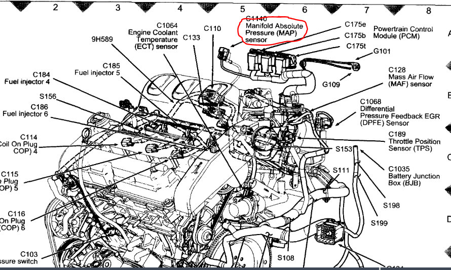

Need to find MAP sensor location. And how to replace it.

I'd be happy to help but I need a little more info about your vehicle. Is your truck equipped with the 2.3L L4 cyl or 3.0L V6 engine? Get back to me and we'll be happy to help.Thanks for using 2CarPros.

3.0l.

Hello again.
I've attached a picture below of the MAP sensor location.It's on the middle-top of the engine in the rear near the firewall.On the picture below I circled its location in red.Here is a basic tutorial of the mass air flow sensor which is similar in design:
https://www.2carpros.com/articles/how-to-replace-a-mass-air-flow-sensor-maf
Hope this helps and thanks again for using 2CarPros.
