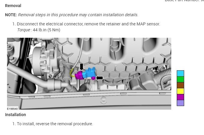

Originally cylinder 2-3 were full of antifreeze, had the head cleaned up new coils, plugs, cam sensors, phasers and timing. Car started fine the started rough idling leaking towards the MAP sensor but can’t locate.

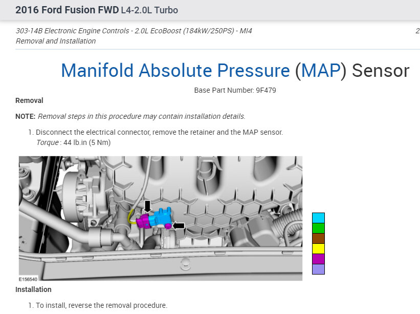

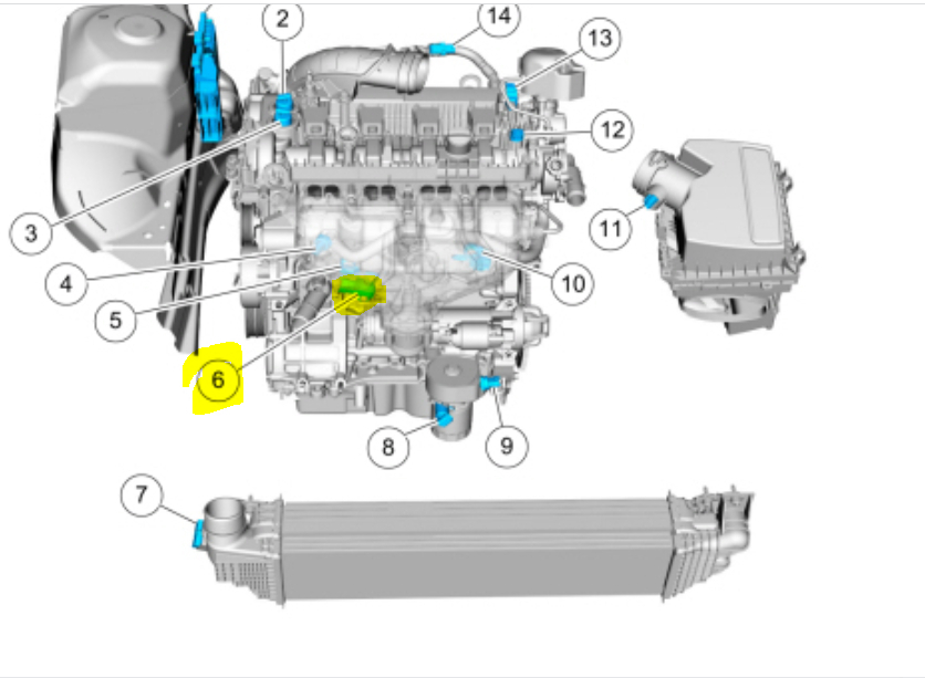

I attached two pics below to help you locate the sensor. Take a look at them and let me know if they help.
Also, if you haven't already, check for other possible engine vacuum leaks.

See the attached for the location and replacement on the top left of the engine.
