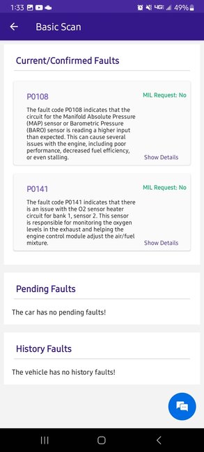

As far as the MAP sensor is concerned, that is way higher than I would expect. At idle, it should be approximately .5 to 1.5v. Your readings are extremely high. Is this the new sensor?

This is what I'm getting now. There is also a very distinct whistle coming from somewhere I haven't pinpointed yet.

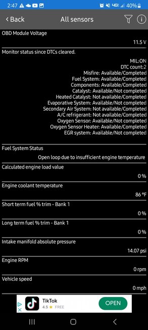

This is all i can get for the open loop.

Was that checked when the engine was cold? It indicates the engine is operating at 86F. Either the engine was checked immediately after start-up, or the coolant temperature sensor is bad.

It was right after startup, after it warms up it switches to "open loop due to system failure"
Oct 17, 2023 at 10:31 PM
  • 110,194 POSTS
It should be in an open loop when first started and once a predetermined temperature is reached, it goes into a closed loop. That doesn't make sense to me. Are you able to check the engine coolant temperature when it reaches operating temperature?
Oct 18, 2023 at 5:15 PM
PAGE0210
  • 20 POSTS
It floats between 175 and 180.
Oct 20, 2023 at 12:25 AM
  • 110,194 POSTS
The temperature is a little low. It should be 195F or more. You may want to consider replacing the thermostat to see if that allows it to reach operating temperature. Or, you may have already done that.
