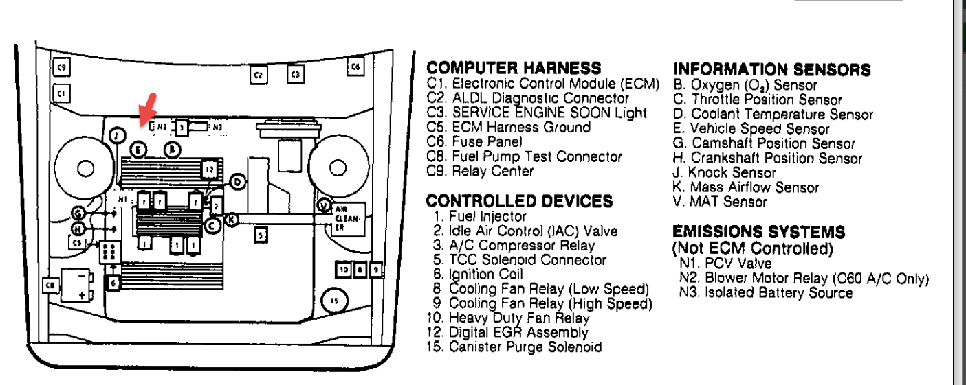

Cannot find the map sensor. Need help.
Monday, July 17th, 2017 AT 6:13 PM
HMAC300
MECHANIC
48,601 POSTS
Picture is not really good, but it is by blower motor in center of dash. There will be a vacuum line going to it. While at it replace the vacuum line as well as due to age it may be sucking together not making map sensor work.
