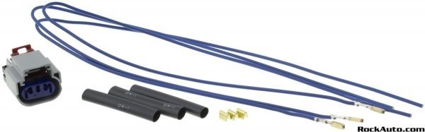

Car will chug at various times like it misses. When putting transmission fluid in it it shut off when I touched the MAF sensor.
it would chug or miss when wiggling the wires on the MAP sensor.
I unplugged it shut off. Today I unplugged it and it stayed running. Is it bad?
Oct 25, 2017 at 5:37 PM
STEVE W.
  • 15,418 POSTS
It sounds like a bad connection or bad wire if just touching the harness causes a problem. I would check the wires for corrosion and tug each one to see if they are corroded inside the actual connector at the crimp. You can get a replacement connector for around thirty dollars or visit a salvage yard and get two or three for that price.
It is also possible to buy the small connectors but then you need the special crimp tool to install them as they are tiny.
