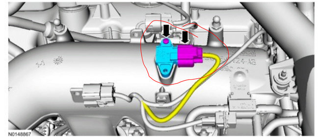

Where is located MAP sensor? any diagram or picture?
Aug 2, 2020 at 1:05 PM
  • 110,244 POSTS
It is located at the top of the air intake. I attached a picture. Let me know if this helps. Check out the diagrams (Below). Please let us know if you need anything else to get the problem fixed.
