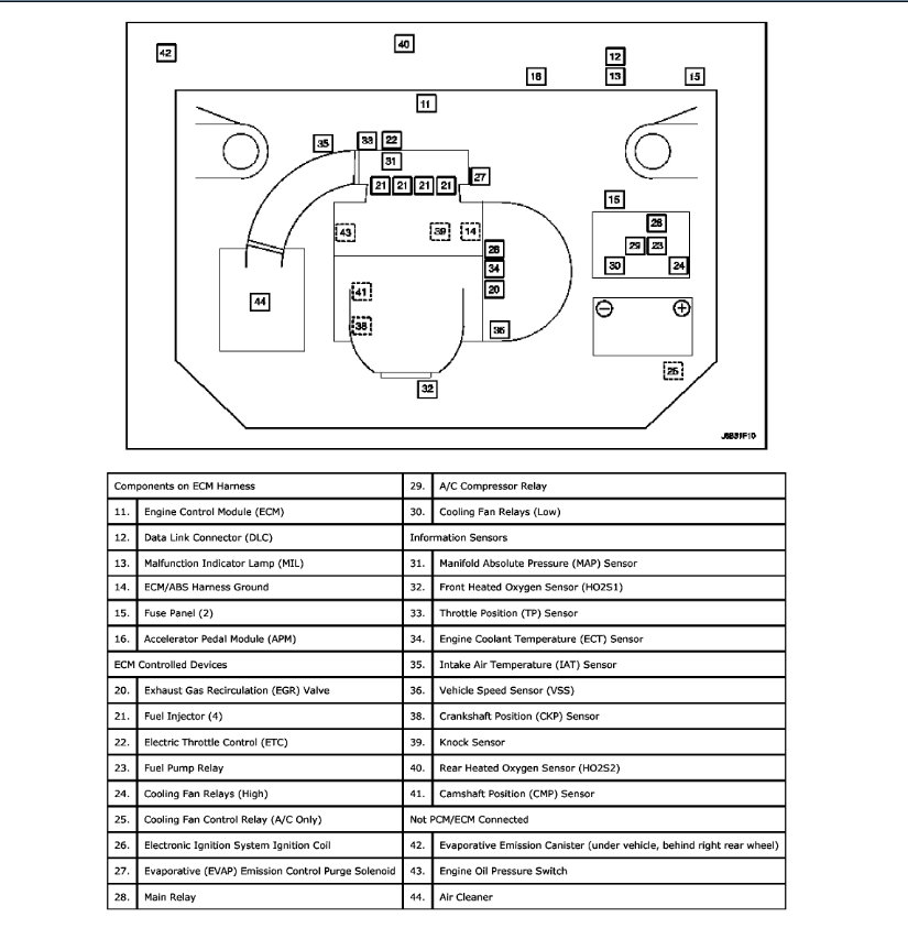

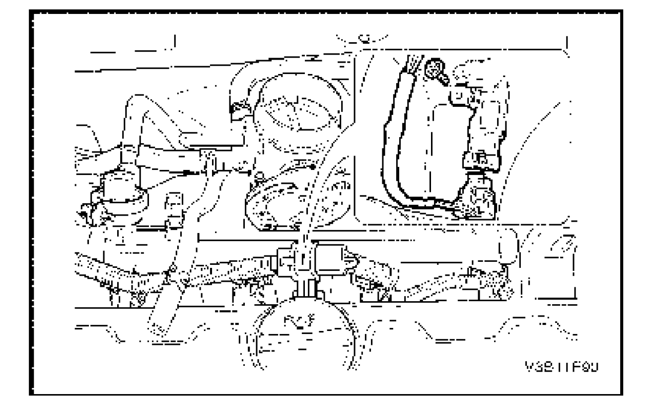

Need to replace MAP sensor, but can't locate it. Can't find diagram anywhere online.
Feb 8, 2020 at 9:50 PM
SCGRANTURISMO
  • 4,897 POSTS

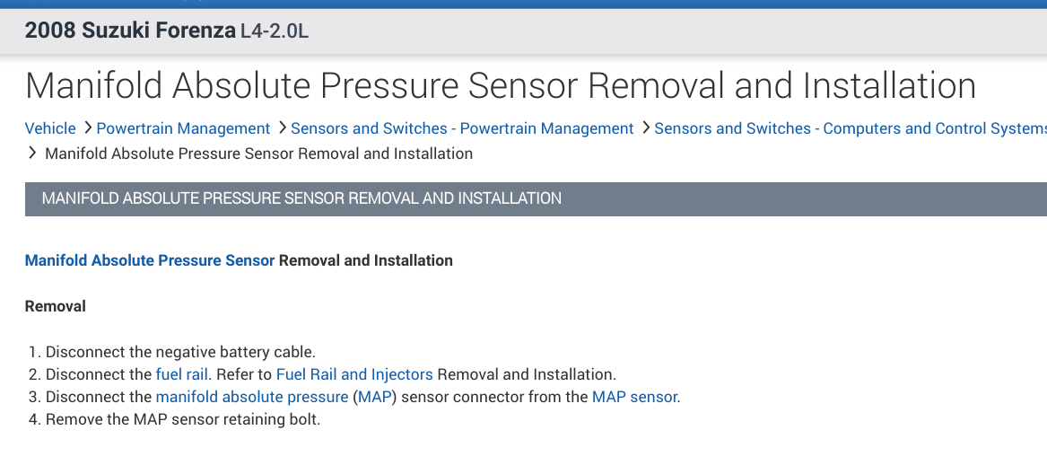

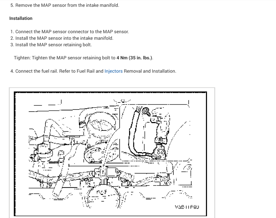

In the diagrams down below I have included the instructions for the removal and installation of the Manifold Absolute Pressure sensor [MAP] for your vehicle and the location of the Power-train Management sensors for your vehicle as well. Please go through these guides and get back to us with how everything turns out.
Thanks,
Alex
