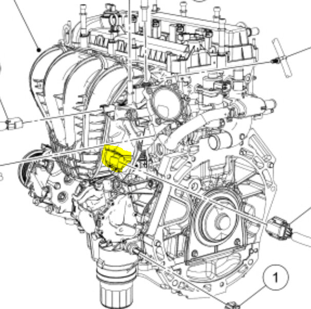

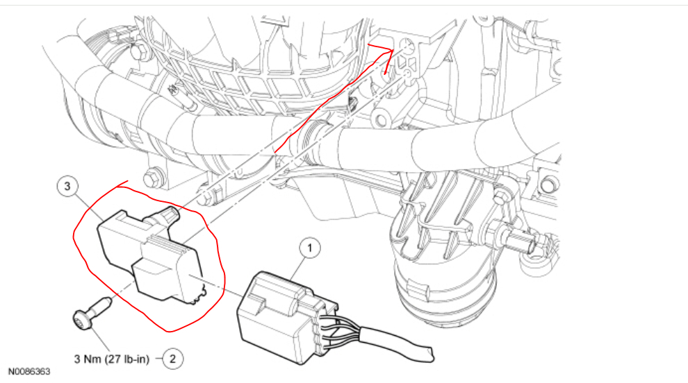

I need help locating the MAP sensor on my vehicle listed above hybrid. I know it should be by the intake manifold. But picture or exact diagram would really help. thank you
Jan 5, 2025 at 10:48 AM
  • 110,240 POSTS

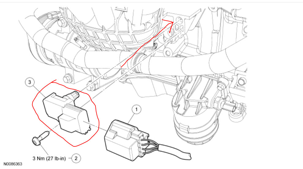

If I recall, you will need to remove the throttle body to access the mounting bolt. The bolt head will be a T25 (torx bit).
I attached two pics below. They were the best I could find. Take a look at them and let me know if you are able to locate the sensor.

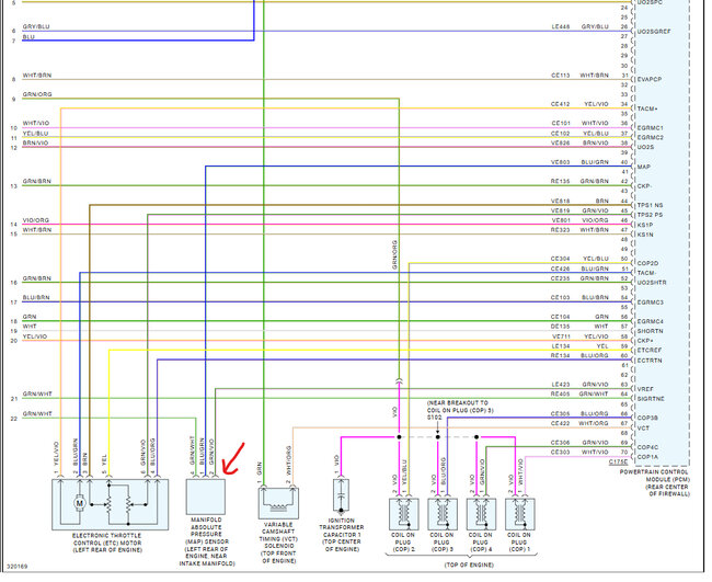

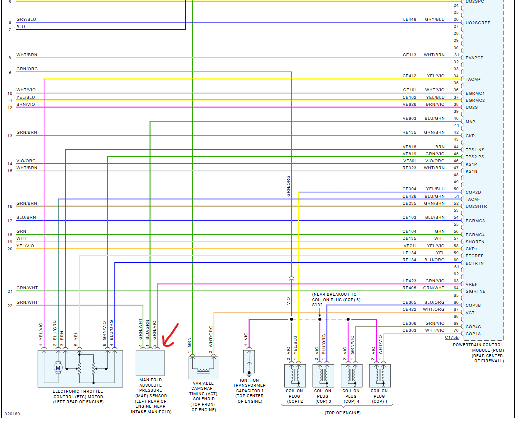

Thank you so much. The diagram really helped me a lot. I have another question if you don’t mind. The connector to MAP sensor has 4 wires I want to test. I am not sure which is hot wire or ground, or signal wire is there any identification by the color. Thank you for your help.
Jan 16, 2025 at 12:09 AM
  • 55,224 POSTS
The grn/wht wire is the 5 volt reference, the other two go to the PCM , here is the wiring daigrams for the MAP sensor so you can see how it works. Check out the images (below). Let us know if you need anything else.
