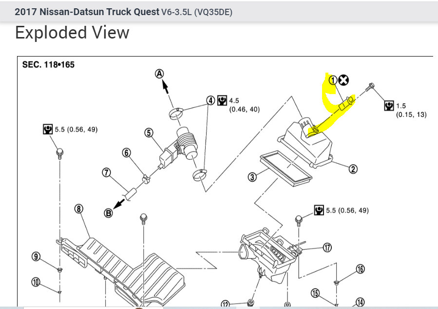

I can't find the map sensor it's not where I thought it would be.

On this vehicle, there is no MAP sensor. Instead, there is a mass air flow sensor (MAF). It is located at the air filter box.
I attached a pic below to help locate it.
Let me know if this helps and if I can help in any way.
joe
See pic below.
