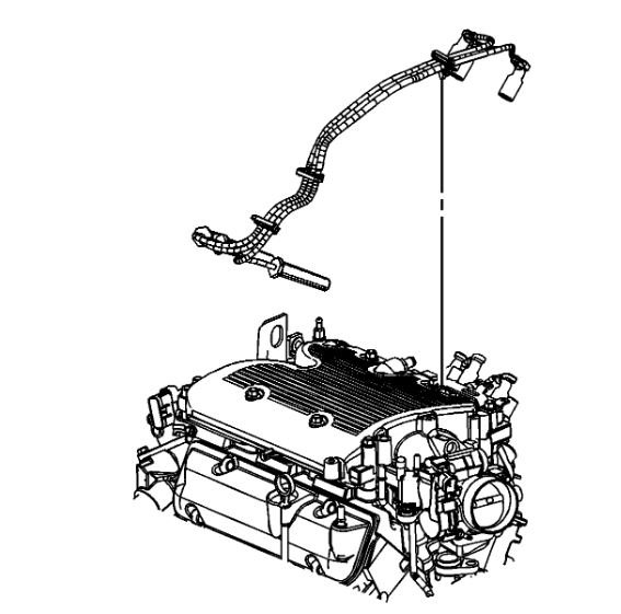

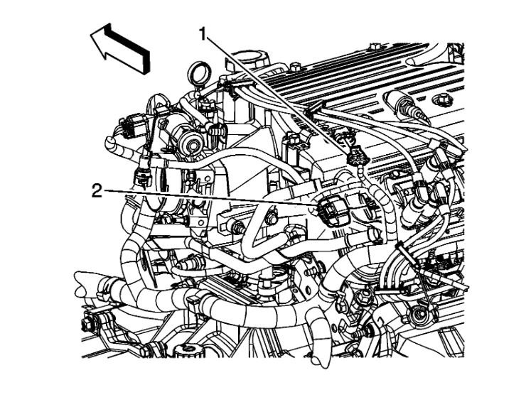

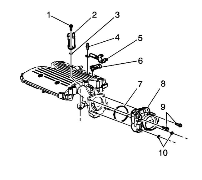

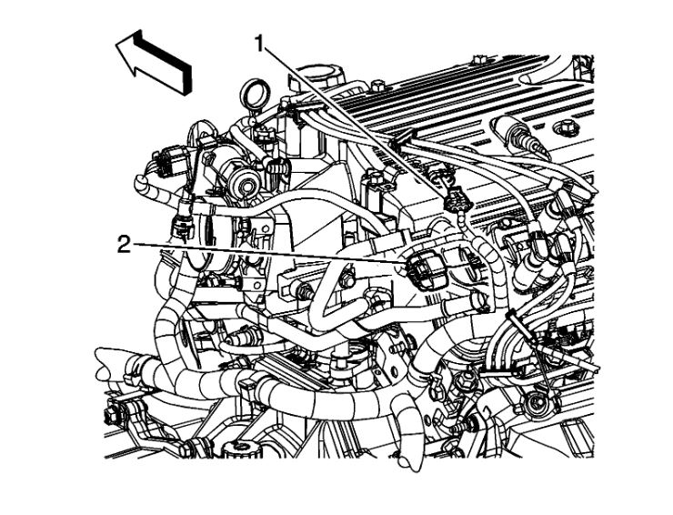

Good evening,
It is located on the back of the motor by the firewall. I attached the procedure and some pictures for you to view.
Removal Procedure
1. Remove the intake manifold cover.
2. Disconnect the engine wiring harness electrical connector (1) from the manifold absolute pressure (MAP) sensor.
3. Remove the spark plug wire clip from the MAP sensor bracket, if necessary.
4. Remove the upper intake manifold bolt.
5. Remove the MAP sensor bracket (5).
6. Remove the MAP sensor (6) and seal from the upper intake manifold. Discard the seal.
