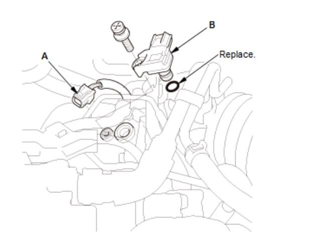

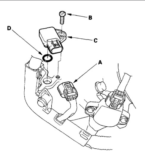

Hey guys, need help locating the MAP on my car. I can't seem to find it, could it be before the air filter?
Thanks in advance!
Dec 30, 2020 at 4:08 AM (Merged)

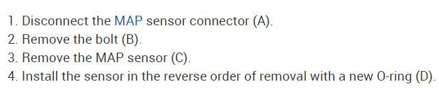

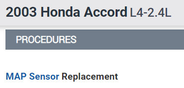

DANNY L
  • 5,648 POSTS
Hello, I'm Danny.
I've attached pictures below on how to replace the MAP sensor and included its location. Hope this helps and thanks for using 2CarPros.

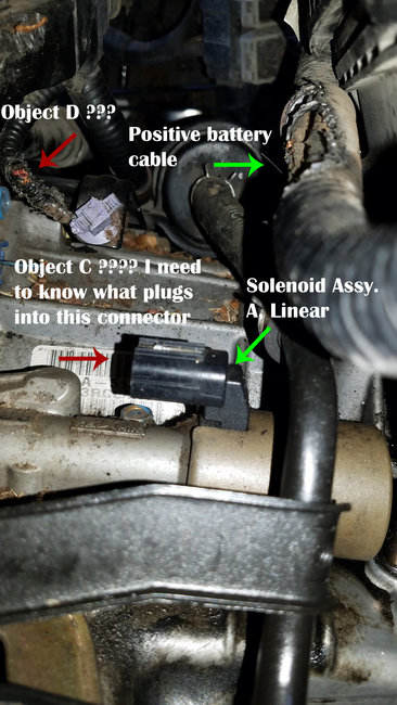

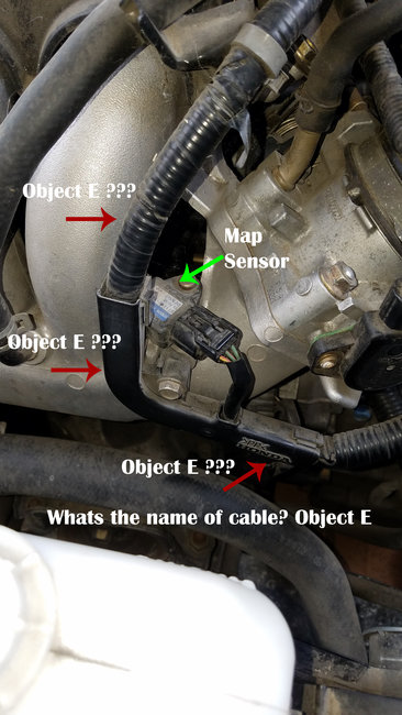

LILPD24

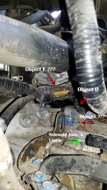

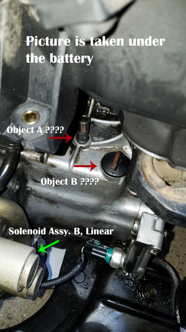

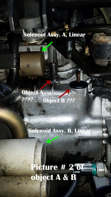

I'm having problems finding out the name of the harness that connects to the MAP sensor. I need to replace the whole harness because I had a rodent built a nest in my engine bay and made a snack out of a lot of wires/harness. : '( I don't have the money to pay a professional mechanic to fix the problems, so I plan on fixing all the wires that where damaged myself! I have pictures! If you can tell me the names of the objects It would help me greatly.
I have red arrows pointing to the objects (A-F) I need to replace. Anything would help and any information that's necessary of the objects.
If you can format something like this below. Thanks so much!
A)
B)
C)
D)
E)
F)
Dec 30, 2020 at 4:09 AM (Merged)
STEVE W.
  • 15,344 POSTS
Hello and welcome to 2CarPros. Aren't critters fun. With the damage you have found you would probably be better off getting the entire front engine harness assembly from a salvage yard. You could cut and splice all the damage but that is a lot of work that could be avoided by just replacing the entire harness. Plus there is likely other damage you have not discovered yet as there are harnesses that run underneath the intake and more.

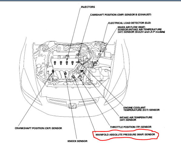

  • 75,992 POSTS
Check the MAP and throttle position sensor-might be wise to check also the fuel pressure with a gauge here is the MAP sensor location. Check out the diagrams (Below). Please let us know if you need anything else to get the problem fixed.
Dec 30, 2020 at 4:10 AM (Merged)

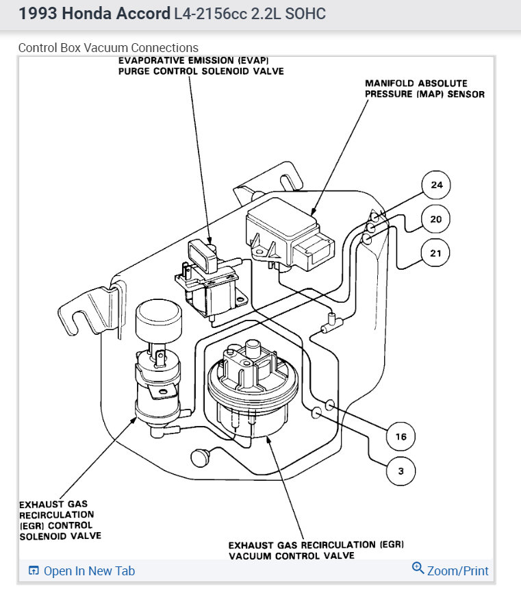

ROBYNWILLETTE
1990 Honda Accord 4 cyl Two Wheel Drive Manual
I need to replace my map sensor and I don't know where to find it's location
BLUELIGHTNIN6
  • 16,542 POSTS
MAP sensor is located in conrtol box at right rear corner of engine compartment, pictured below..
