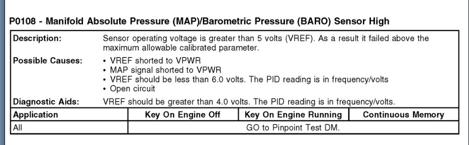

Code 0108 map sensor
2006 LINCOLN TOWN CAR
111,245 MILES
JSSTRINGER

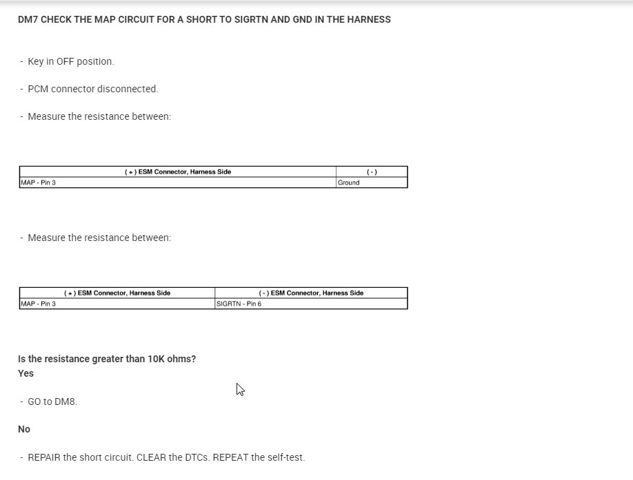

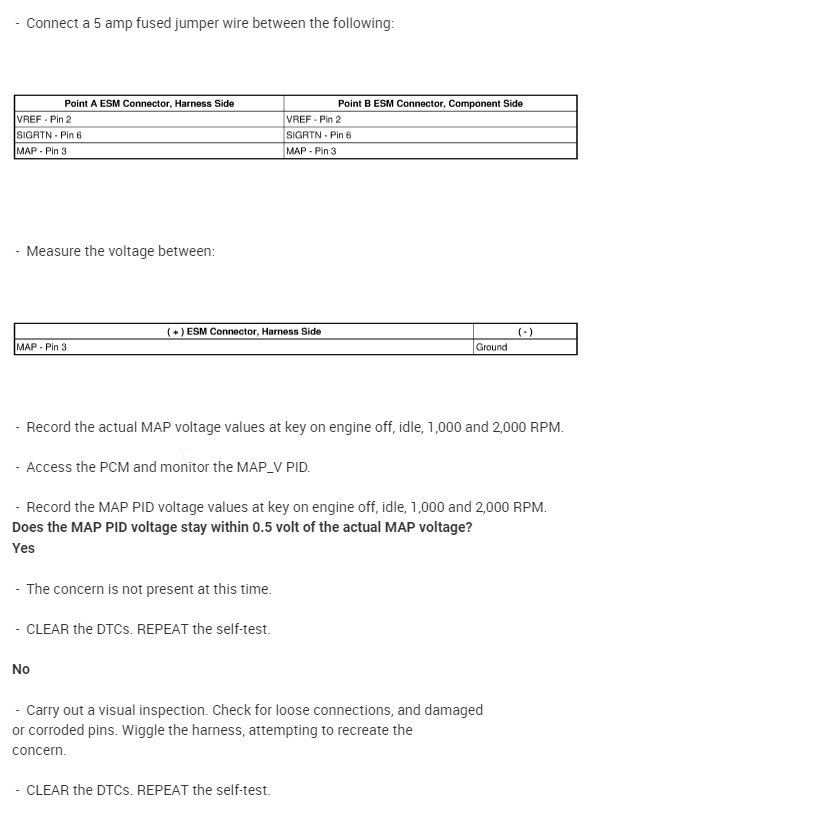

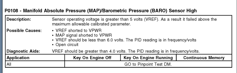

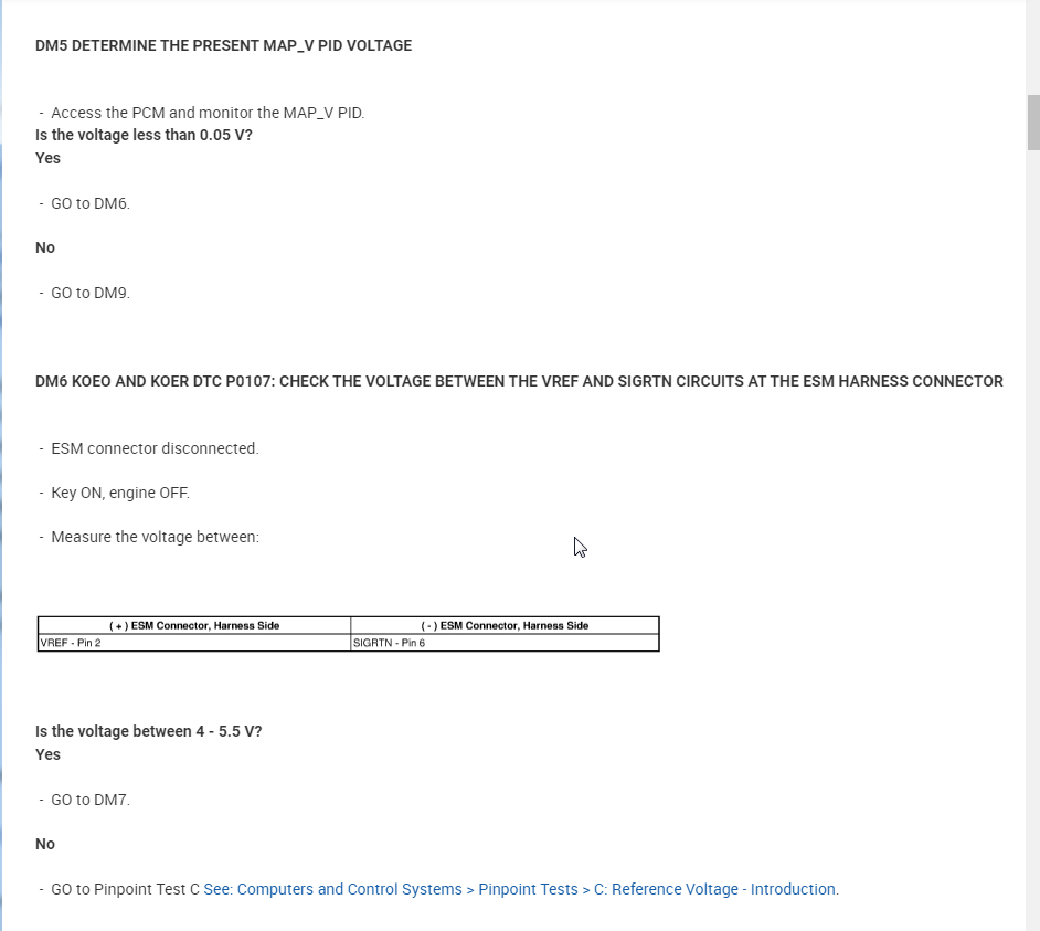

failed emissions with 0108 code.
Jun 4, 2020 at 3:42 AM

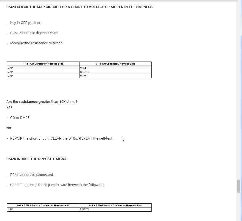

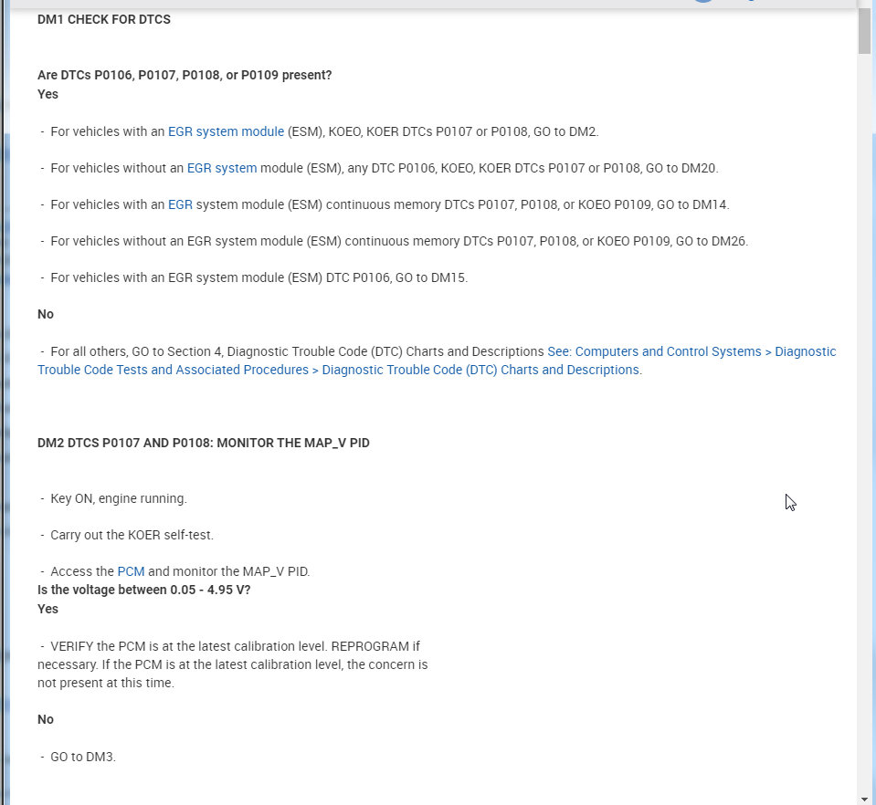

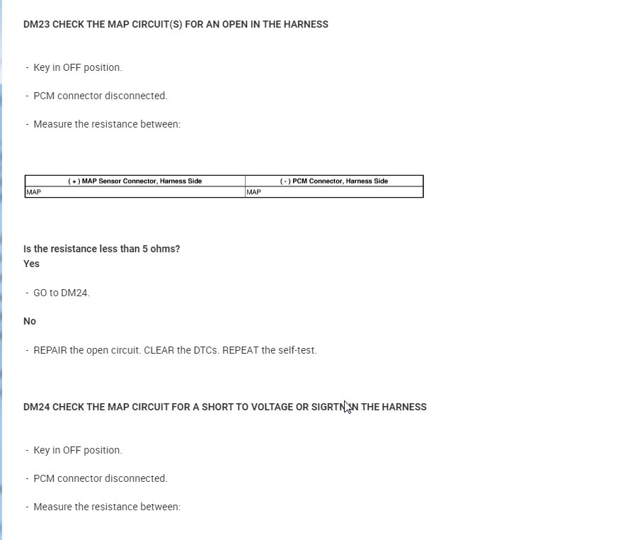

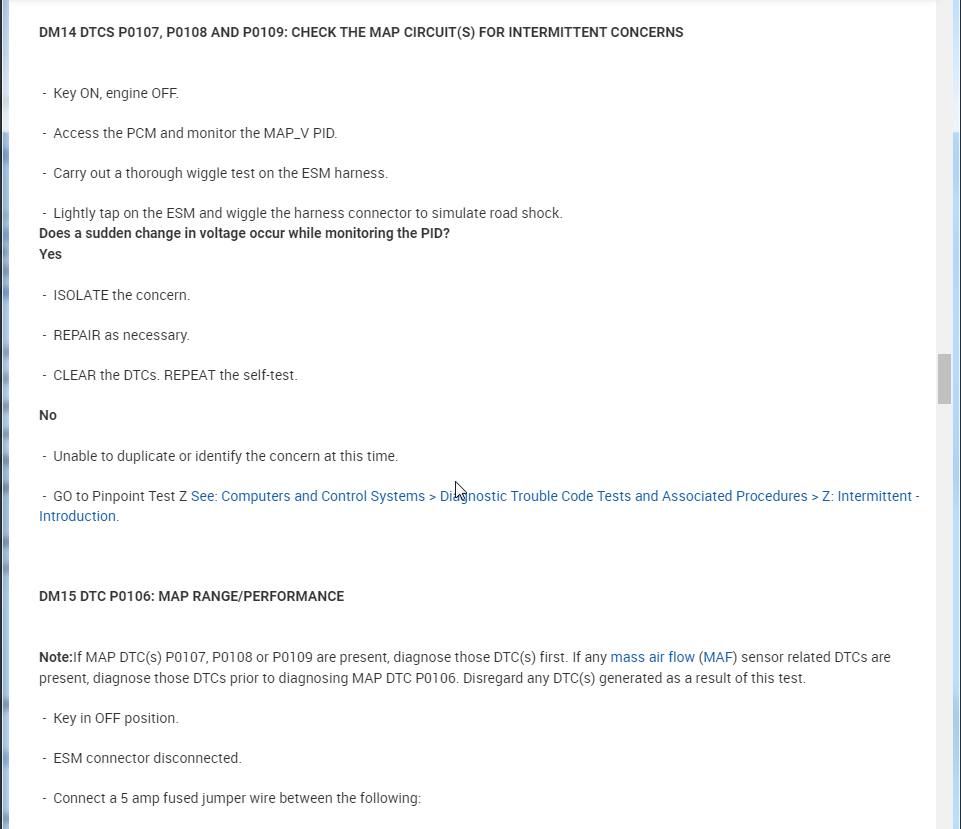

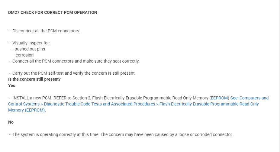

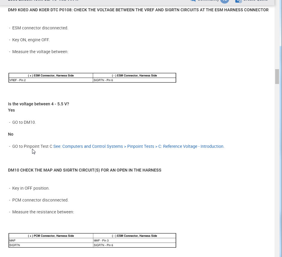

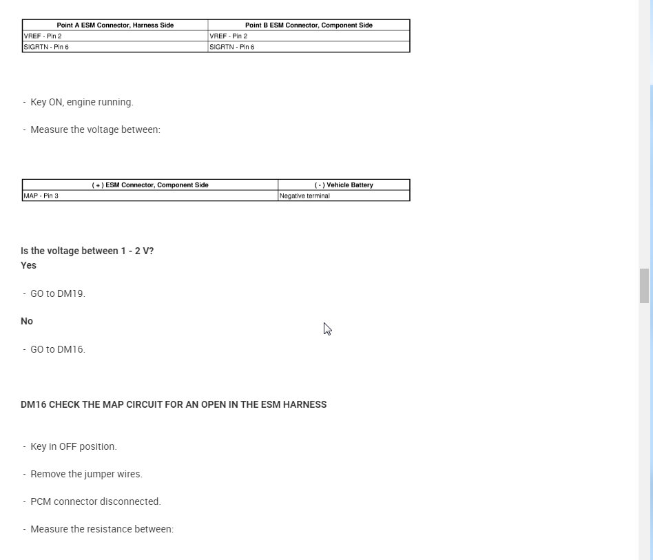

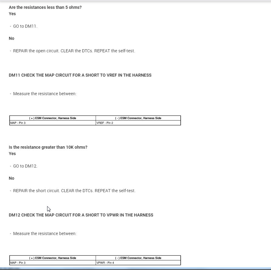

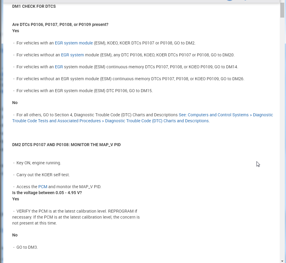

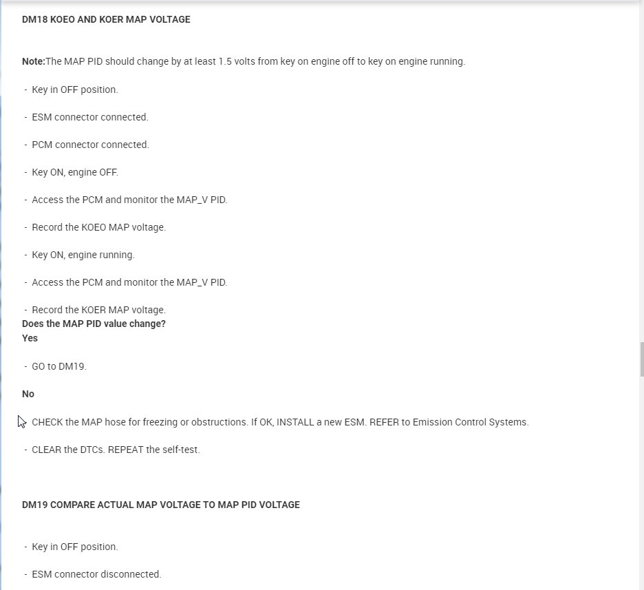

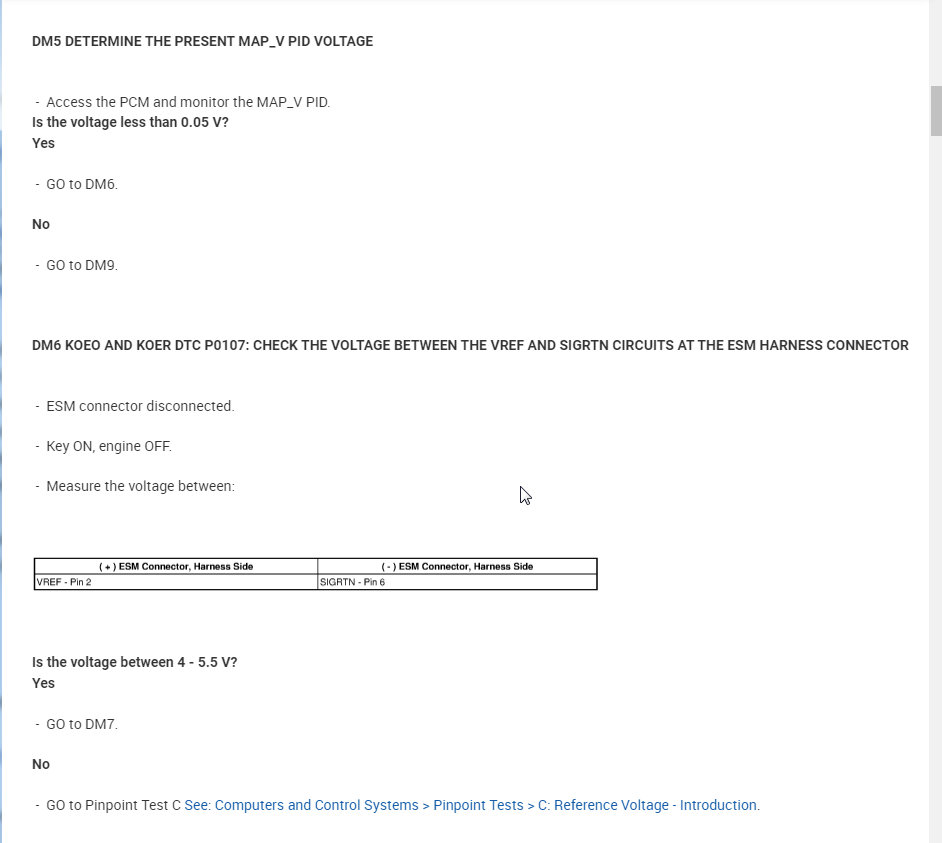

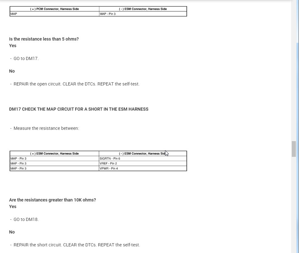

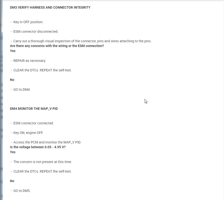

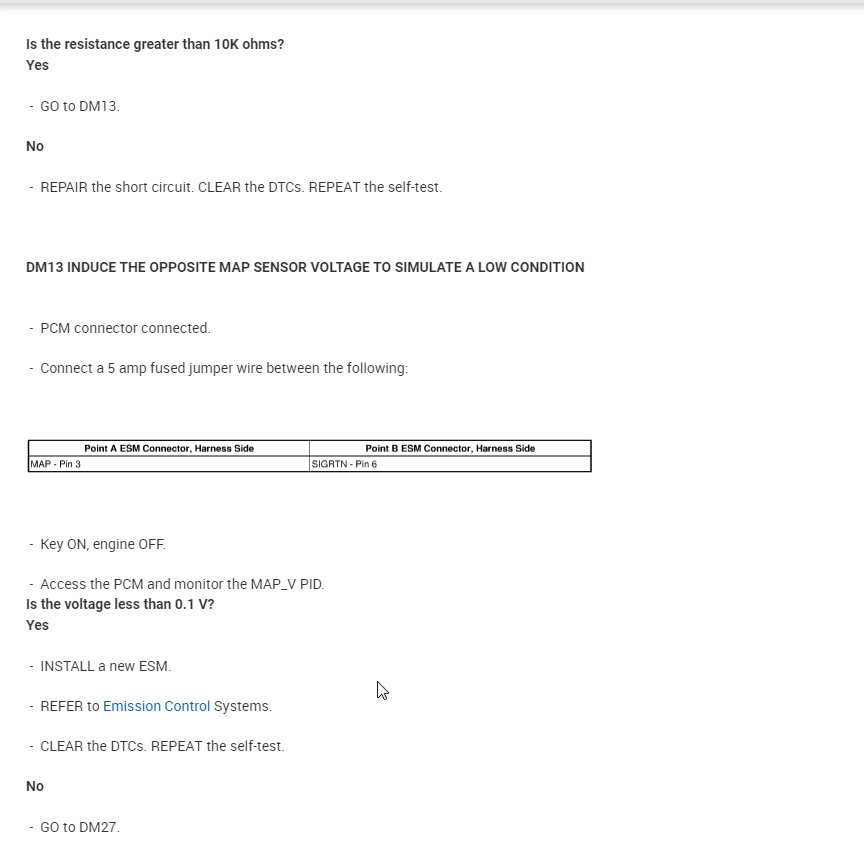

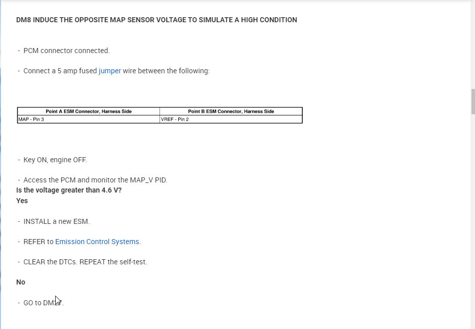

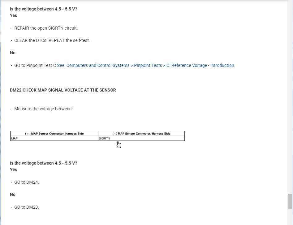

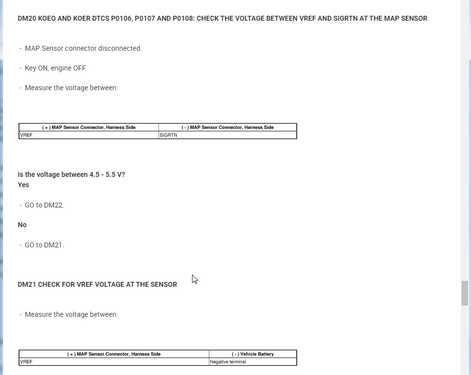

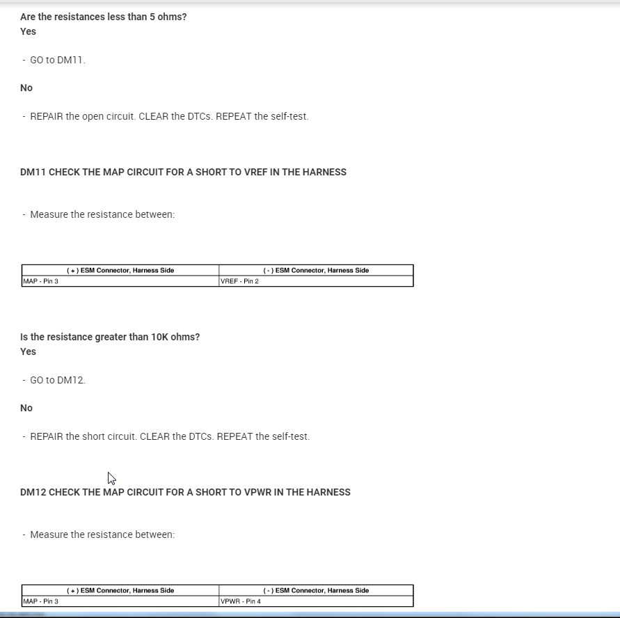

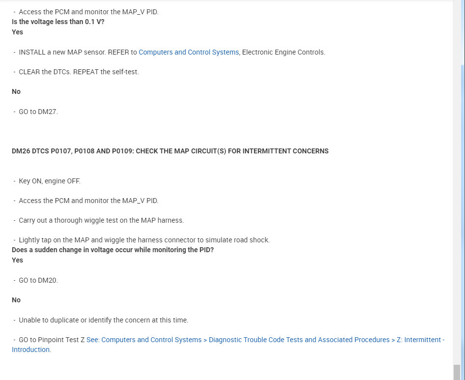

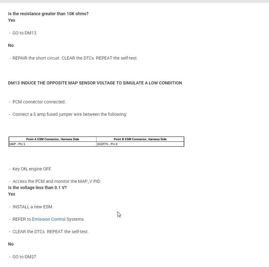

I attached the testing for this code that you need to follow in order to determine what the issue is. Unfortunately you will need a scan tool capable of performing some of the testing. Let me know if you have questions as you work through this.
Unfortunately, I can't just tell you what part to replace. This could the MAP sensor but it could also be wiring or the PCM.
Let me know if you have questions about this but again, the only way to know for sure what part we need is to perform this diag.

So I just realized with that question that your vehicle does not have an actual MAP sensor. It uses a MAF or mass air flow sensor to determine how much air is coming into the engine and then it calculates the manifold pressure. Because of that, this code is most likely pointing to one of three things. First a vacuum leak. Next a MAF issue or EGR issue.
I would suggest running through this guide and test for a vacuum leak and go from there.
