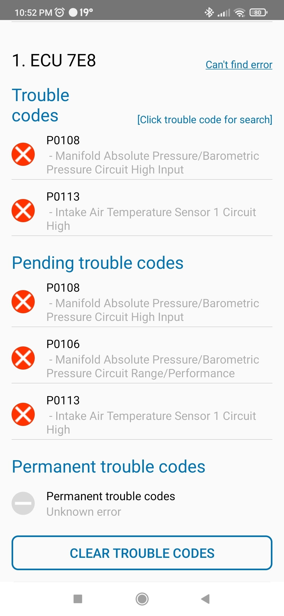

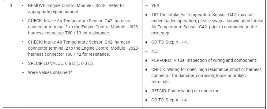

Check light randomly comes on. OBD Scan Tool found the following errors:
P0106, P0108, P0113
These are related to Intake Air Temperature Sensor and Manifold Absolute Pressure sensor
I need help for finding the exact part number and location of the two sensors.

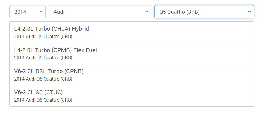

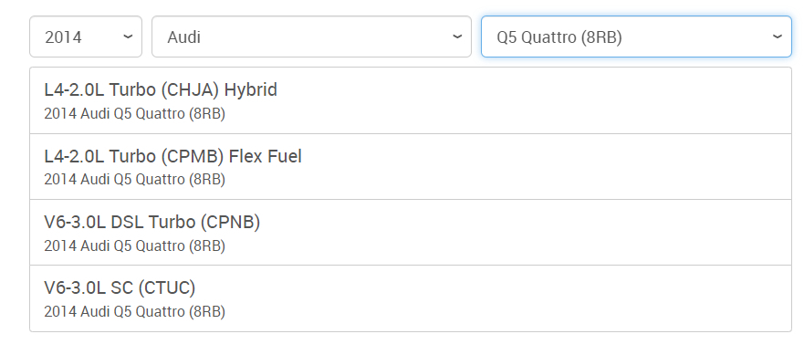

I'm not sure why, but I am only showing the engine options below. Are you located in the US? Sometimes they are different when produced for a different country.
I tried to look up the codes for the CPMB flex fuel vehicle, but most of the codes you have aren't listed.
See pic below.

This is made in Germany and I'm in Australia. The image from obd scan tool is attached. I can see the codes listed on ross-tech wiki. I cannot the location, quantity, or part number for the MAP and IAT sensors.

I would be happy to provide any information from the manual I have, but I'm not sure if the engine code will make a difference. They can.
If you want, let me know which one you feel is similar to your vehicle. Is it the flex-fuel or the hybrid?

Flex fuel is petrol that has a higher amount of ethanol. They sell it here in the US. It's less expensive, but you get less MPG. LOL
Since it isn't a hybrid, I went with the flex fuel.

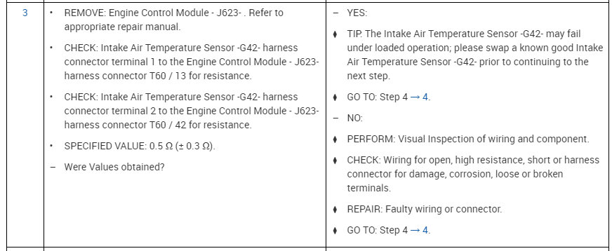

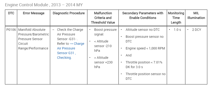

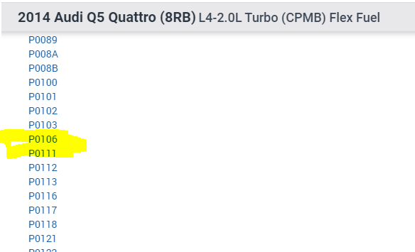

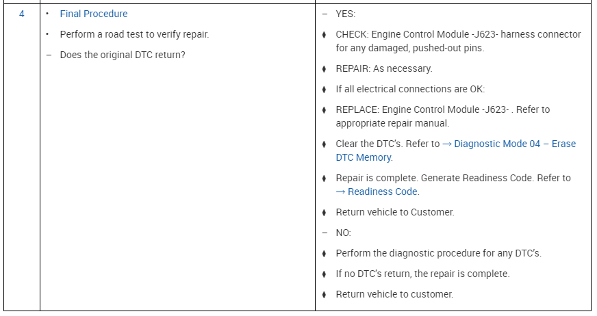

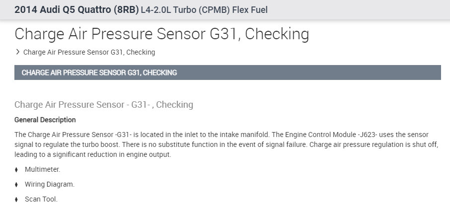

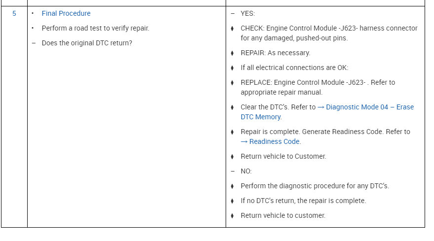

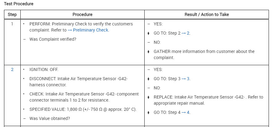

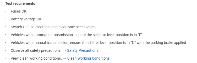

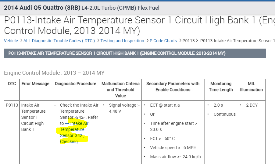

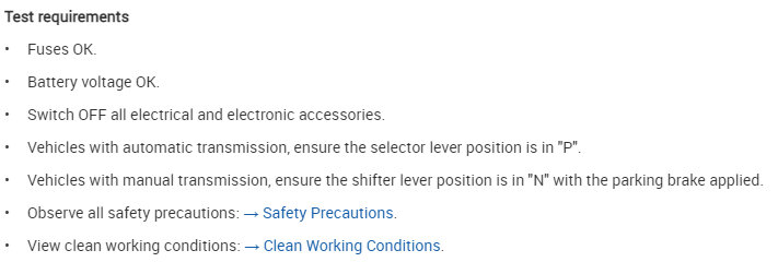

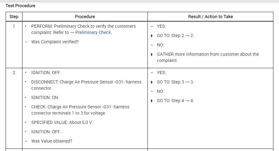

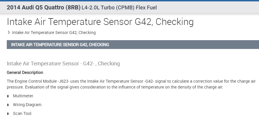

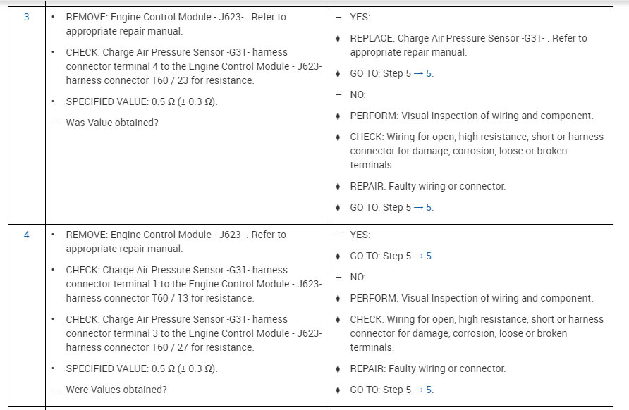

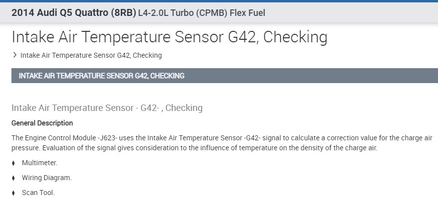

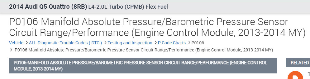

Pics 1-7 are for the P0106. Note, pic 2 indicates checking the charge air pressure sensor. Pics 3 to 7 are the procedure.
P0108 doesn't exist for this vehicle. See pic 8
The remaining pics are for the P0113. It is set up the same way as the P0106.
Let me know if this helps.
