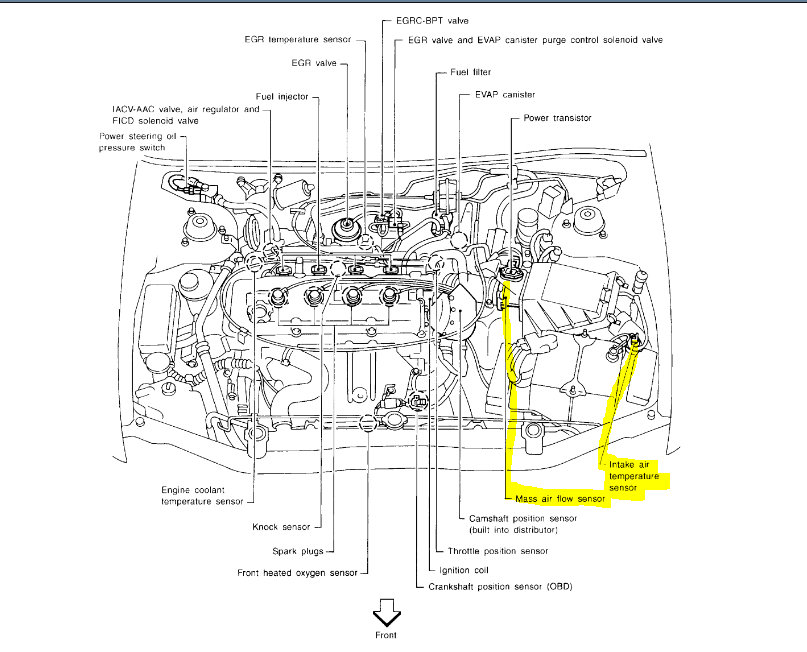

Where the MAP sensor on the car listed above can't locate it?

Your vehicle doesn't have a Manifold Absolute Pressure [MAP] sensor, it has a Mass Airflow [MAF] sensor and an Intake Air Temperature [IAT] sensor, that work in conjunction and provide a more accurate reading to the Power-train Control Module [PCM] then a MAP sensor. In the diagrams down below I have included a diagram of your vehicle and where all the EFI sensors are located. I hope this helps. Please get back to us with how everything turns out.
