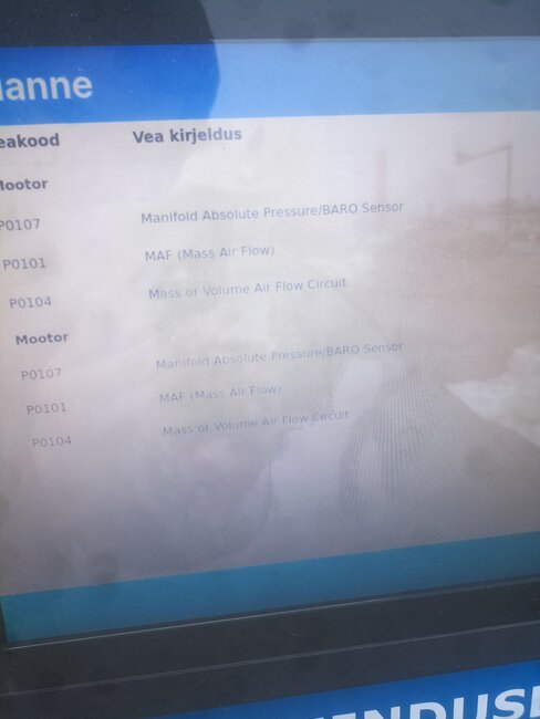

One day the engine warning light came up, and the car lost its power.
Diagnostics showed MAP and MAF sensor faulty.
Fault codes.
P0107
P0104
P0101.
Changed both. MAP and MAF sensors, but the problem was still same.
Also checked the wiring and everything is okay.
Can you tell what can cause the problem?

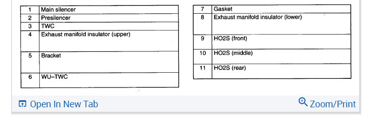

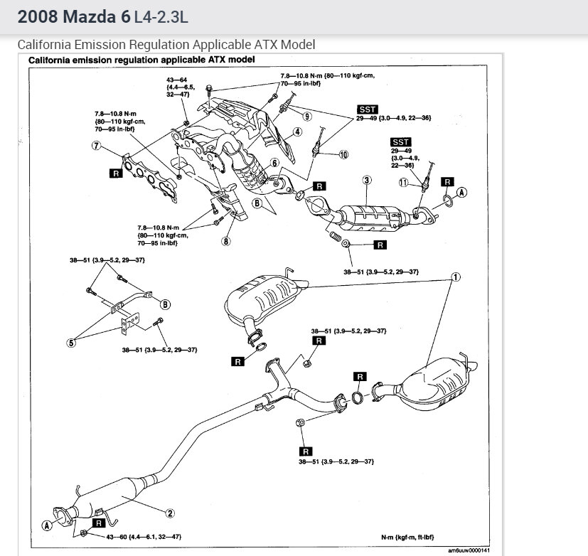

This happens when the catalytic converter gets clogged up, the air filter is plugged, or there is a massive vacuum leak. Here is a guide to help check the converter and for a vacuum leak I have included instructions to check your air filter as well:
And use this test when the engine is cold only:
Please check out the images below and get back to me.

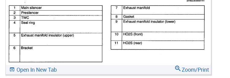

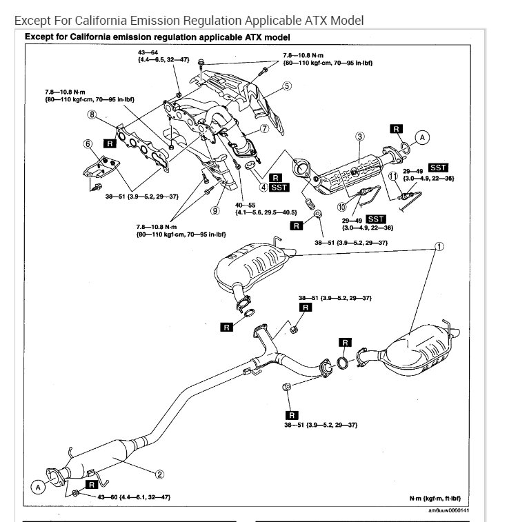

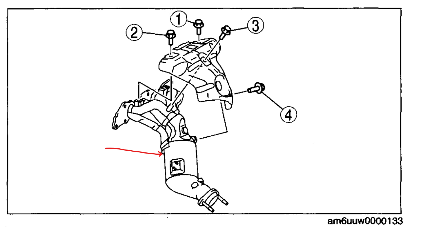

Yep, it does seem like a mechanical error like a clogged exhaust system. I would undo the exhaust at the catalytic converter to see if the power comes back. It will be a little loud FYI. You may need to take the exhaust manifold off to inspect it.
Feb 17, 2023 at 3:56 AM

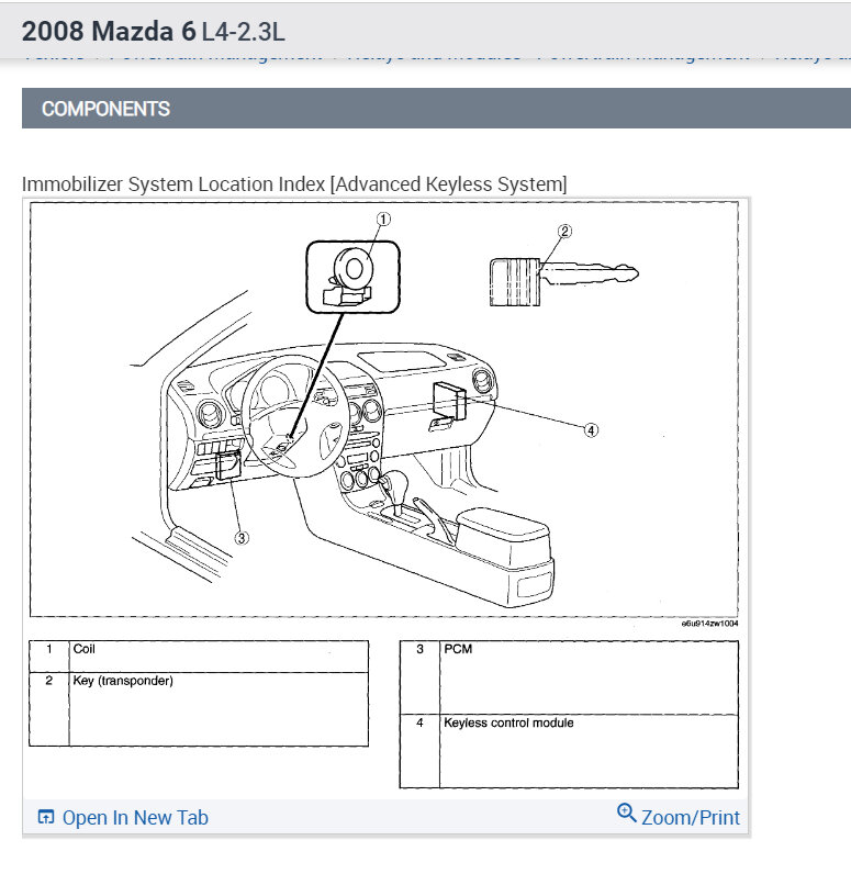

This sounds like a bad PCM, but can I ask if the scan that was done is a CAN scan? This might tell us more before replacing the PCM. You can get a CAN scanner (Controller Area Network) from Amazon.
https://youtu.be/u-4syLc-ifQ
and

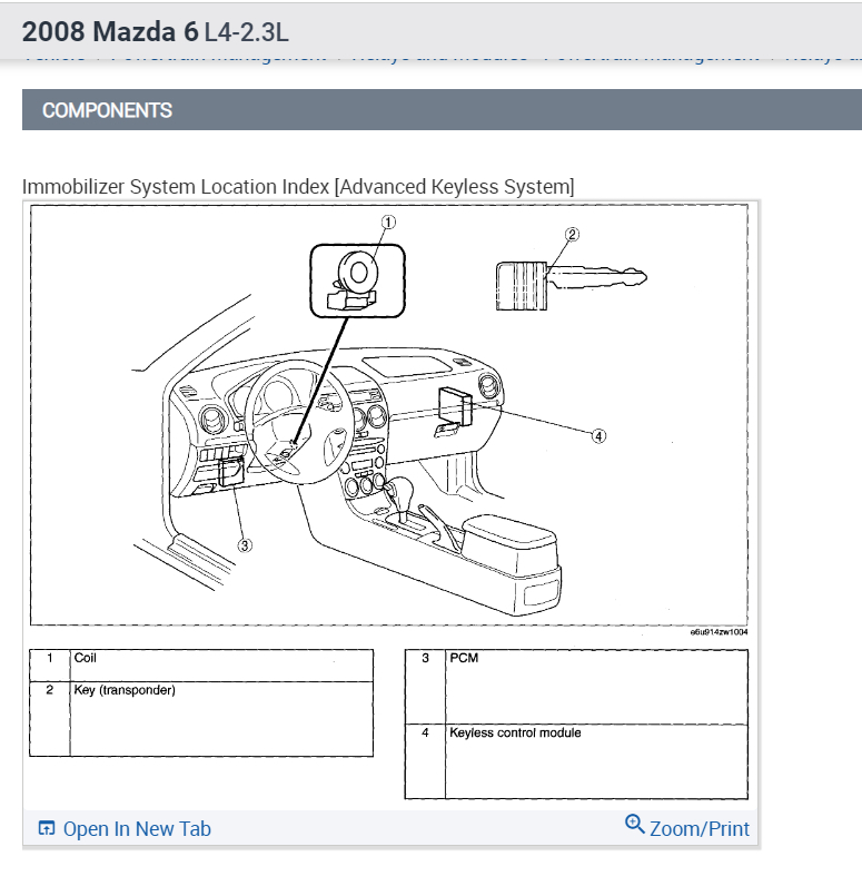

Here is how to change the PCM out in the images below, you can get a preprogrammed unit by searching Google or Ebay. Let me know please.

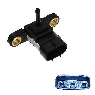

What i meant about codes is that every detail on car have code.
If i want to buy a new sensor, then i have to have code.
For example.Picture i added in here is MAP sensor for mazda.Diagnostics showed that its faulty.but i lost the original sensor on my car,i replaced it with new one but the sensors code didnt match.how can i buy new one,does VIN code gives me right sensor that fits?
Hope you understand what i meant.

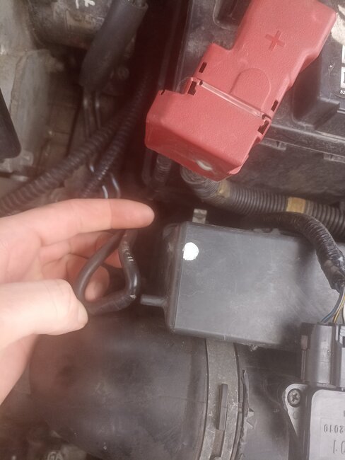

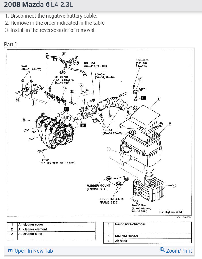

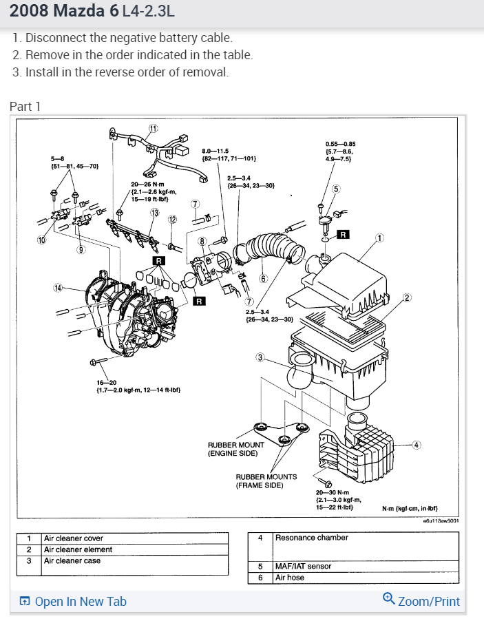

Second thing is that in picture , this is airfilter box,as you can see,one of the plastic connector is broken so these two hoses are just connected with tape.Can it cause problem with MAF or MAP sensor and do you have some sort of picture inside of the connectors?
Feb 25, 2023 at 10:37 PM
  • 55,214 POSTS
Yes, that can cause an issue, it looks like one of the hoses should go onto the air filter box. Can you see where the other one goes, is it broken? Can you upload more pictures?

Hey.
I changed the air filter box, attached these hoses where they should be, and still nothing.

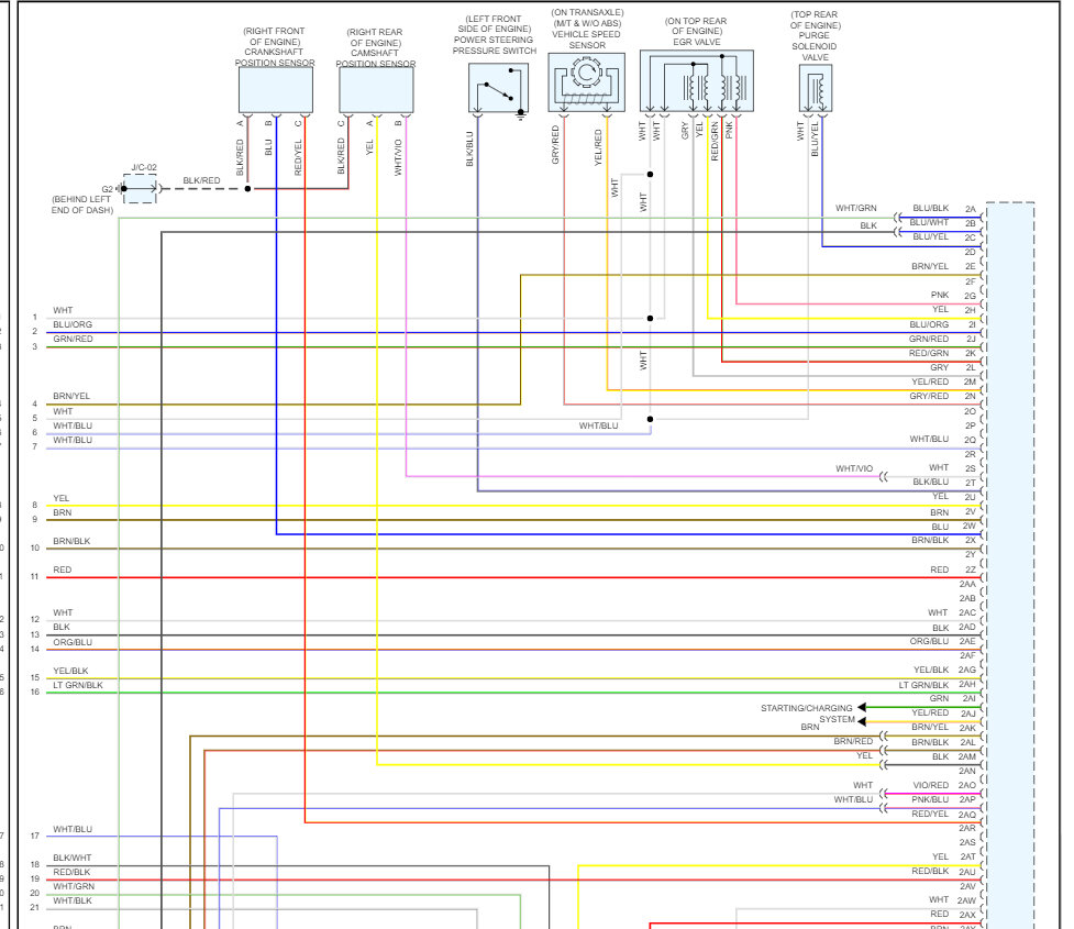

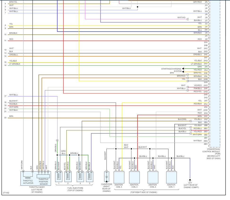

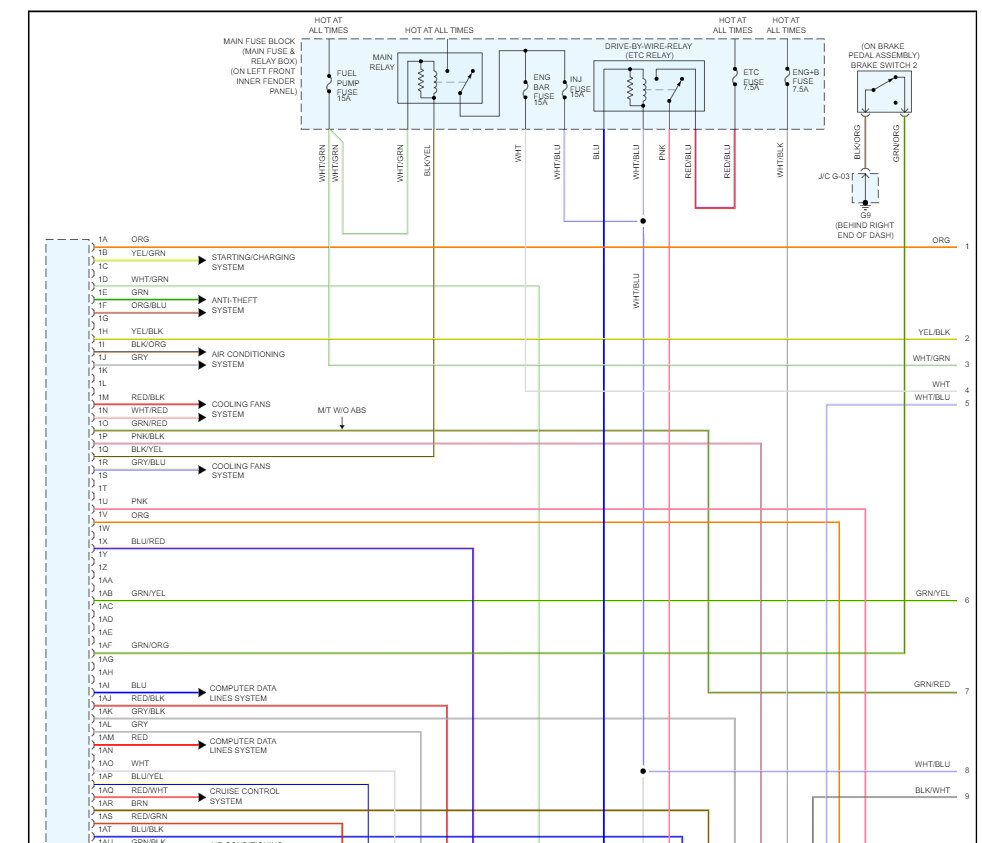

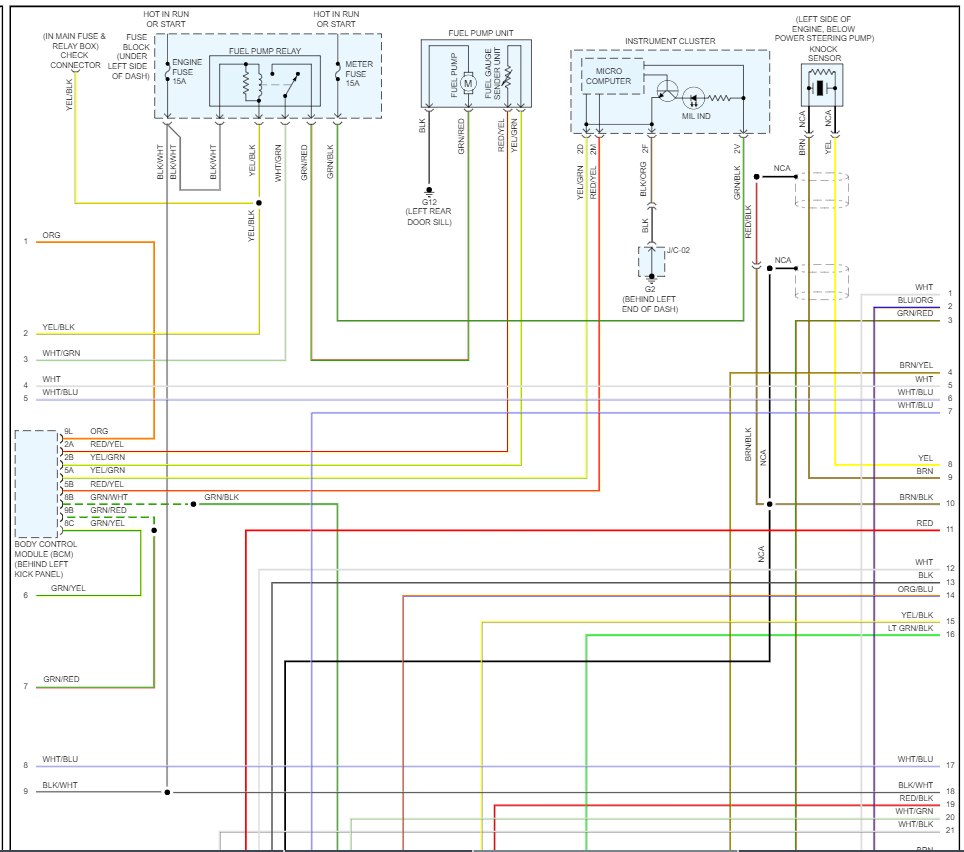

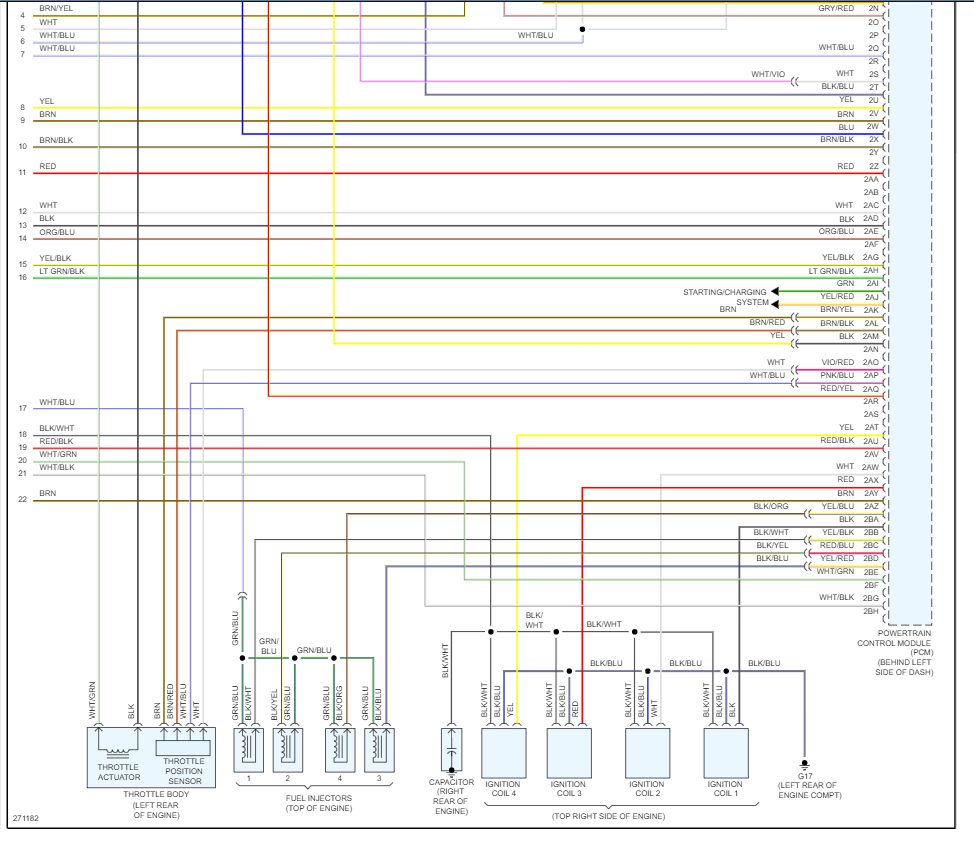

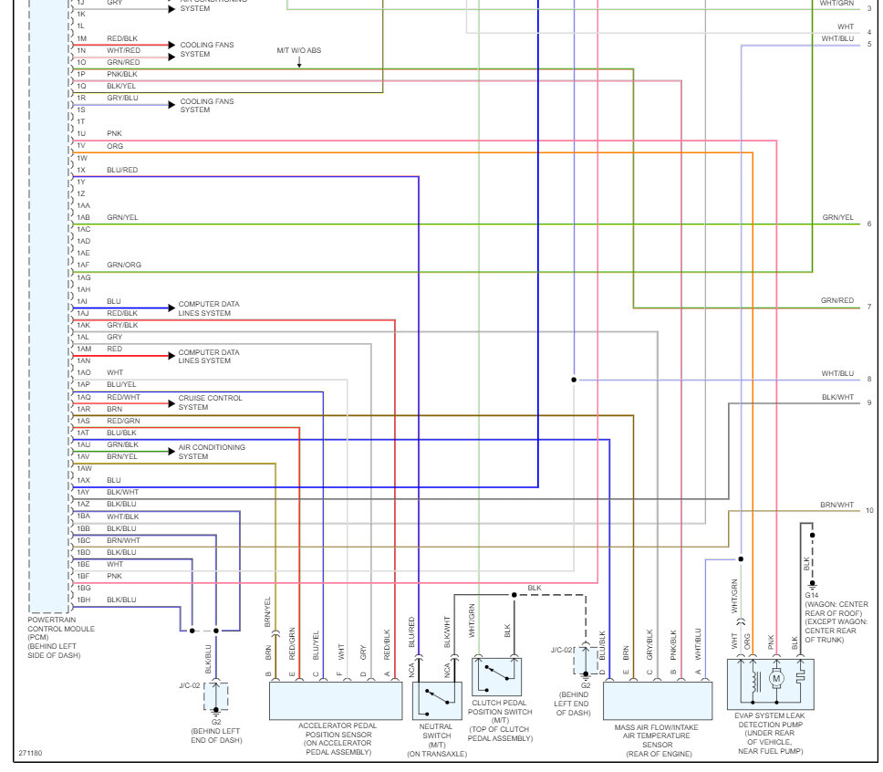

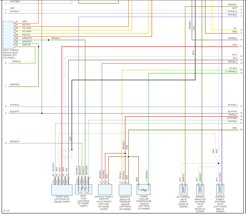

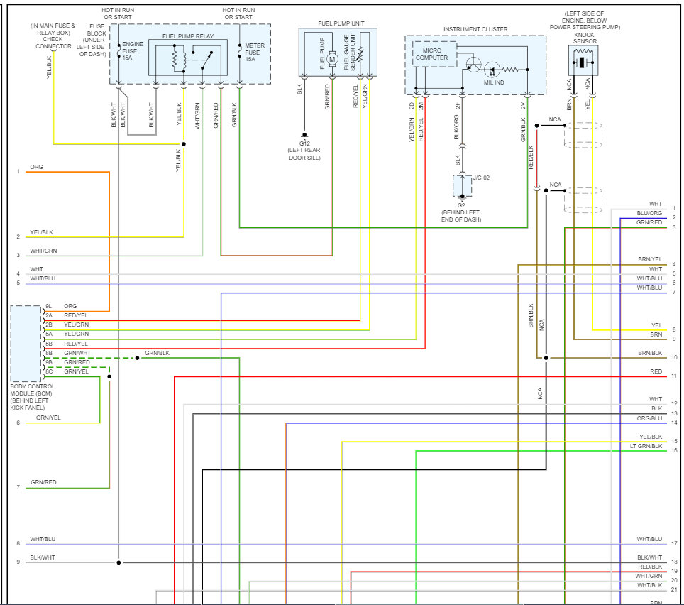

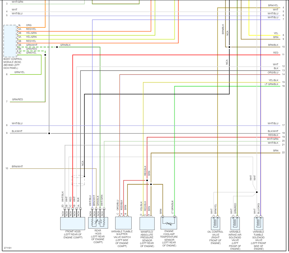

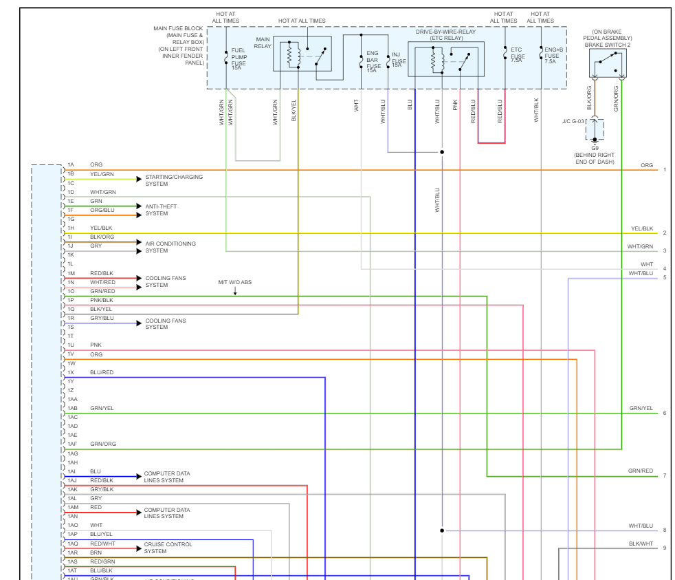

Okay, let's check the wires to the sensors, here is a guide that will help you and if the connections are good replace the PCM:
Here are the engine wiring diagrams so you can check it out. Check out the images (below). Please let us know what happens.
Mar 20, 2023 at 4:41 AM
TONI KUKKE
  • 20 POSTS
I have checked all wiring,everything is okay. Power comes to the sockets.
