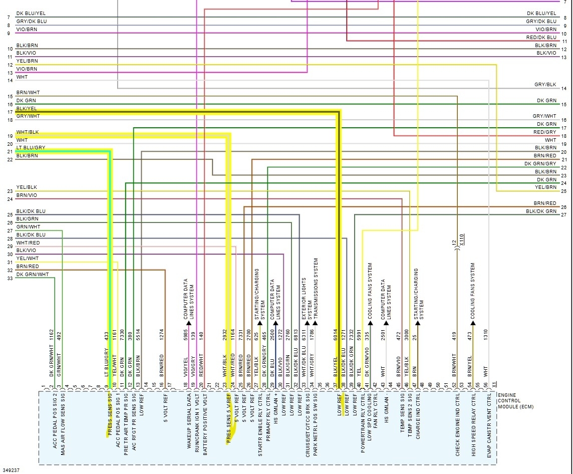

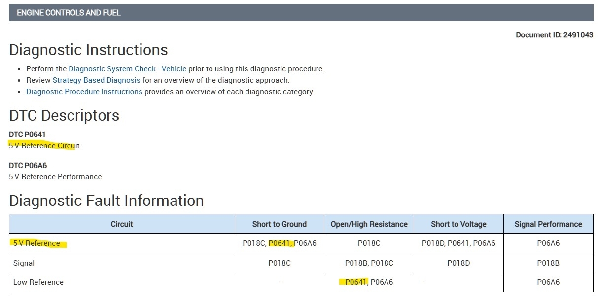

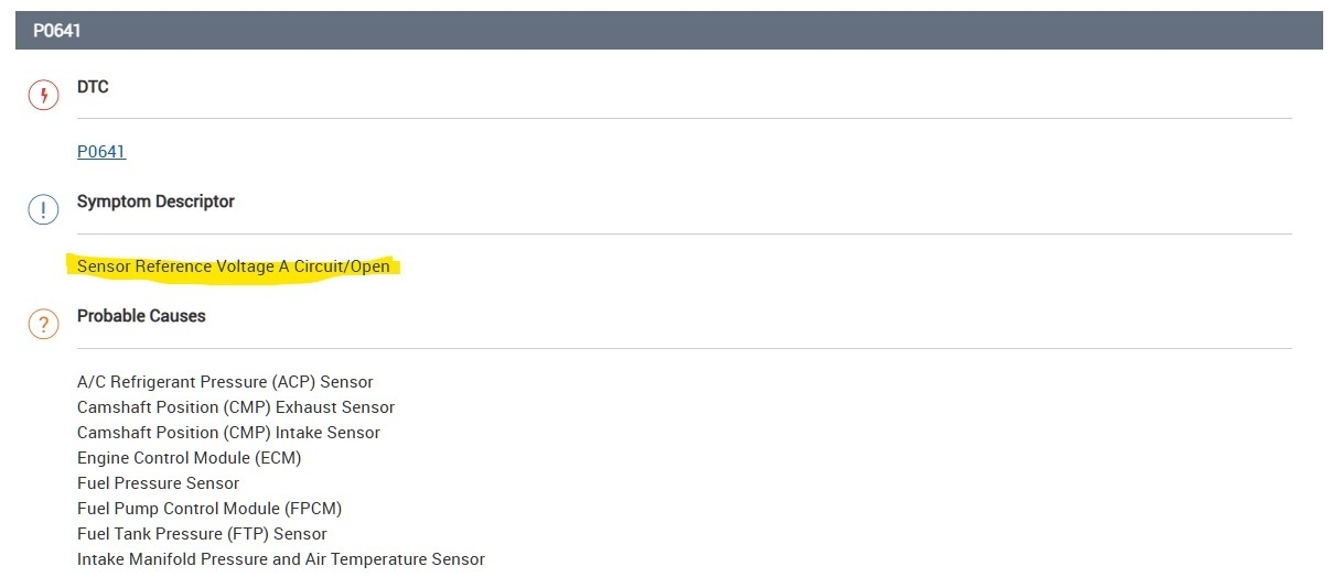

I had a generic thermostat put in 2011 Chevy Cruz 1.4, now after install, engine light codes: came on P0641(MAP) and P2227(Barometer). Do I need to put in a genuine GM Thermostat part to get rid of these codes? or the generic has nothing to do with these new codes. Thanx

AL514

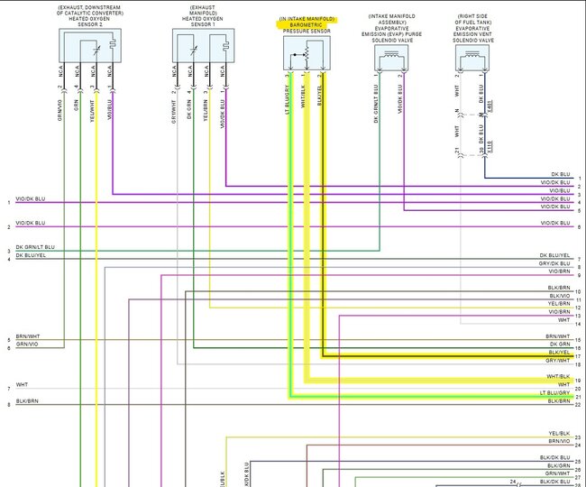

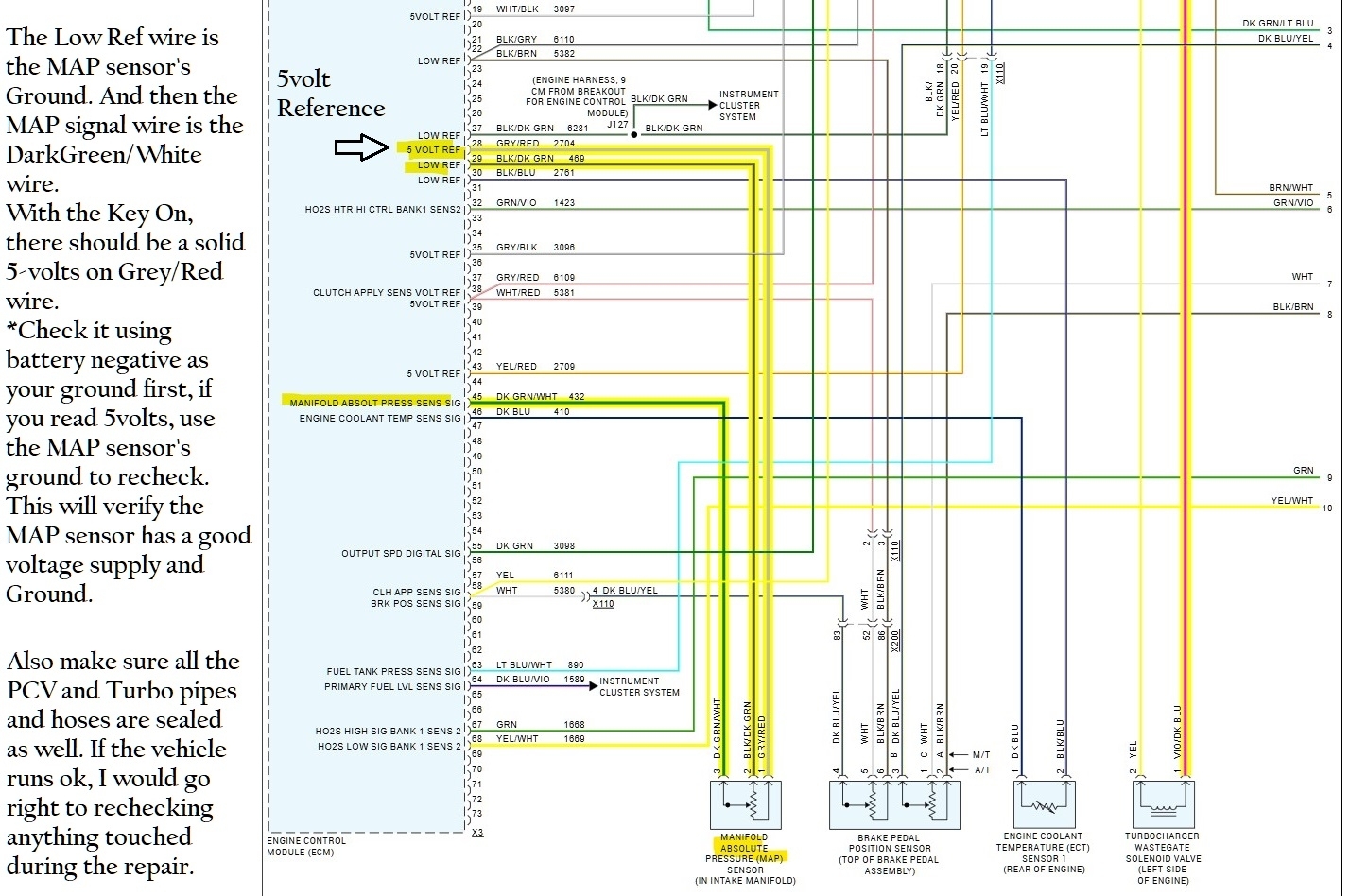

Hello, I would retrace your steps if you did the thermostat replacement, the codes setting (P0641) is actually a code for the 5-volt reference voltage of the MAP sensor, this and the other code for the Barometric pressure sensor are related. The ECM will either have a Baro sensor built right into the computer, or the ECM takes a reading of the atmospheric pressure using the MAP sensor at just Key On, before the engine starts. The code with the Baro sensor is "Barometric Pressure Sensor Circuit Low Voltage", so a missing, shorted, or low 5-volt reference which the MAP sensor uses (one of the 3 wires on the MAP sensor). The other two wires are Ground and Signal wires. Im am thinking the connector may just not be seated correctly, because no other sensors are setting a reference voltage code. I will post the wiring diagram so you can find the MAP sensor to check its connector. But I would go through and recheck anything you touched first, it would be great if this is just a loose connection. Remember that the pins inside connectors can spread, creating a poor or no contact.

AL514
  • 5,656 POSTS

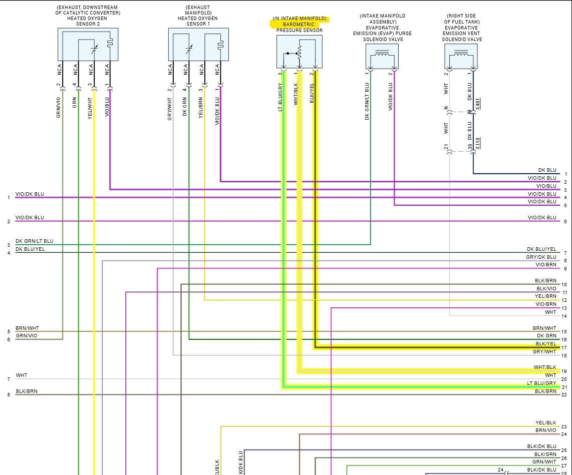

Here are the wiring diagrams for the MAP sensor, and Baro. Service info has the vehicle listed with two different sensors, but in many cases the Baro reading is taken from the MAP sensor before the engine is started. But I posted the wiring diagrams for both, if they actually do have two sensors. Why was the thermostat replaced if I can ask? Was it setting any codes? Because it does have a heater circuit it looks like, which is a much more modern design than people are used to seeing.
You can also go into the live data of the engine computer with a scan tool and see what the MAP is reading under global/basic OBD2 data, because some manufacturers will put in a substituted value in scan data and it can be misleading. And please let us know what you find.

As long as there are no codes for it or overheating issues, it sounds like the thermostat is ok. I know the oem factory ones are really expensive. Sometimes you need to go with an aftermarket part and hope for the best, but I think the 2nd issue is related to the repair in some manner. It looks like, in service info you need to get some PCV hoses out of the way and possibly some others. Along with moving other components or the wiring harness around. Thats why retracing your steps and the area you were working in is important.
