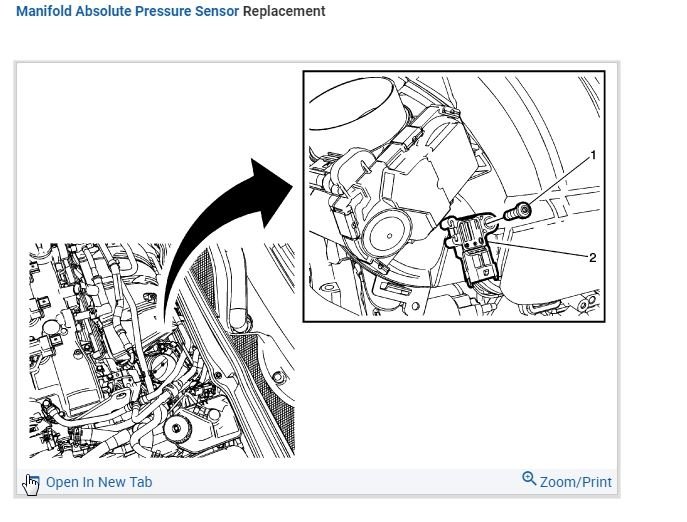

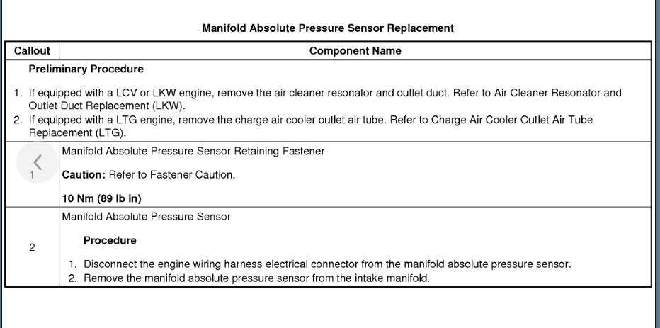

Where is the MAP sensor located?
Jun 20, 2019 at 6:28 AM
Hi Earl,
I attached the location and procedure on how to replace it. Let me now if you need anything else. Thanks

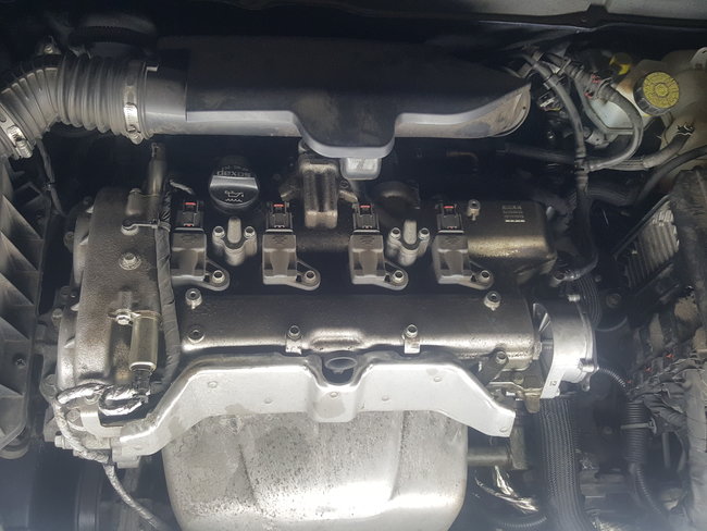

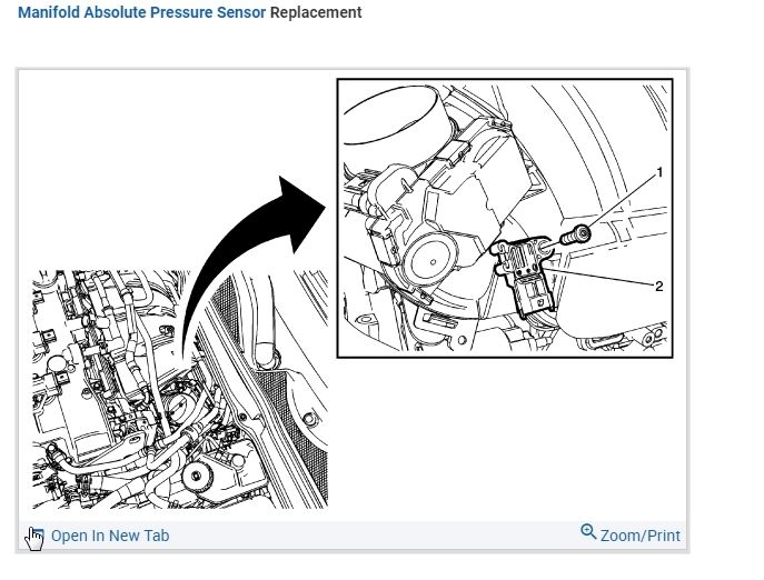

Doesn't look like my engine.
Jun 21, 2019 at 4:16 AM

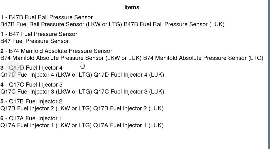

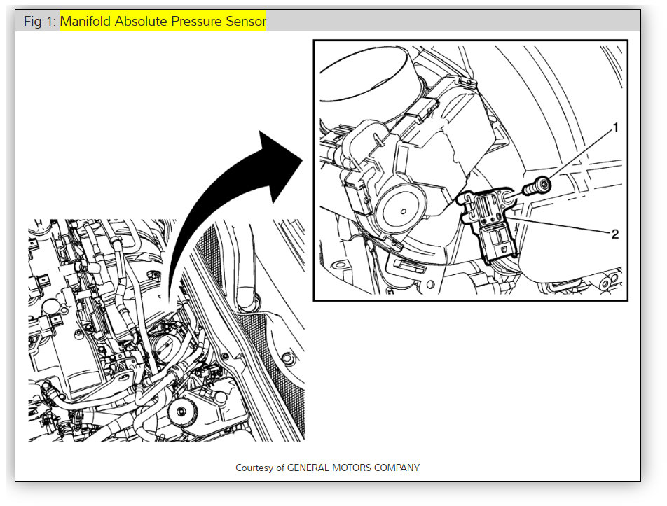

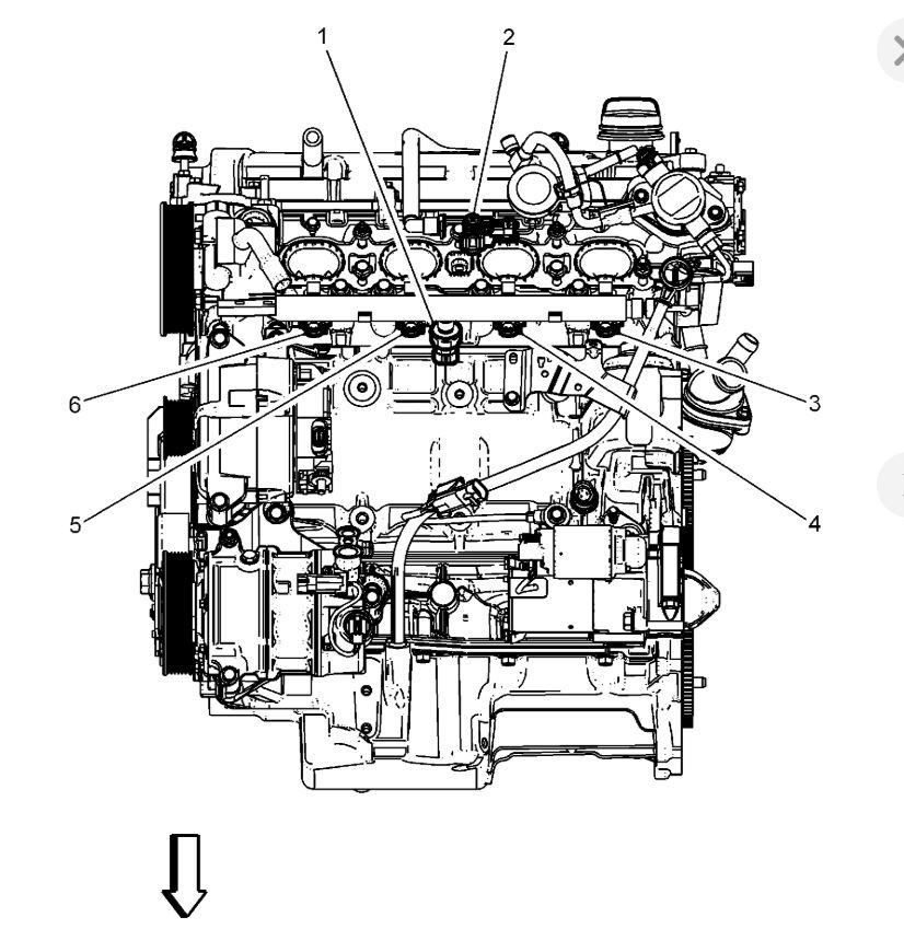

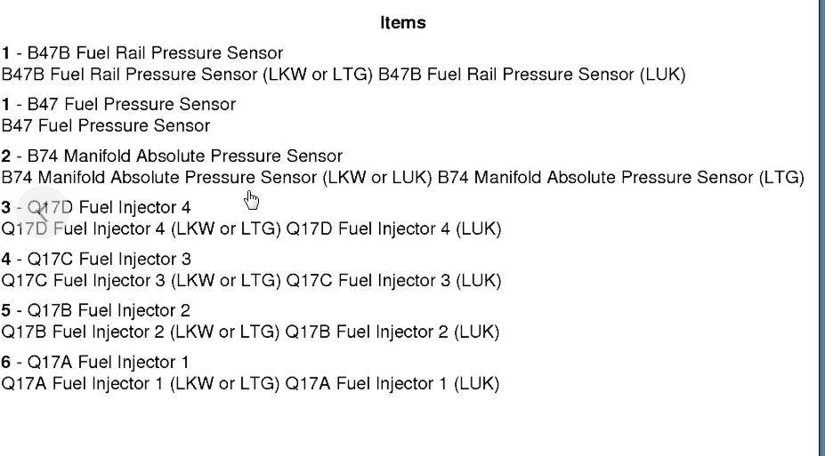

These procedures were for a 2.5L engine. Is that what you have?
I circled what appears to be what this is showing as the MAP. If this is not it, let me know if you have a different engine or we can dig deeper into why your 2.5L is different then the manual.
