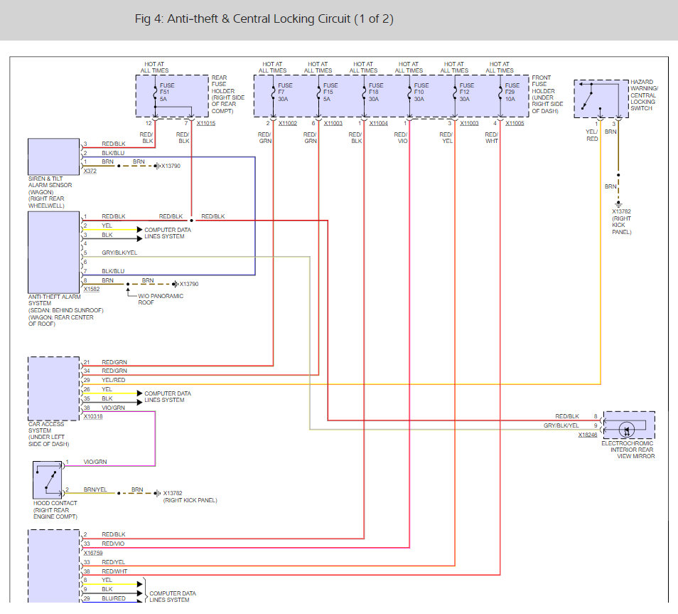

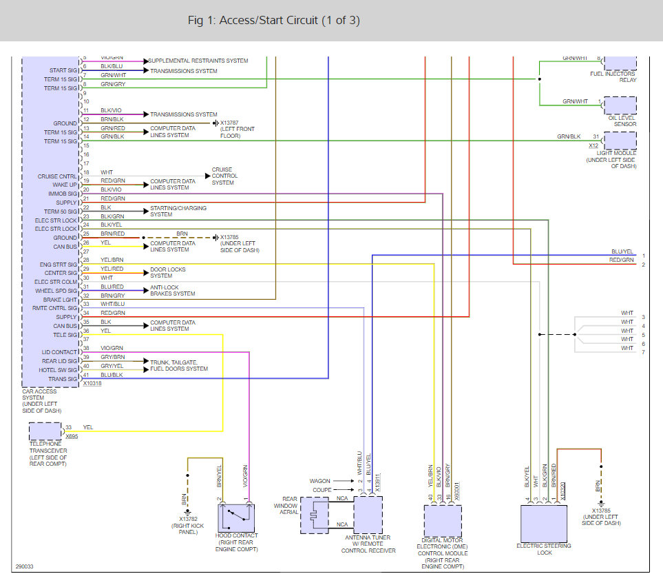

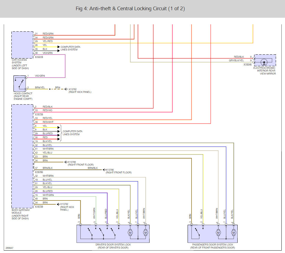

1B2001 electronic immobilizer protection against tampering : engine running blocked by electronic immobilizer
That code alone is a bad one. It suggests the anti theft system is active and it would cause a few of those codes if it is.
Use your scan tool and see if you can access the anti theft system and see if it will tell you if it's a bad key/switch or fob. Or it may not be reading the key at all.
Also check that the stored VIN matches the one for the car as that code can also mean the DME is defective ot coded wrong.

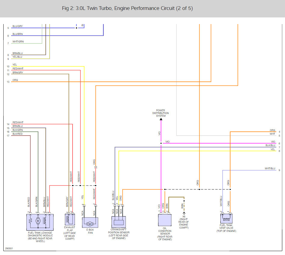

It also looks like the codes are either not clearing or the crank sensor wiring has an issue.
Sep 17, 2017 at 3:39 AM
MB-POWER
  • 80 POSTS
crank sensor has been replaced , So I think it's security system or DME.
Sep 17, 2017 at 4:18 PM
STEVE W.
  • 15,351 POSTS
Sensor was replaced but if there is a bad wire or connection between the sensor and the DME it could be dropping out.
Sep 17, 2017 at 5:19 PM
MB-POWER
  • 80 POSTS
connection checked and found good.

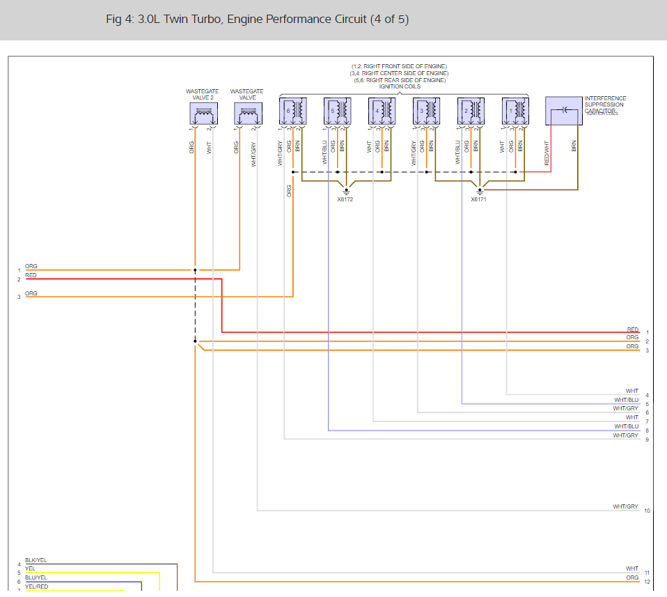

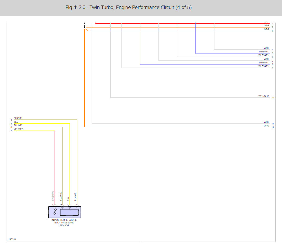

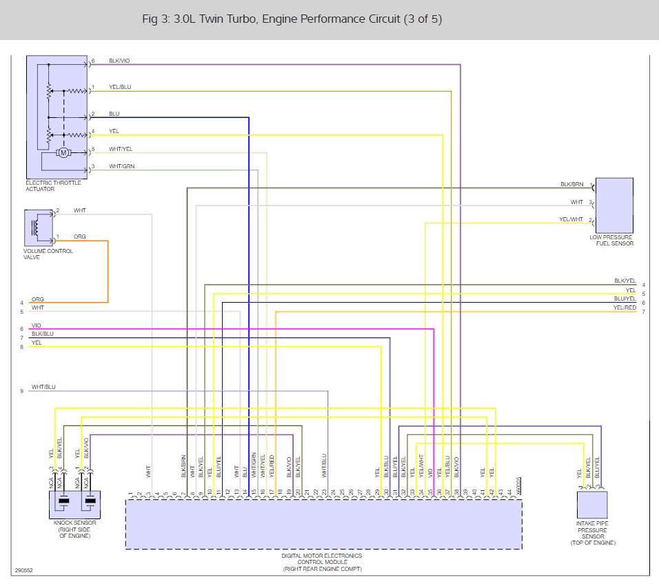

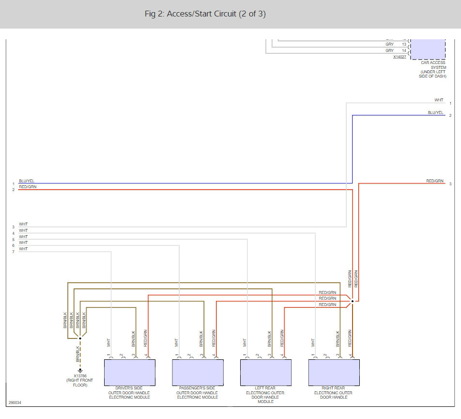

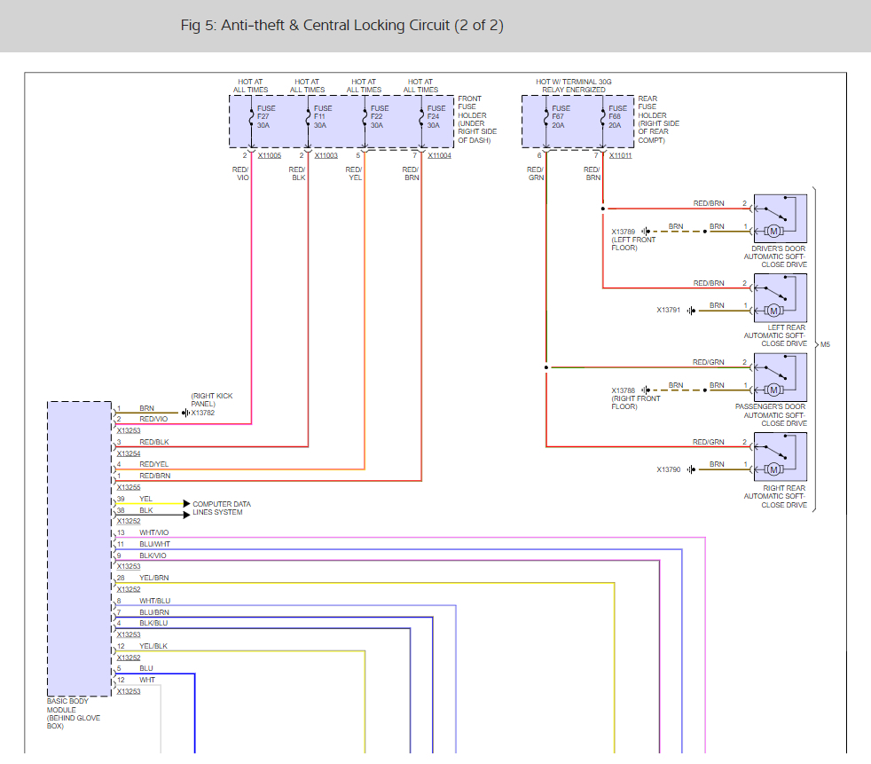

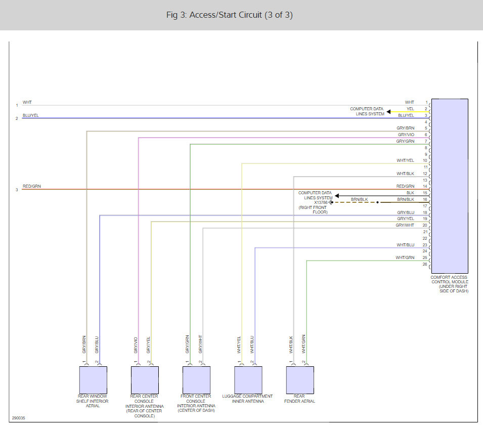

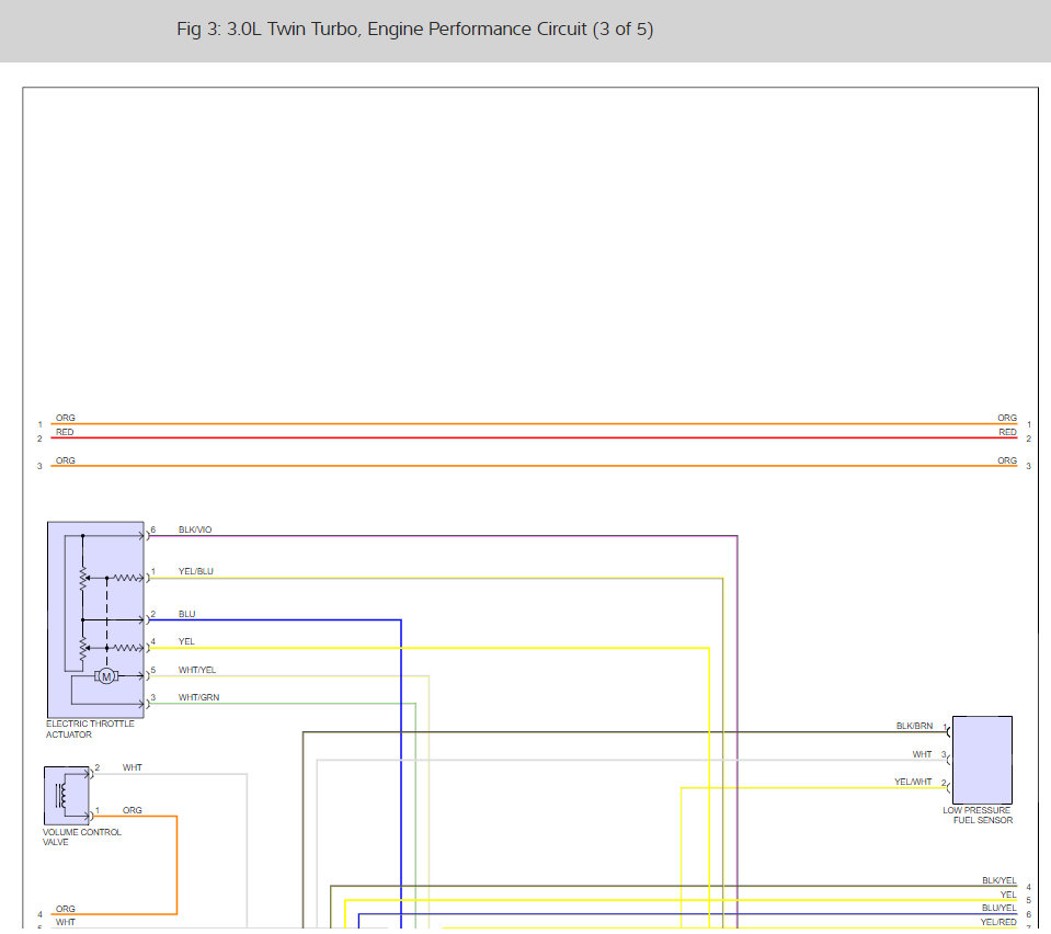

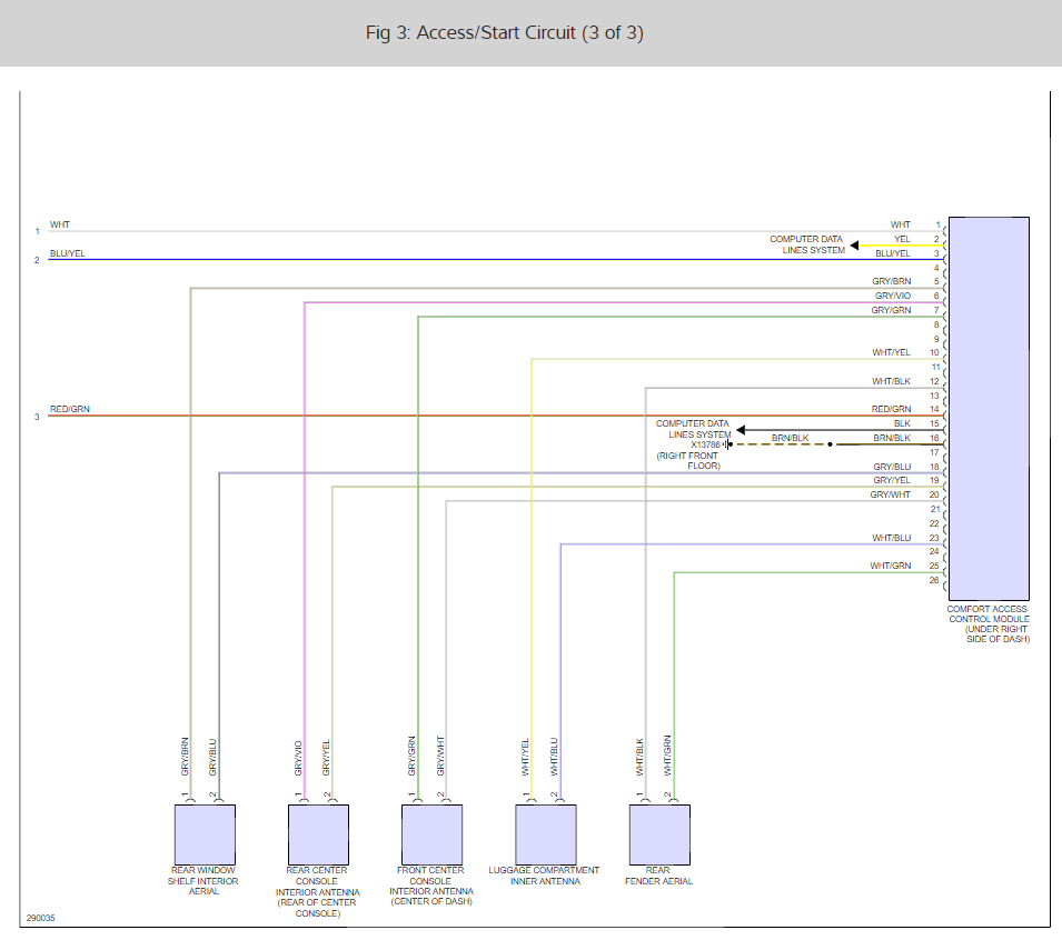

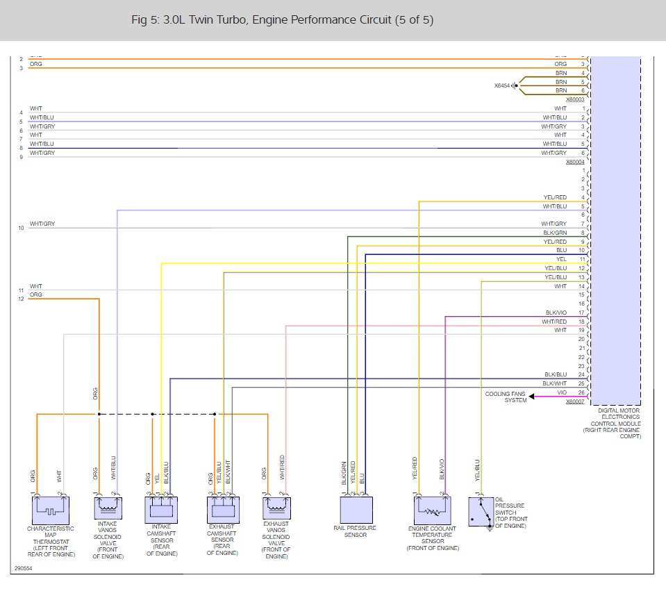

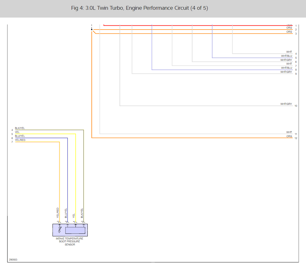

  • 55,433 POSTS

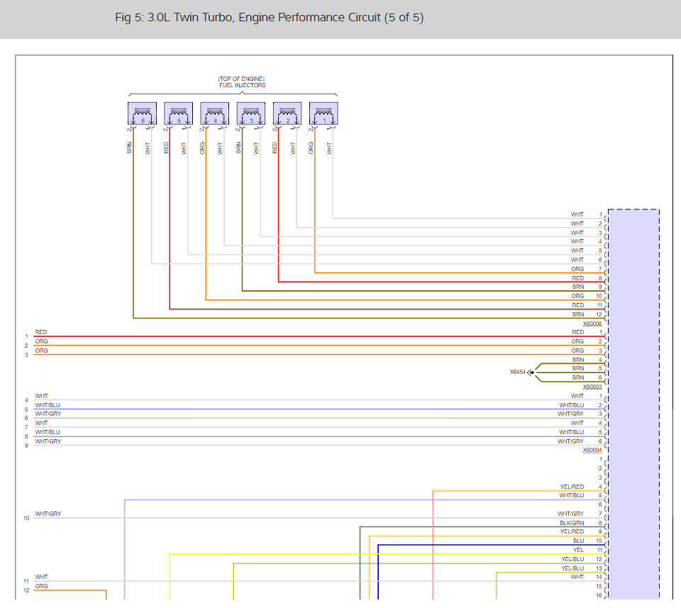

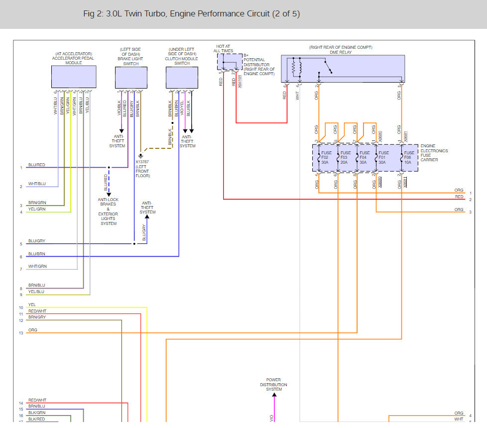

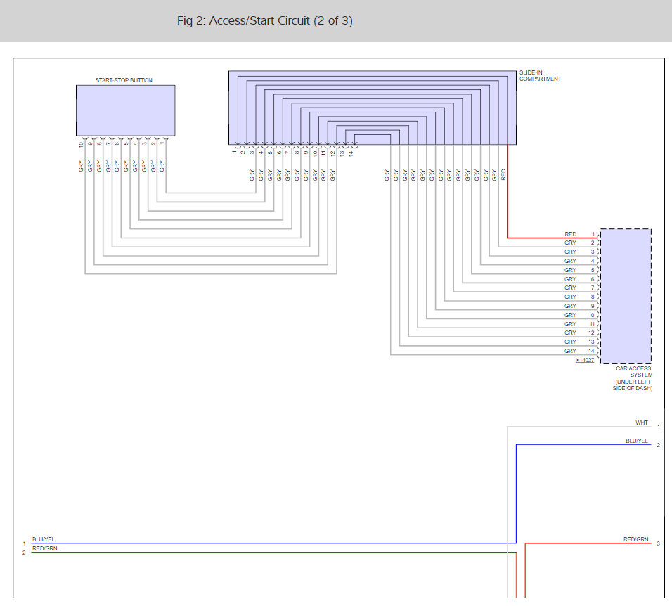

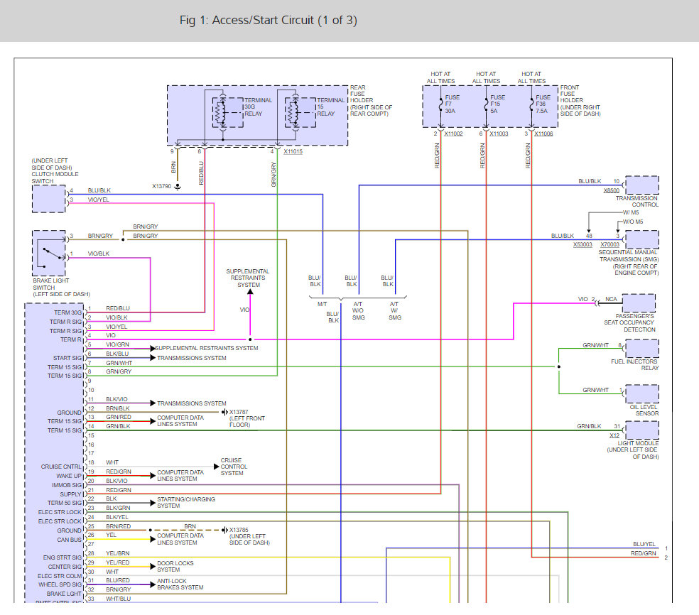

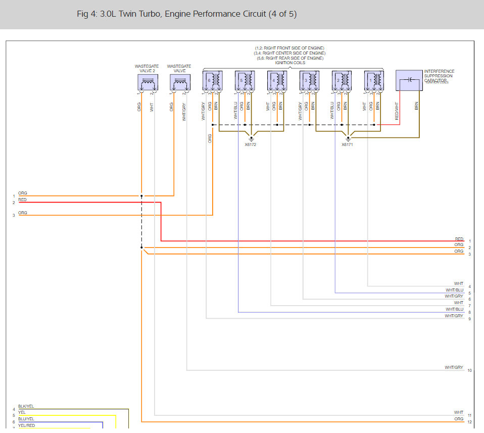

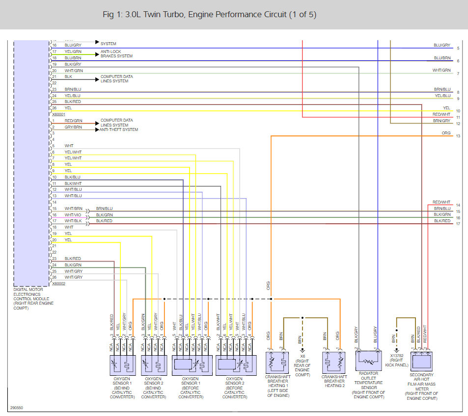

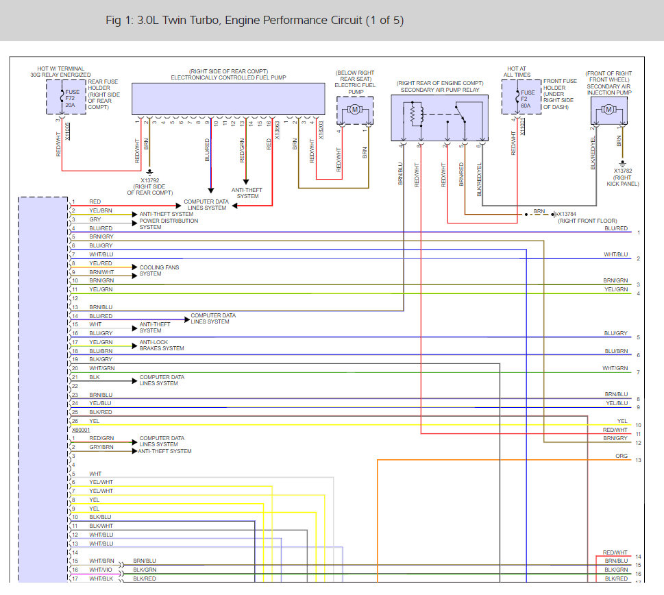

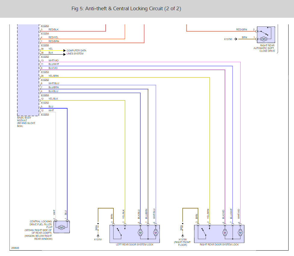

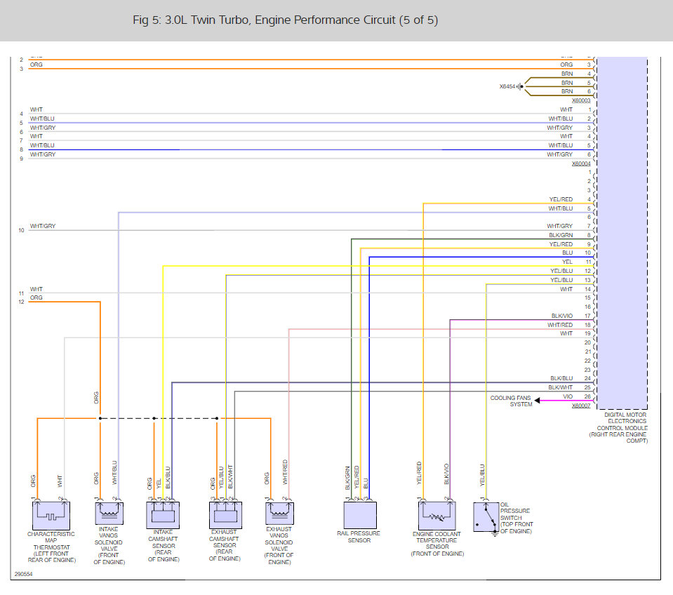

I don't know if this will help Im just jumping in here but It sounds like you have a connection problem. Here is a guide and some engine and security wiring diagrams (Below) that may help.
Please let us know what happens and upload pictures or videos of the problem.
