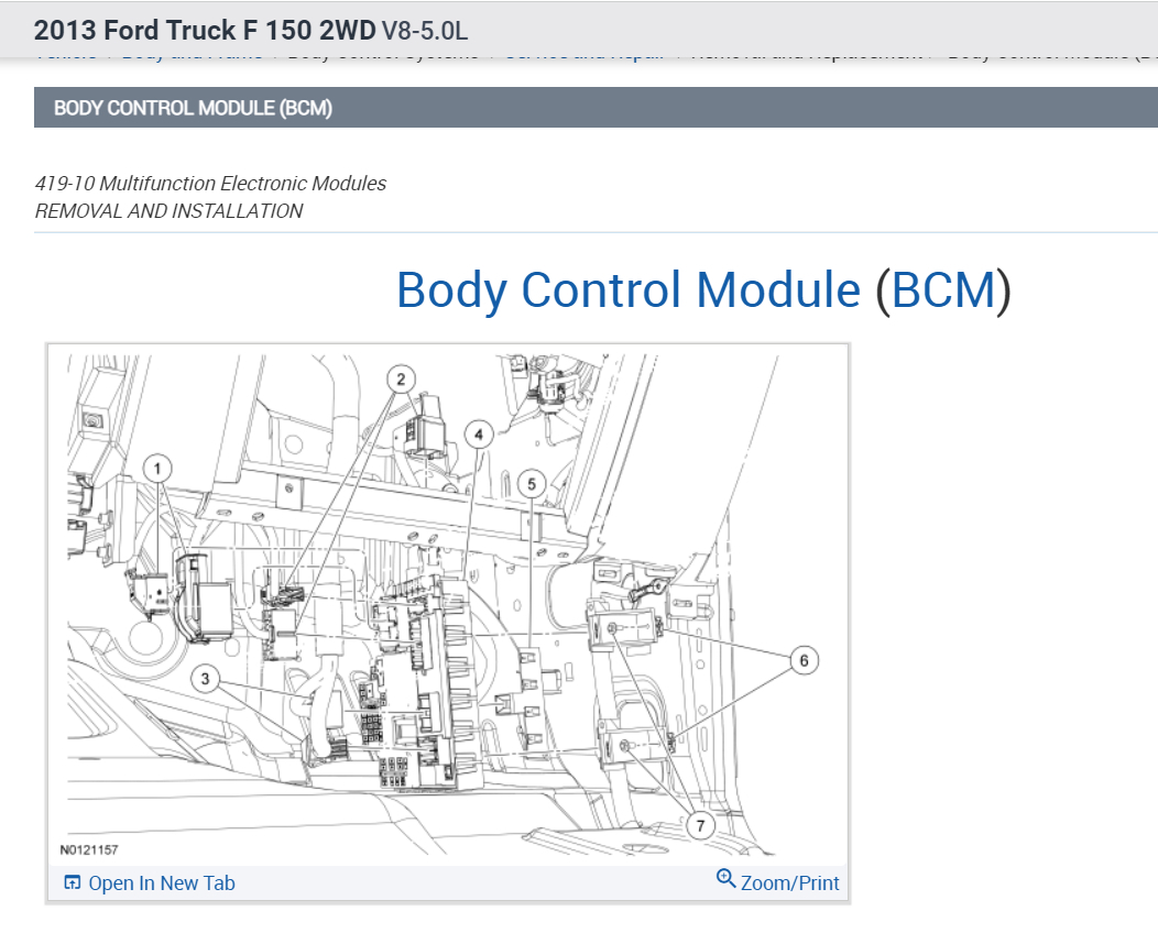

many different lights turned on, on the dash?
2013 FORD TRUCK
180,000 MILES • 6 CYL • 2WD • AUTOMATIC
SHAY MARIE2

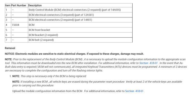

The wrench light flashed on then disappeared, right after that the airbag light came on, the miles to empty display showed nothing, the vehicle's mileage disappeared, and the speedometer stopped working

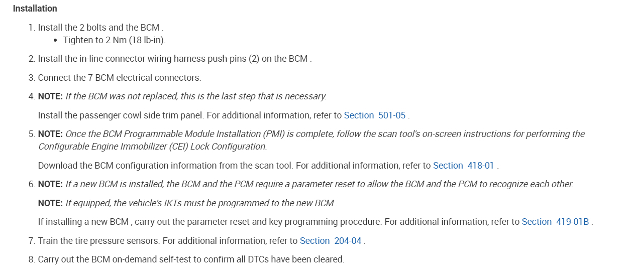

These trucks had problems with the BCM (body control module) especially when they get wet, but to be sure we need to do a CAN scan which is easy. You can get a CAN scanner (Controller Area Network) from Amazon from about $32.00.
https://youtu.be/u-4syLc-ifQ
and
Amazon CAN scanner Link.
https://amzn.to/3G7mpFP

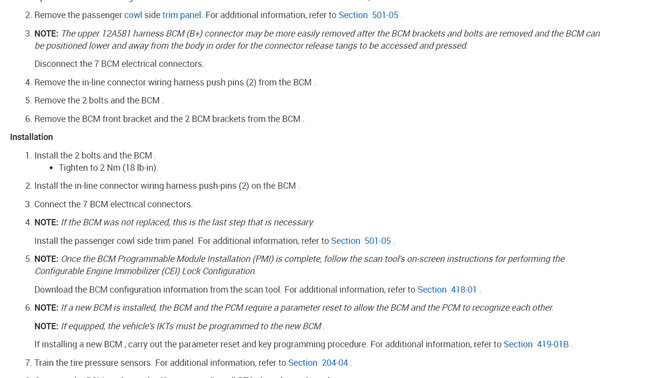

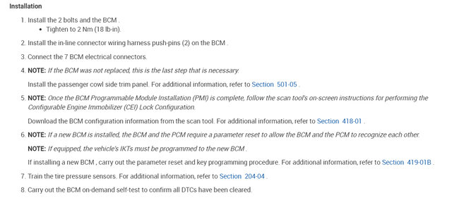

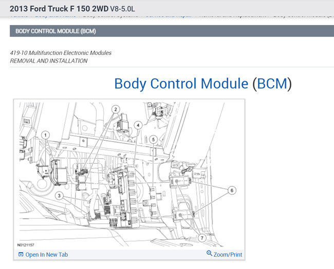

Here is how to change the BCM out in the images below in case you need them, you can get a rebuilt preprogrammed BCM if you search Google or eBay. Check out the images (below). Let us know what happens and please upload pictures or videos of the problem.
