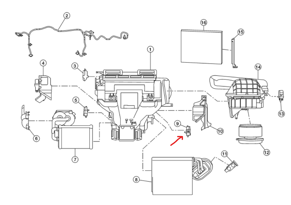

Need to find the blend door to manually move it to AC

Yes, good call the hot weather is on its way. Here is the temperature blend door actuator so you can move it by hand and wedge it there. Or you can open the actuator and work the gears which will do the same thing. Check out the images (below). Let me know how it goes
