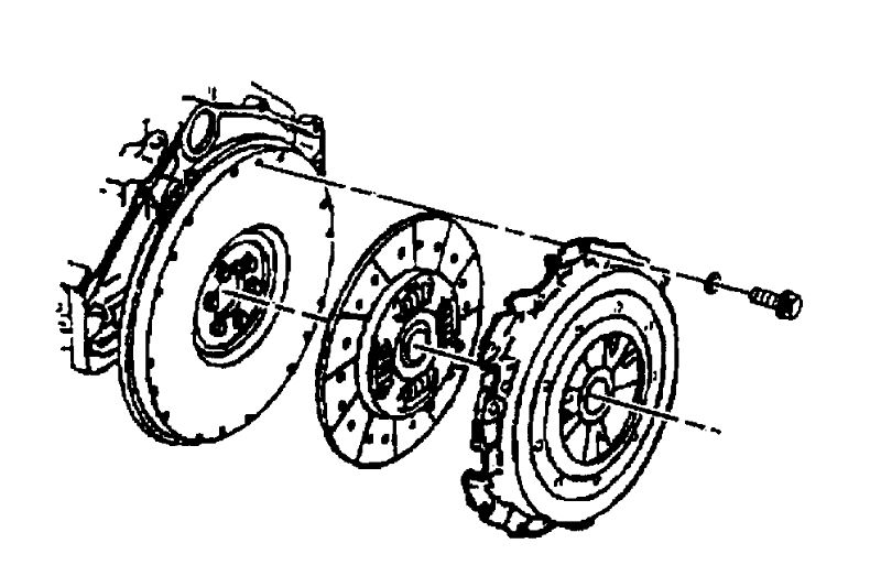

Good afternoon,
Do you mean you cannot get it into gear or that it will pop out of gear?
Monday, March 9th, 2020 AT 2:40 PM
JODY COSTLEY
Will not go into any gear it keeps popping back into where neutral would be in middle. Will not stay in any gear.
Monday, March 9th, 2020 AT 3:16 PM
  • 52,797 POSTS
Okay, this sounds like a clutch issue.
Does the clutch pedal feel normal?
I attached a YouTube video for the replacement.
https://www.youtube.com/watch?v=6cbRhl8DsHo
REMOVAL PROCEDURE
1. Raise and support the vehicle.
2. Remove the transmission.

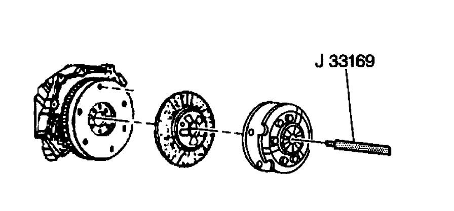

3. Mark the flywheel, cover plate, and pressure plate for installation alignment.
4. Install J 33169 through the cover plate, pressure plate, and into the flywheel for support during plate removal.
5. Remove the bolts and washers securing the clutch pressure plate and cover plate to the flywheel.
6. Remove J 33169 from the plates.

INSTALLATION PROCEDURE
1. Using J 33169 for installation alignment, position the pressure plate and cover plate to the flywheel.
2. Secure the plates to the flywheel with bolts and washers. Use the marks made during removal to align the plates.
Tighten:
Each bolt one turn at a time in order to avoid warping the clutch pressure plate cover. Use a criss-cross pattern for tightening the bolts.
The pressure and cover plate bolts for the NV1500 transmission to 45 Nm (33 ft. lbs.).
The pressure and cover plate bolts for the NV3500 to 40 Nm (29 ft. lbs.).
3. Remove J 33169 from the clutch plates.
4. Install the transmission.
5. Lower the vehicle.
6. Test the transmission and clutch system for proper operation.
