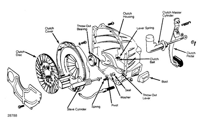

You have a T-176 4 speed transmission?
Has the transfer case been unbolted/removed/partially been removed from the transmission?
Does your slave cylinder fully extend when the clutch pedal is pushed?

If it were dry (empty), you will probably need to bleed it to optimize clutch operation.
Along with that, if it got empty, the juice went somewhere. It may have seeped out slow over a long period of time, it may have went all of a sudden.
The thing is, however it left the system, is probably when you started having shifting issues.
It may need some tightening or repairs to seal things back up.
Yep, one more thing already on the AMC maintenance schedule to be checked periodically. Now realized and now on your list!
This was not a problem a few years earlier in CJs when the clutch was operated by mechanical linkage with no slave involved.
Keep us posted on progress or anything you might need help with.

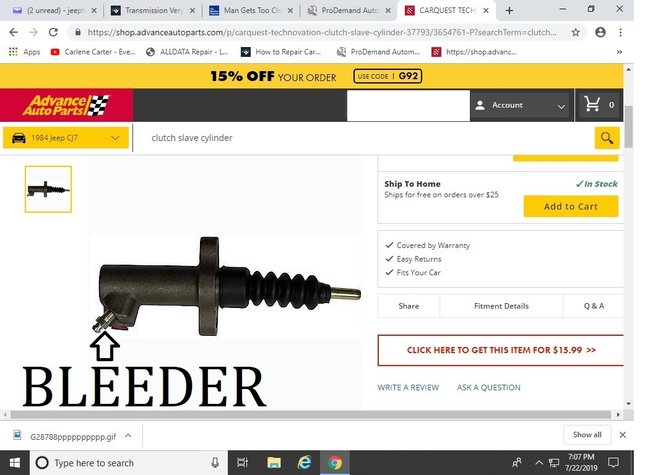

Keep the clutch reservoir topped off, do not let it run out of juice.
Pump the clutch pedal 3 or 4 times and hold it to the floor.
(insure there is no dirt daubers or mud obstructing the bleeder hole)
Have your assistant crack open the bleeder screw on the slave cylinder.
Just like I like to bleed brakes, I close the bleeder screw before all of the squirting pressure gets to zero. This insures that no air gets sucked back in.
I might even suck out any old juice from the reservoir before I started (turkey baster works well) then bleed until all of the old discolored juice has been pushed out.
Once you are done, search for and repair any leaks that might be present.
2 pics below,
