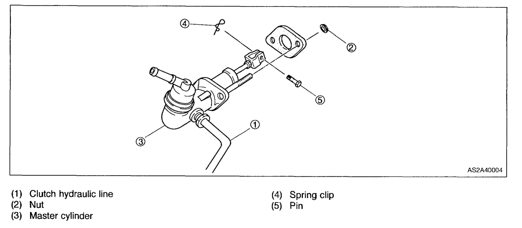

At 1st, when I pushed clutch down, it went down but I had to use my foot to pull it up and get it to engage.
Got to destination, went to leave. When pushing clutch, the tension was loose until it was halfway down, then tension was normal but it wouldn't go into gear. About a 1/2 an hour later, it worked fine.
Stopped again when I got to next destination. Went to leave and clutch went down, stayed all the way down and wouldn't go into gear.
Got towed.
When I went to check it a few days later, it was back to normal.

Good morning,
This sounds like either the clutch master cylinder or the slave cylinder is failing.
I would replace both units and bleed the system.
I attached the procedure below for you for the repair.

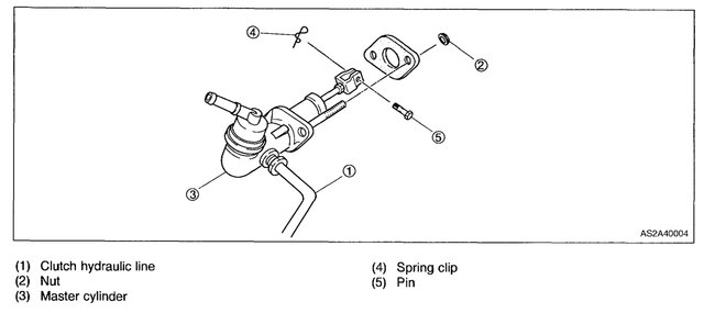

Clutch master cylinder
Removal

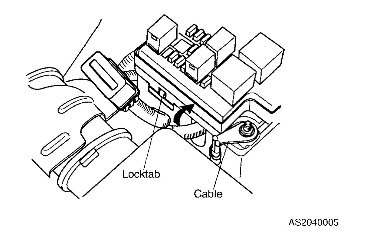

1. Disconnect cable.
2. Pull locktab,then remove fuse box.
3. Remove spring clip and pin from master cylinder push rod.
4. Remove master cylinder mounting nuts.
Notice: Clutch brake fluid will damage painted surfaces so use a container or shop towels for fluid collection. If fluid gets on a painted surface, rinse immediately with clear water to prevent damage.

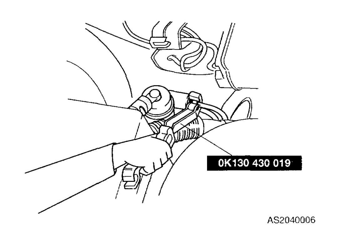

5. Disconnect clutch master cylinder hose.
6. Disconnect clutch hydraulic line with SST(OK130 430 019).
7. Remove clutch master cylinder.
Replacement
1. Install clutch master cylinder.
2. Tighten master cylinder mounting nuts.
3. Insert spring clip and pin into master cylinder push rod.
4. Tighten clutch hydraulic line with SST(OK130 430 019).
Tightening torque: 9.4 - 15.9 ft. lbs. (12.7 - 21.5 Nm, 1.3 - 2.2 kg.m)
5. Connect clutch master cylinder hose.
6. Install fuse box.
7. Install cable.
8. Perform clutch hydraulic line bleeding.
9. Verify that there is no leakage.
10. Perform a road test.

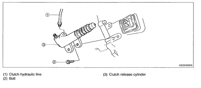

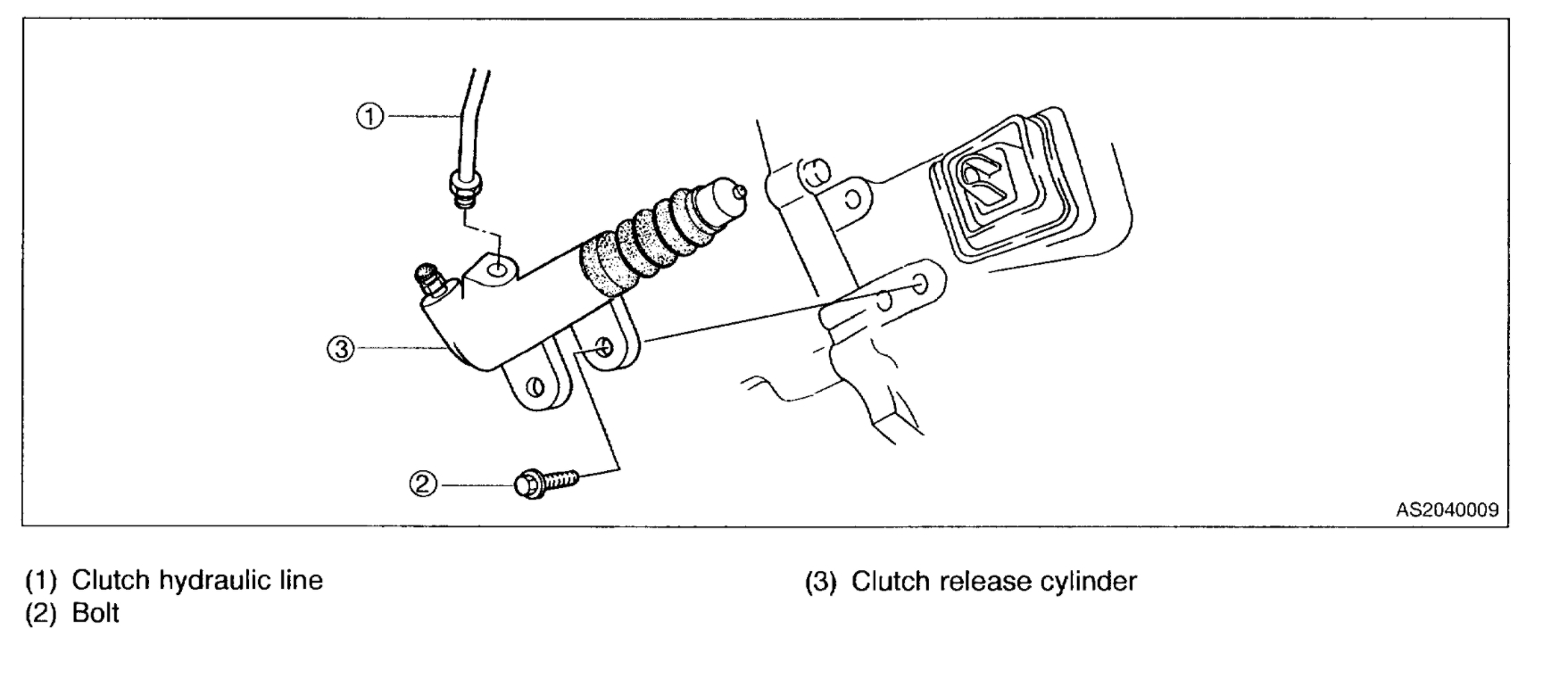

Clutch release cylinder
Removal
Notice:
a) Clutch fluid will damage painted surfaces. Be sure to use a container or shop towels to collect it
b) If fluid contacts a painted surface, rinse immediately with clear water to prevent damage.
Caution: After removing the clutch line, plug the clutch line to avoid fluid leakage.
1. Raise and properly support vehicle.
2. Remove gravel shield from under engine (seven bolts).

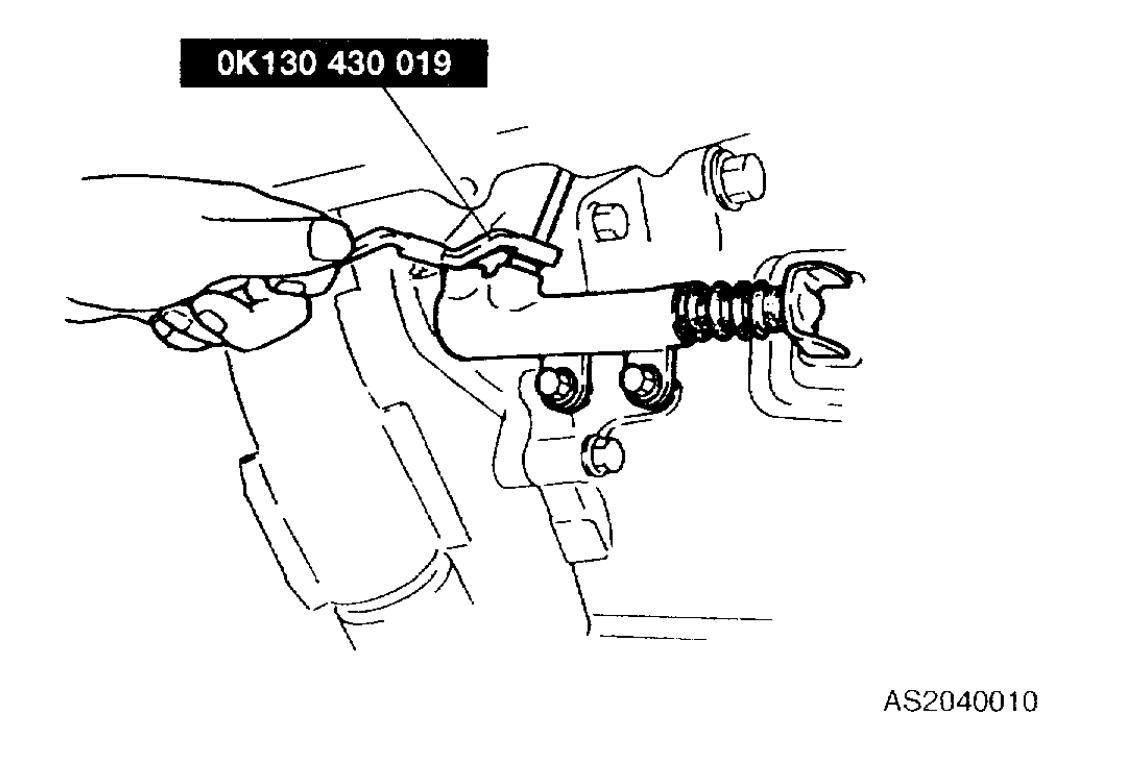

3. Disconnect clutch line with SST(OK130 430 019).
4. Remove two release cylinder bolts, then remove release cylinder.
Replacement
1. Install clutch release cylinder.
2. Tighten two release cylinder bolts
Tightening torque: 13.7 - 18.8 ft. lbs. (18.6 - 25.5 Nm, 1.9 - 2.6 kg.m)
3. Tighten clutch hydraulic line flare nut with SST(OK130 430 019).
4. After installation, bleed the clutch system.
5. Verify that there is no leakage.
6. Perform a road test.
