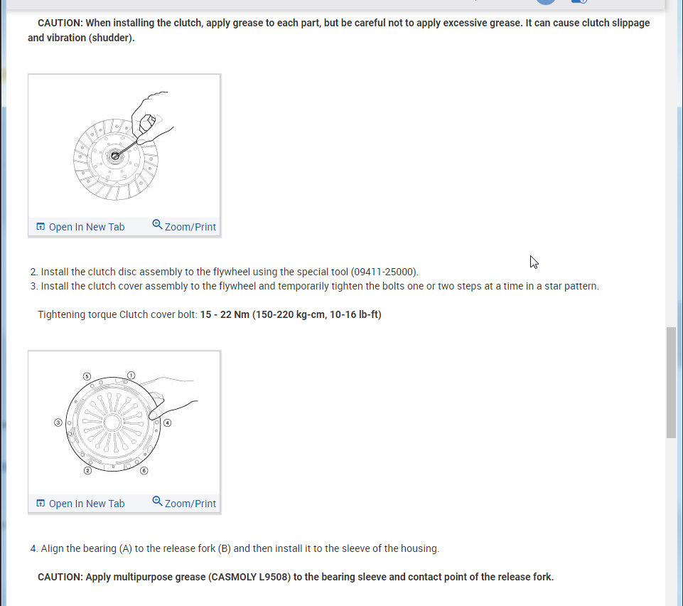

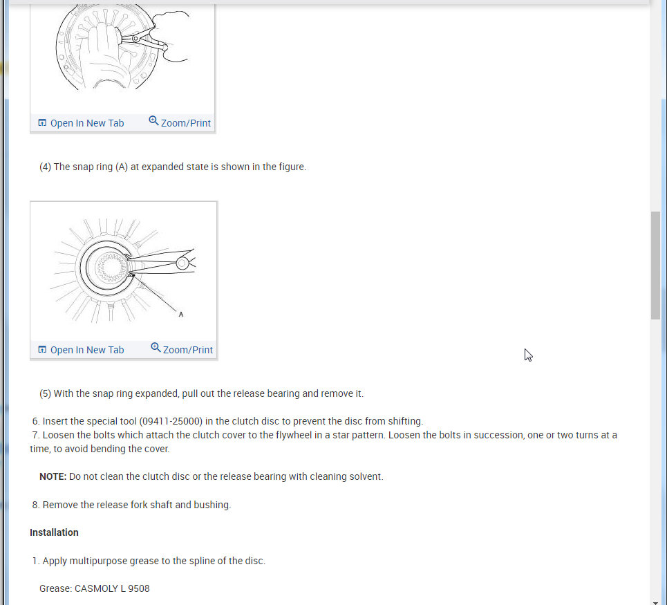

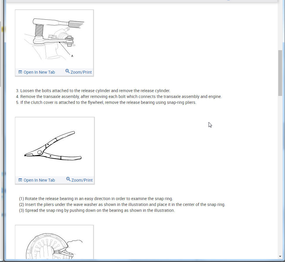

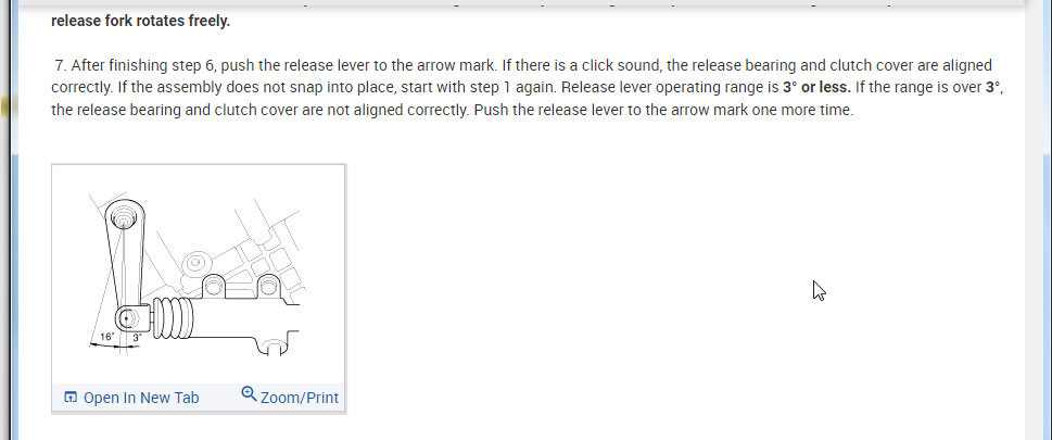

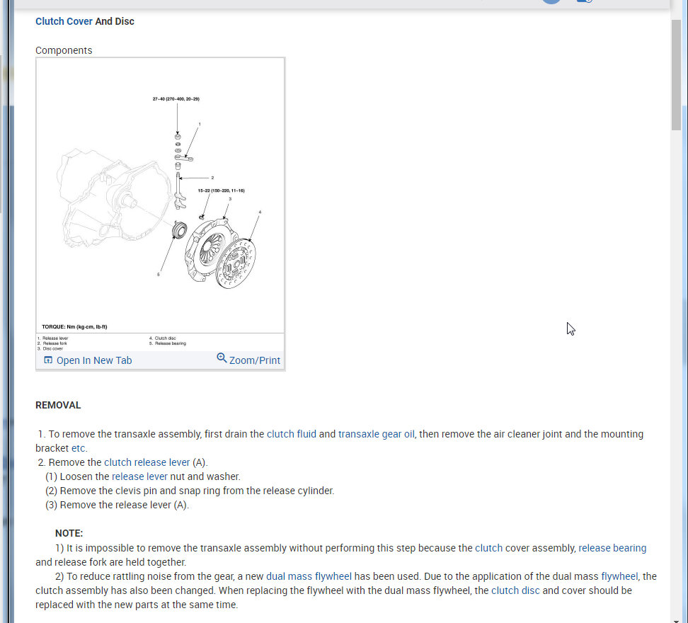

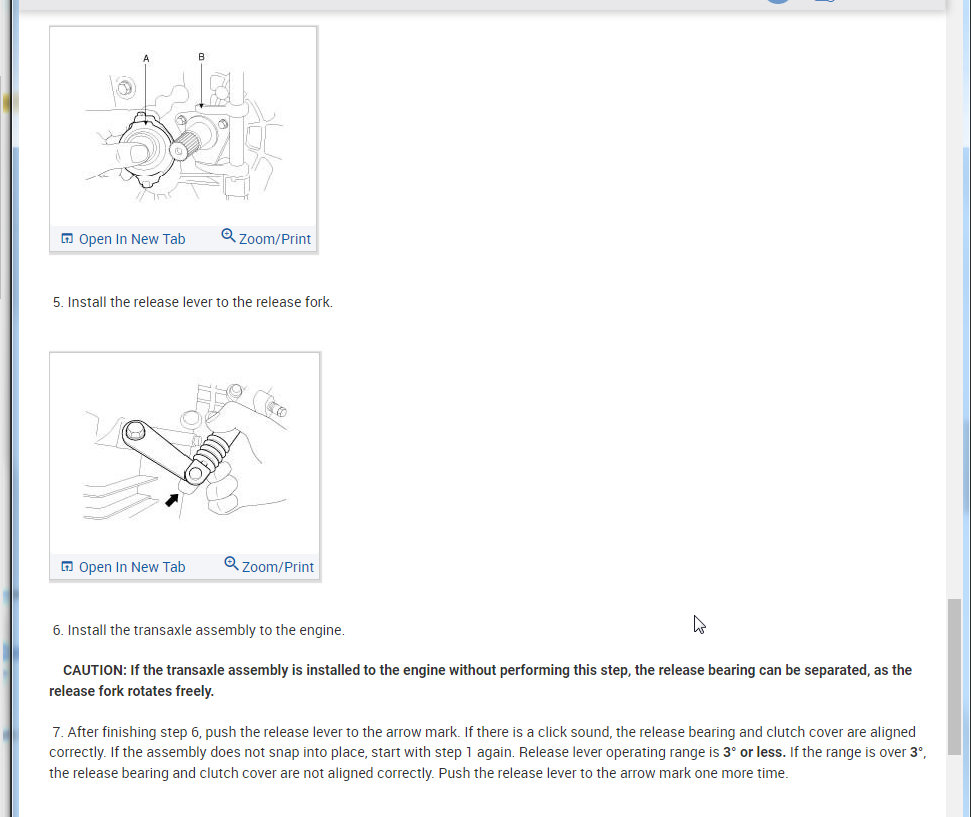

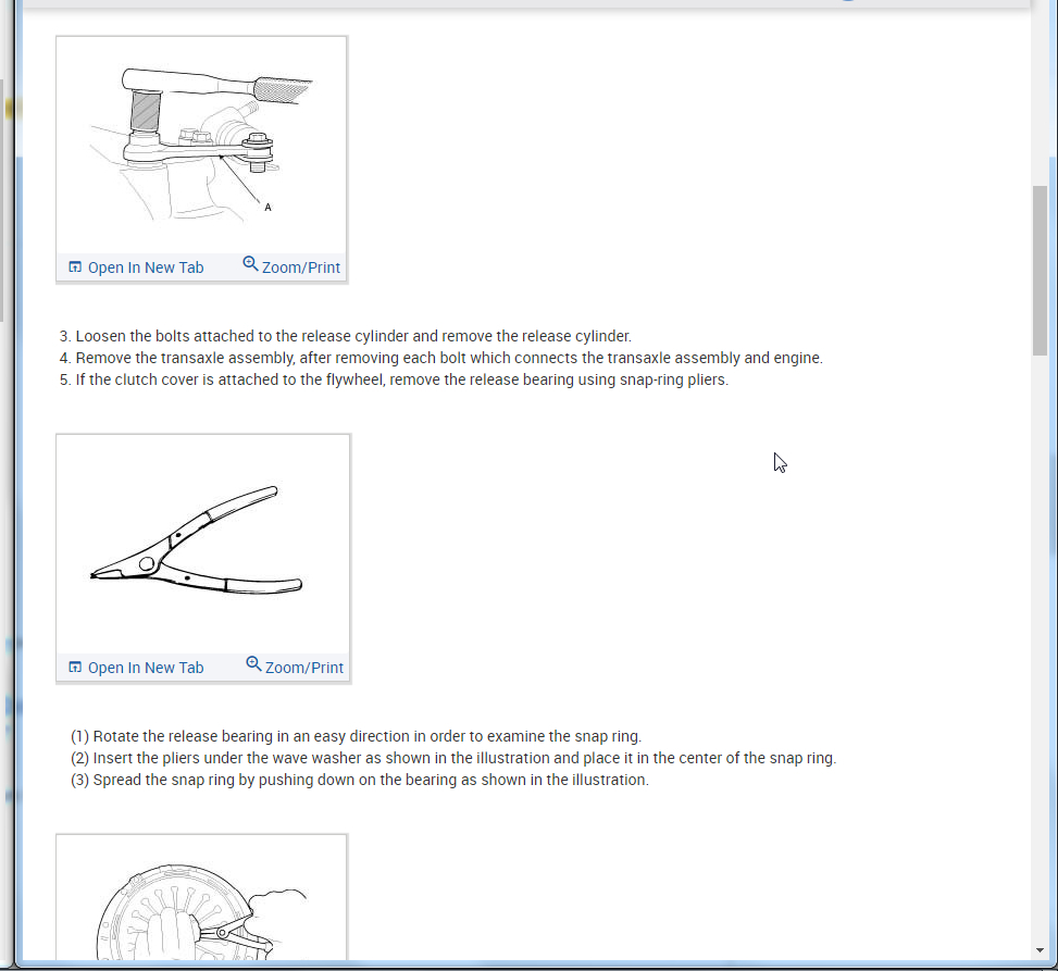

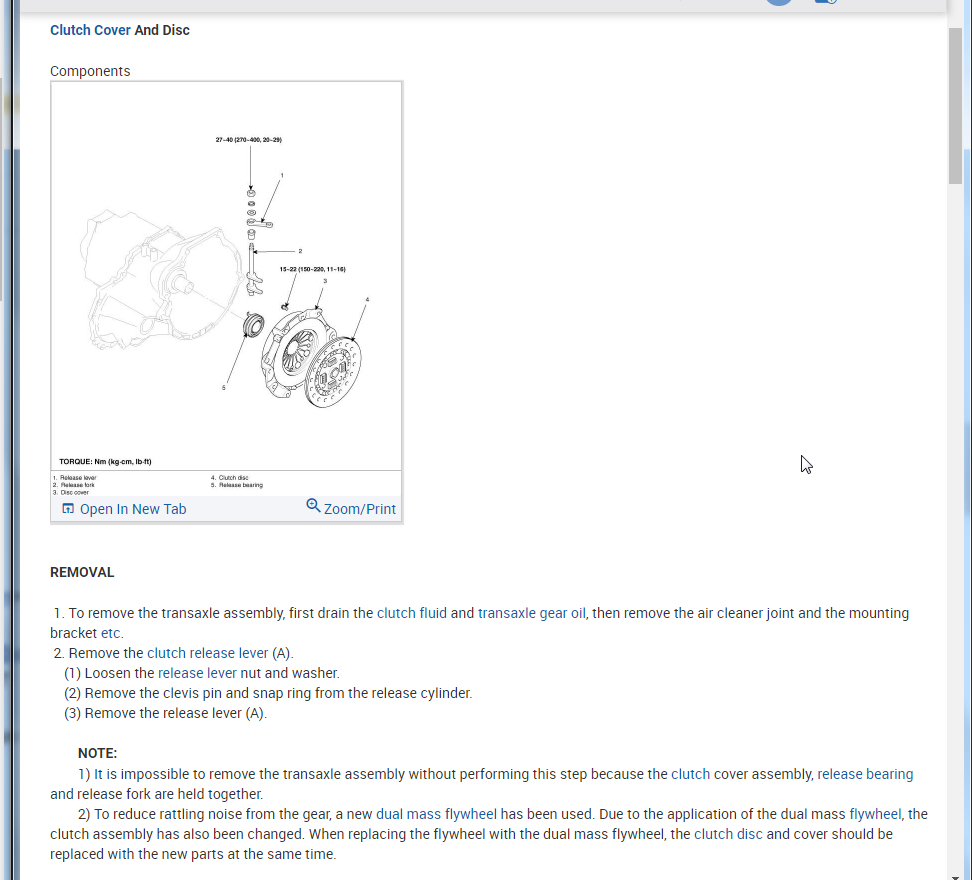

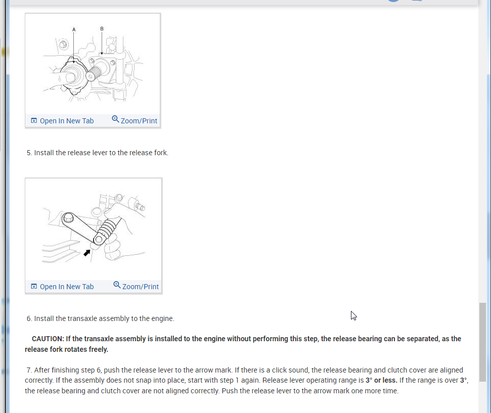

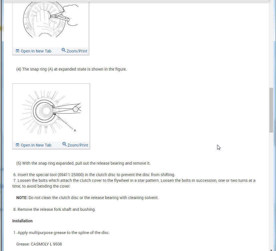

Can you tell me how to do a clutch replacement?
Monday, February 1st, 2010 AT 7:07 PM
MECHANIC
18,907 POSTS
Here is a guide that will help with step by step instructions:
https://www.2carpros.com/articles/how-to-replace-a-clutch
https://www.2carpros.com/articles/throw-out-bearing-replacement
https://www.2carpros.com/articles/pilot-bearing-replacement
Below you will find the process from the manual that will help as well. Please let us know if you have other questions. Thanks
