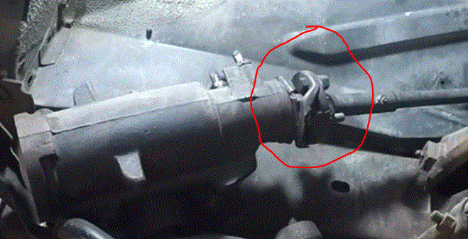

Yes, that is correct. Please bear with me. It has been awhile since I worked on one of these. But, there should be what is called a rag joint between the steering column and where it attaches to the gear box. I attached a pic I found online so you can see what it should look similar to. It may be necessary to loosen the steering column to be able to disconnect it from the gear. However, there should be a jam nut on closest to the gear that once loosened will allow you to remove the gear.
Let me know if I can help.

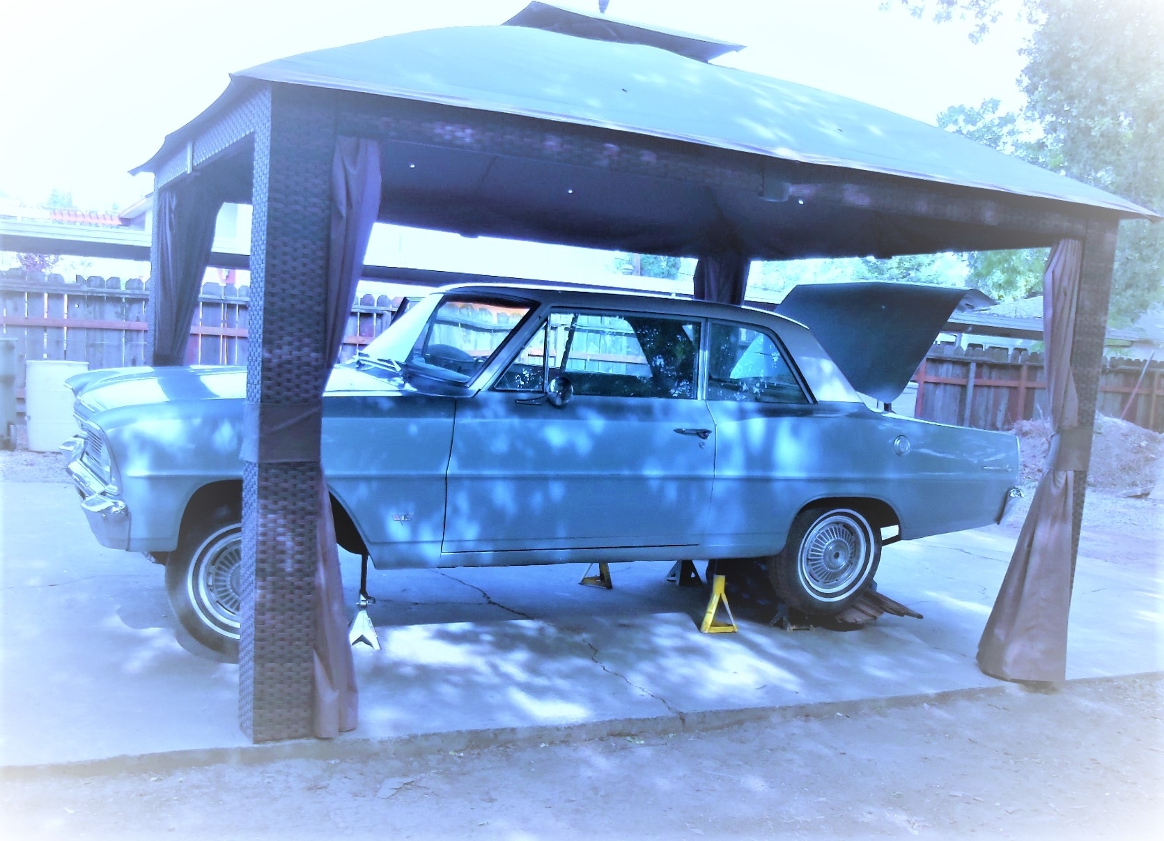

thank you Joe for the help. i'll let you know how it turns out,thanks brother buzz. i added a picture of the car. i have been restoring it for about a year , all that's left is the steering box, and some great big tires and rims. but that has to wait, until this world gets healthy again, and i get back to work.. all you guys at 2CarPros stay safe and healthy.

You are very welcome and great car. It looks really nice.
Enjoy it!!!
