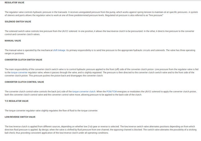

The manual shifter works perfectly when the outside temperature is above 45 degrees. However, when the temperature drops below 45 degrees, the manual shifter does not work.
When trying to downshift manually below 45 degrees, nothing happens. The shifter light does not change to a number. It continues to show in position 'D'.
At higher temperatures, all works fine.
This causes a problem when driving down steep hills while not being able to engine brake.
Could there be a rubber somewhere which gets too tight at low temperatures?
Thanks for any help.
Aug 18, 2021 at 6:51 PM
Good morning,
This sounds like a valve body issue in the transmission.
I would start by changing the fluid and filter and see if it helps. Beyond that may require removal of the valve body and inspection.
