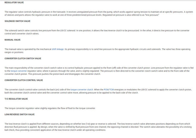

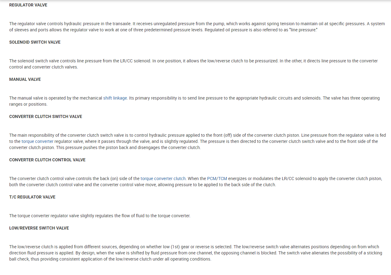

Good morning,
This sounds like a valve body issue in the transmission.
I would start by changing the fluid and filter and see if it helps. Beyond that may require removal of the valve body and inspection.
