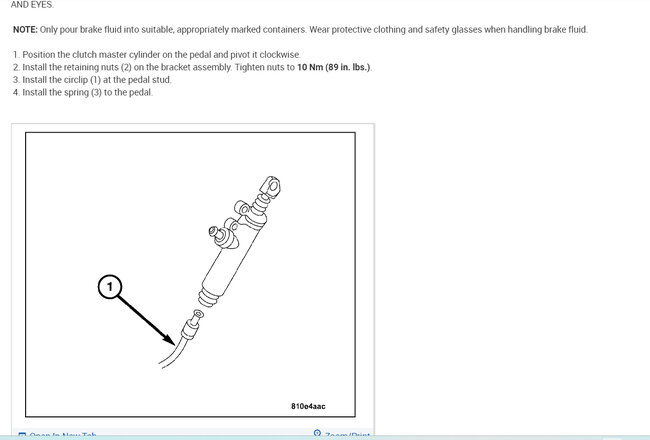

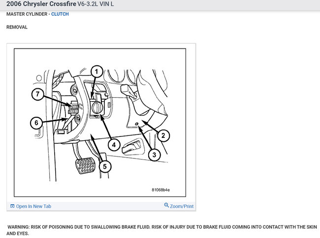

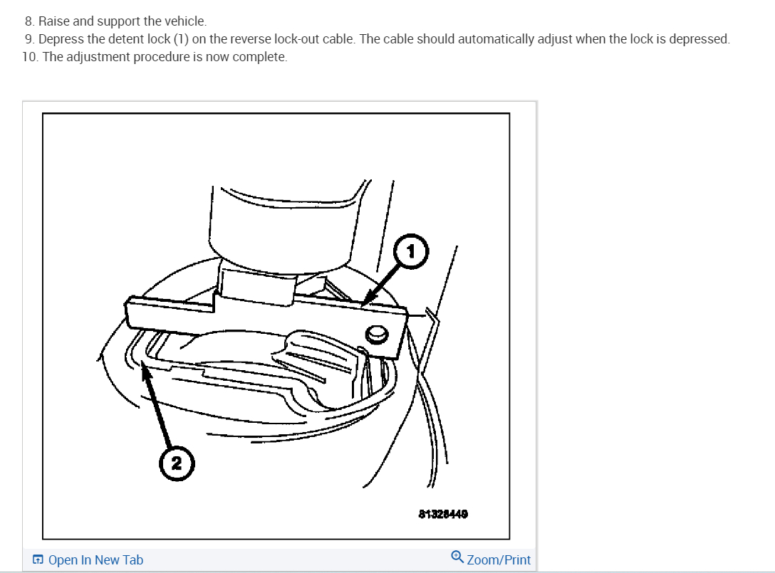

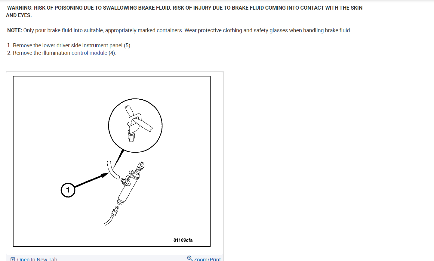

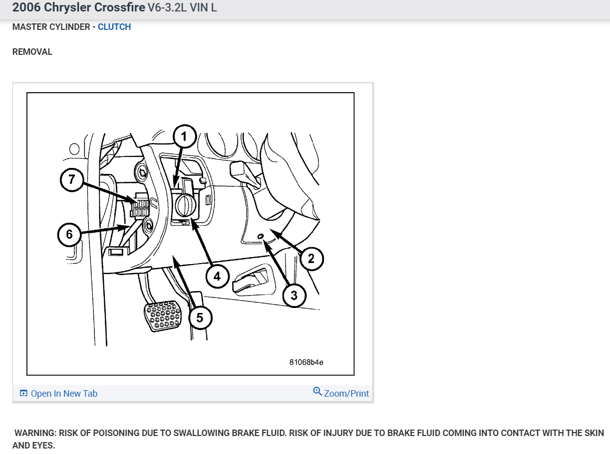

My manual shifter will lock in 6th gear whenever it feels like it. So, I pull over, turn off the vehicle, pump the clutch and gently play with the shifter then it will engage and let me on my way. Have noticed a small leak drivers' side above the exhaust manifold (MC or Slave maybe?) One time had a small oily spot inside the vehicle around the clutch (MC again?)

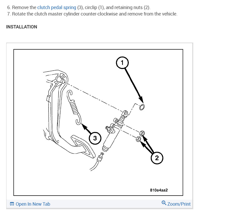

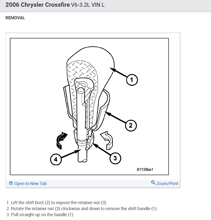

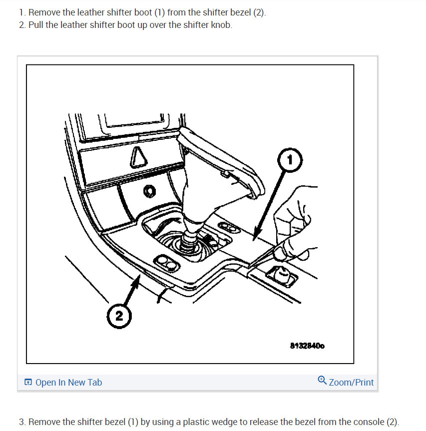

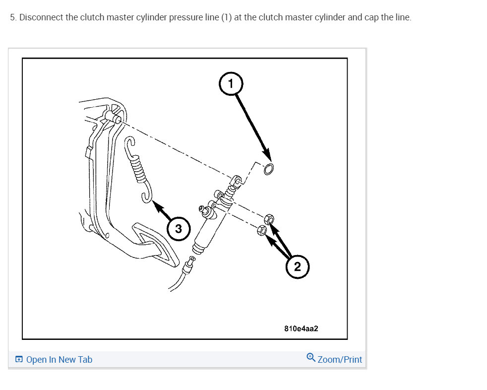

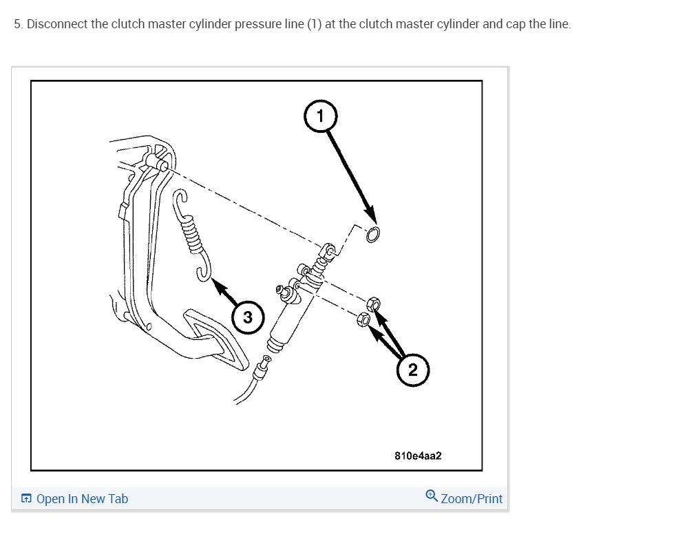

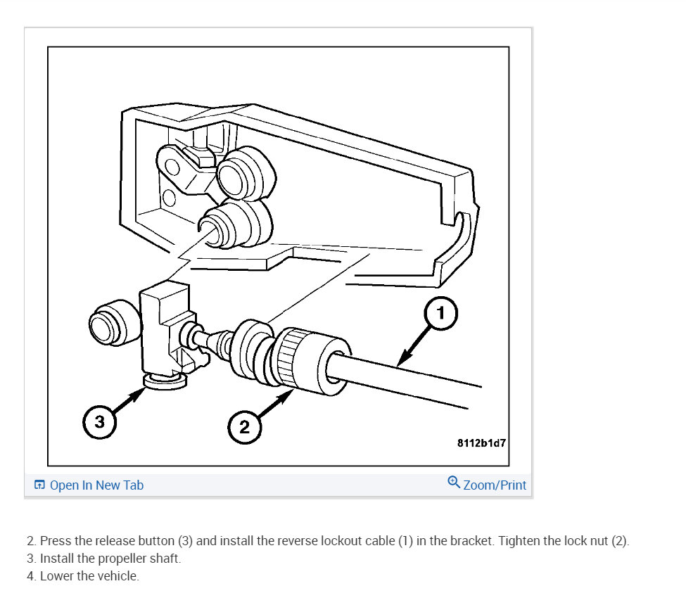

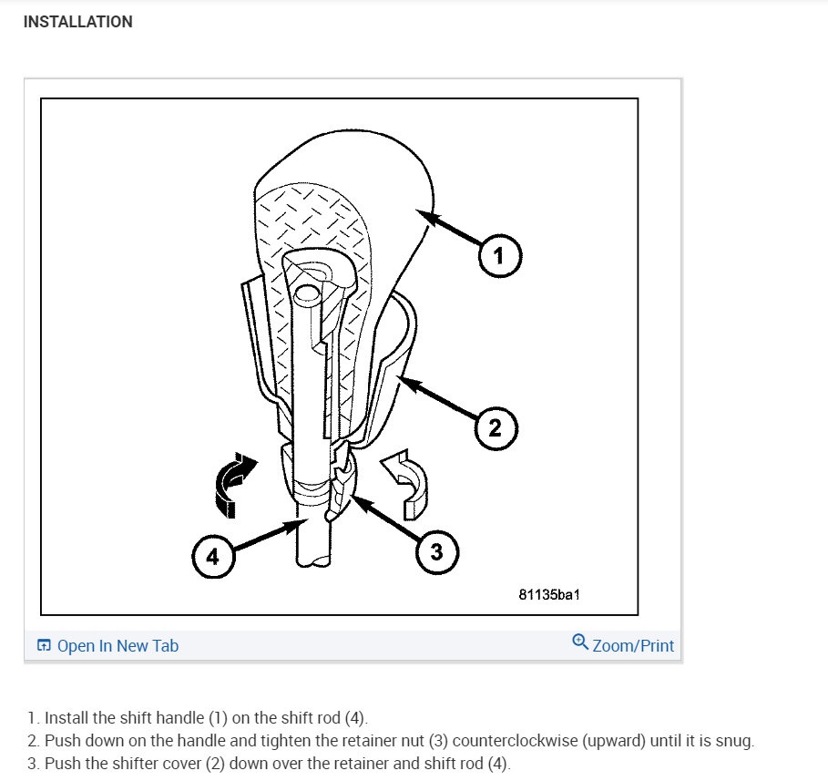

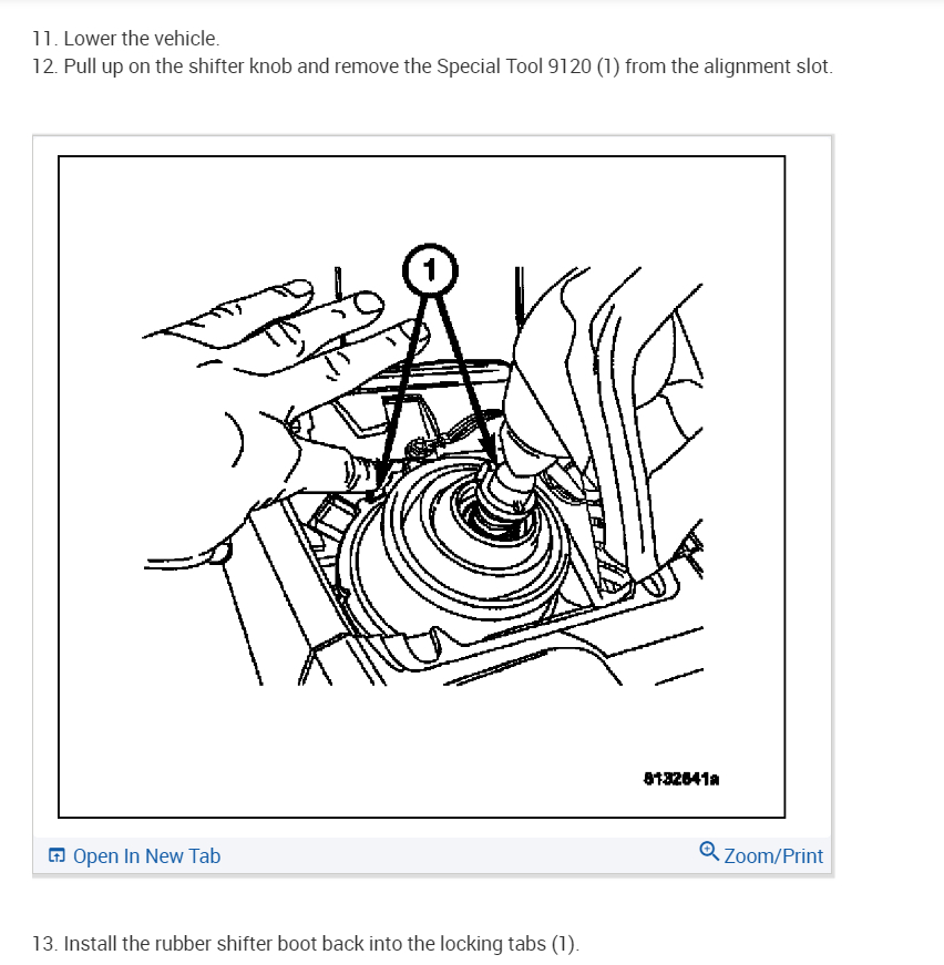

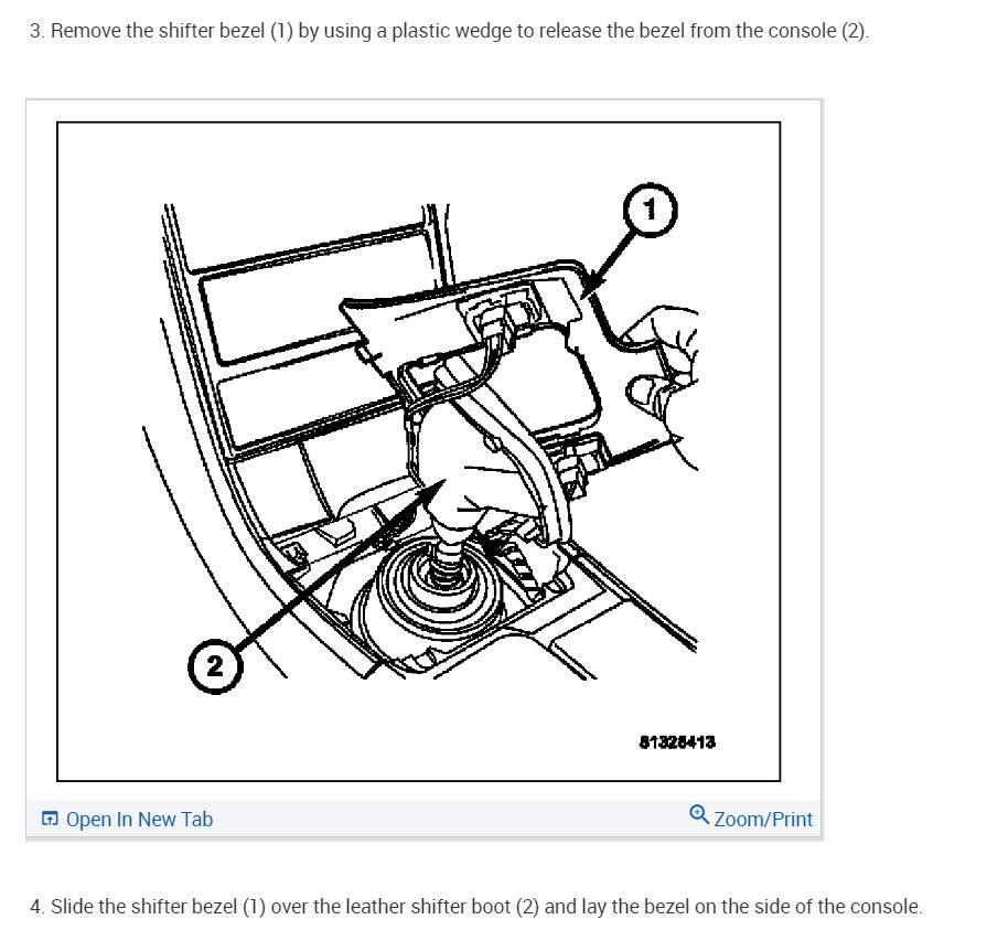

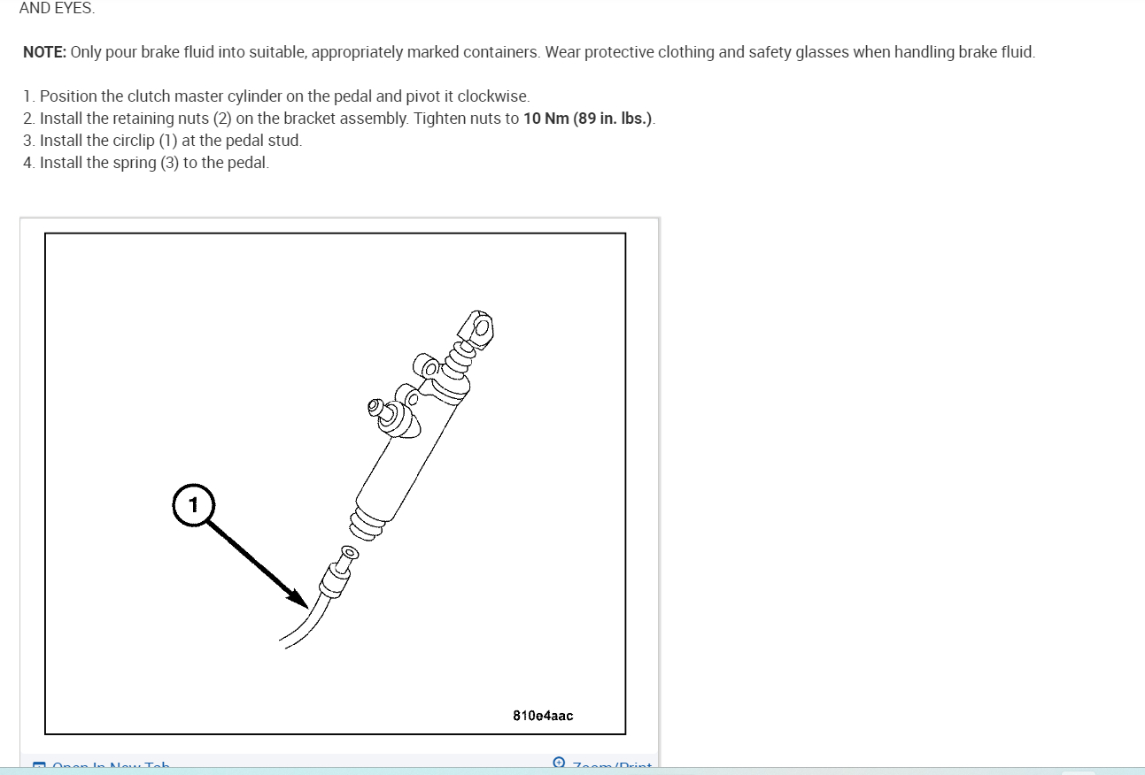

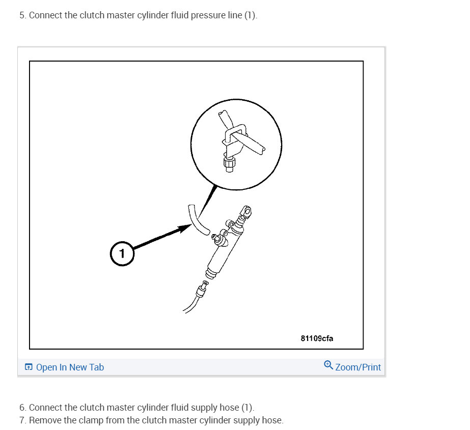

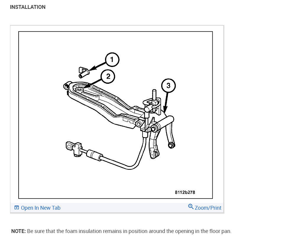

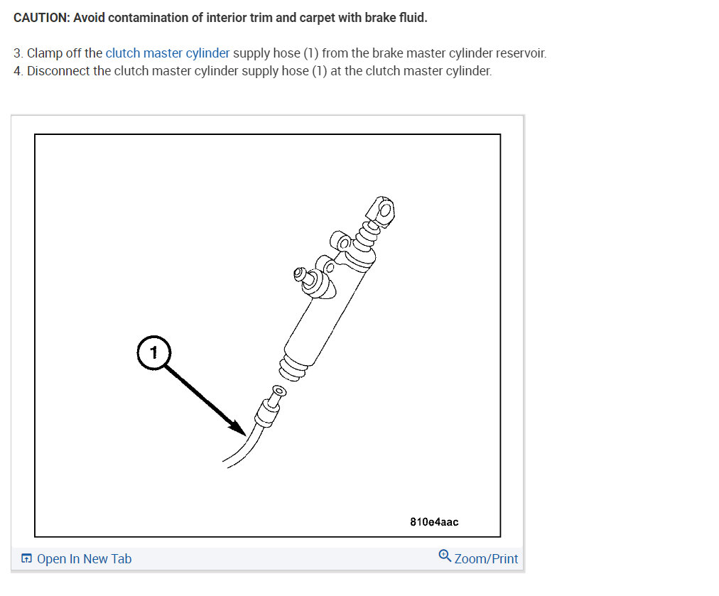

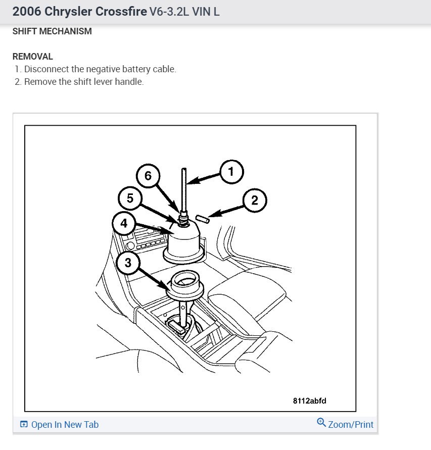

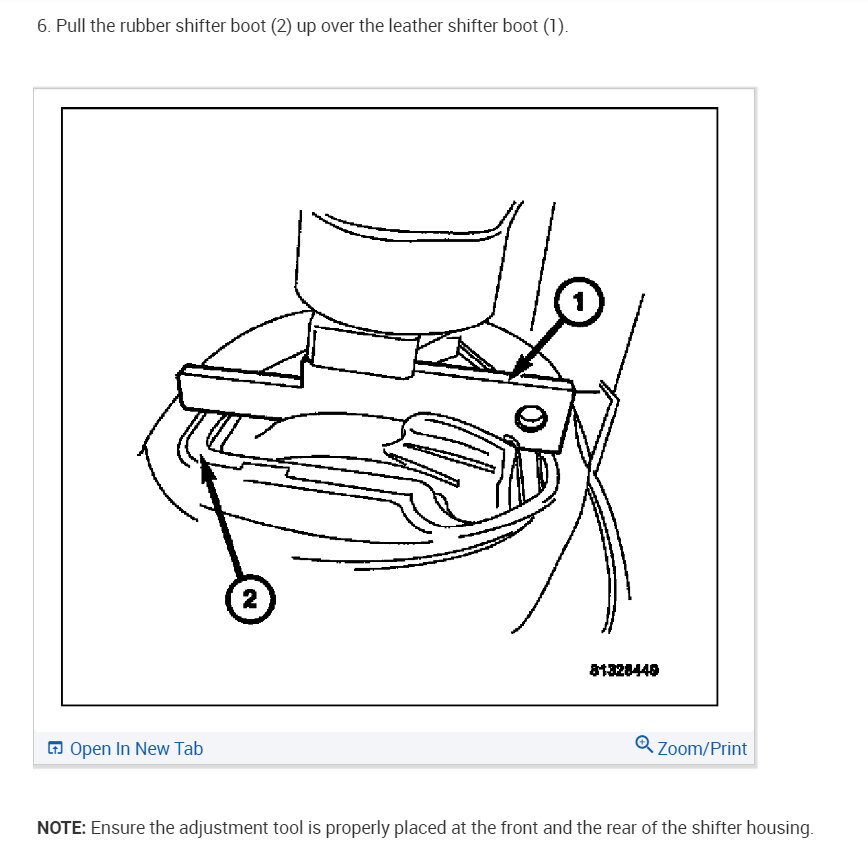

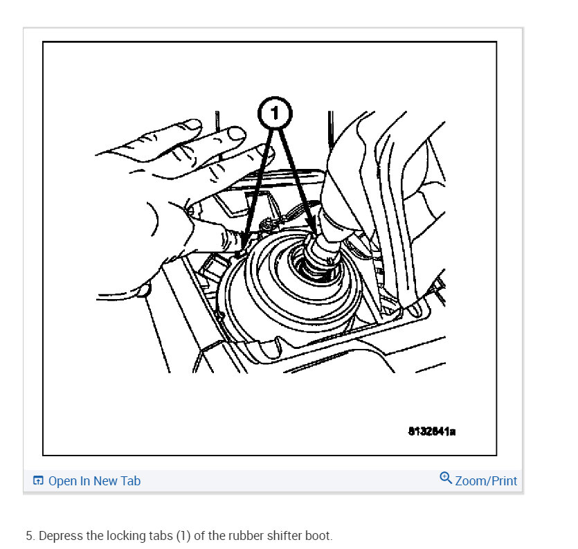

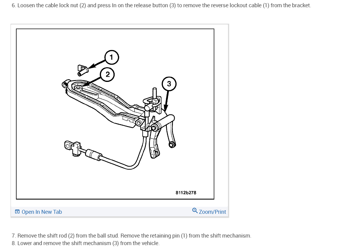

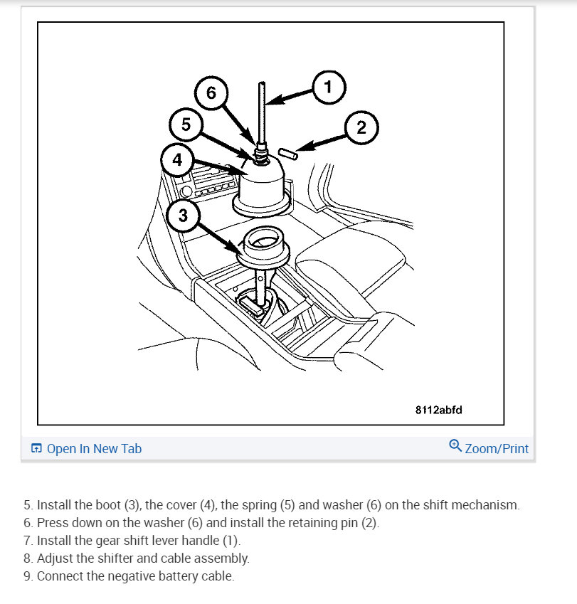

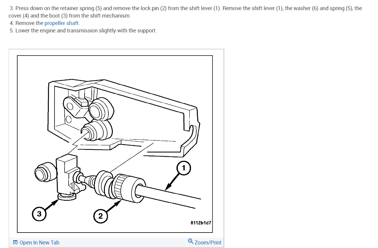

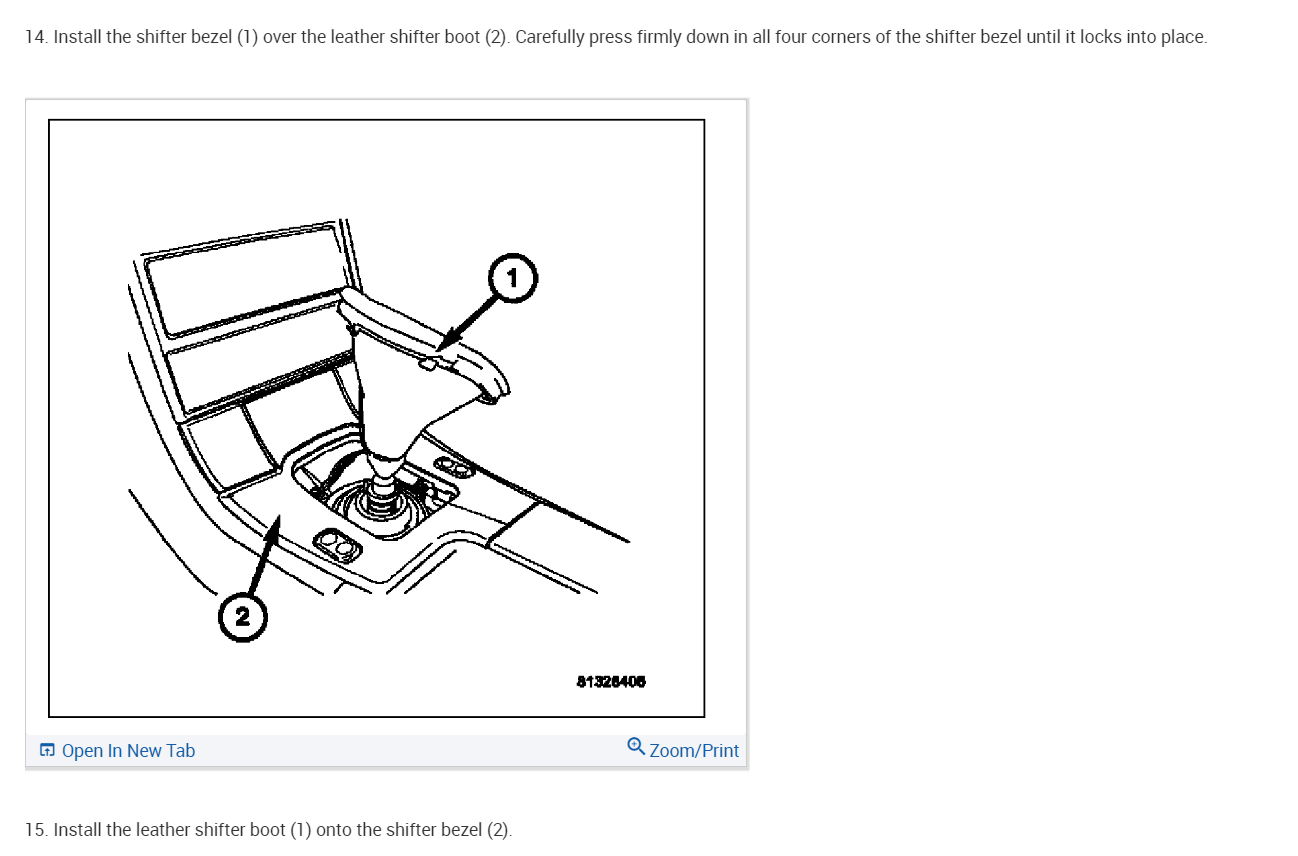

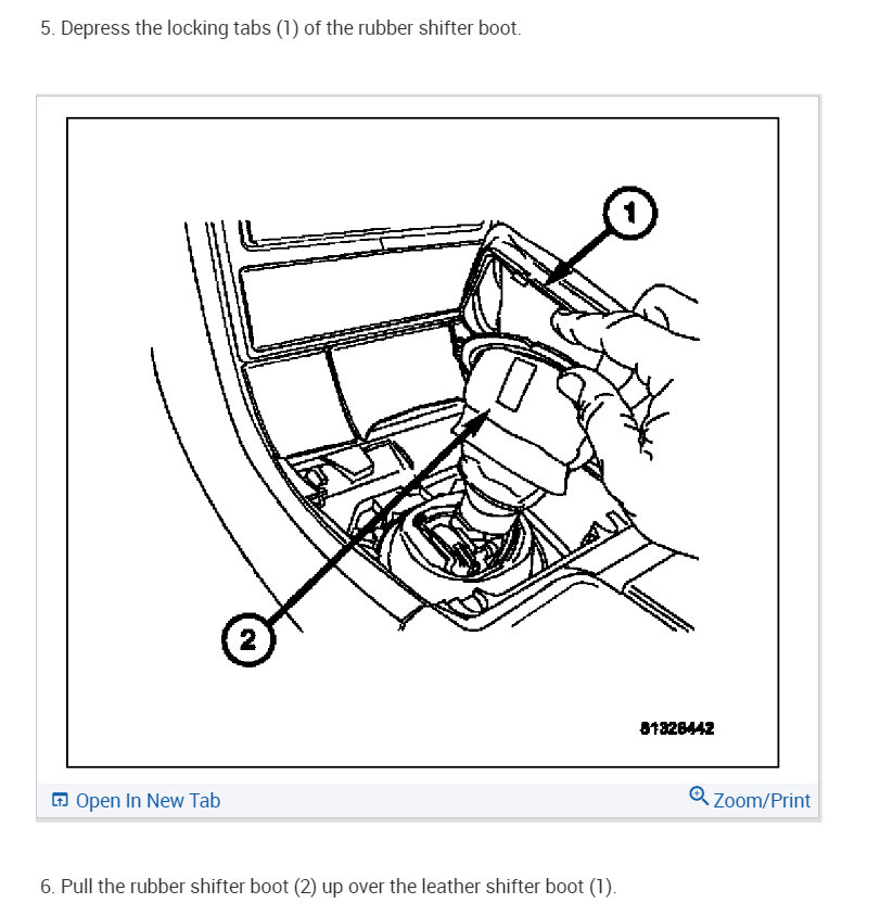

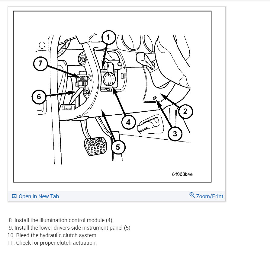

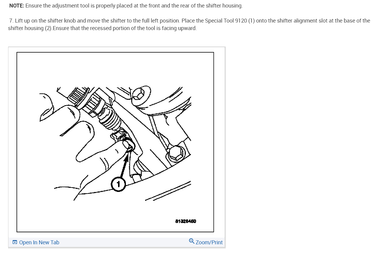

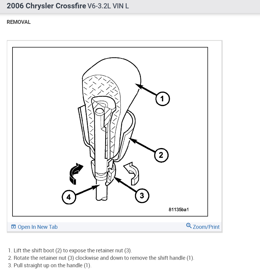

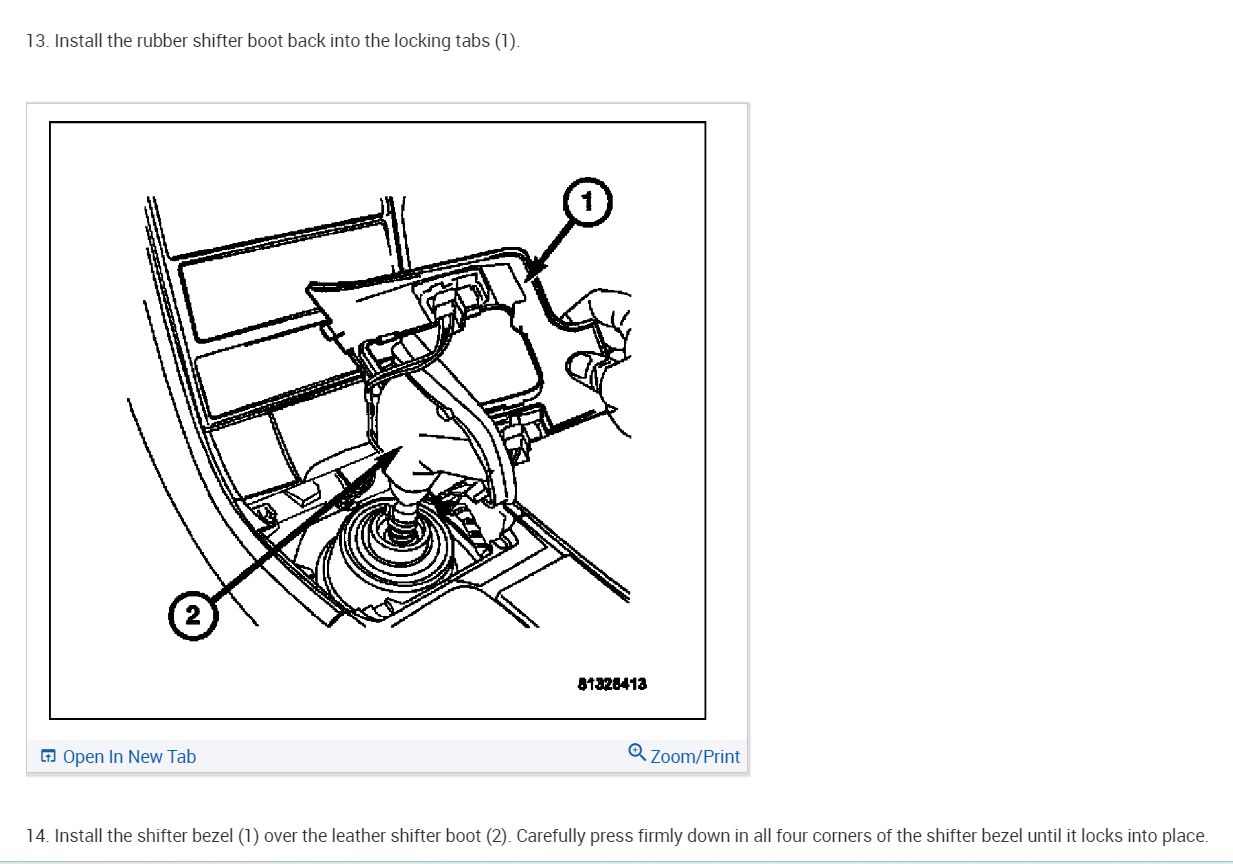

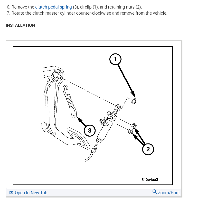

If the clutch is not working correctly, it will cause this problem, do you have issues with any other gears? If not, it could be the shifter can wear out or needs to be lubricated. Here is a video to help see the condition of the clutch and I have included how to service the shifter in the images below. Also, check to see if the clutch fluid is down. I have included the clutch master location and replacement instructions in case it is leaking.
https://youtu.be/EpBMj5ZY_bo
Check out the images (below). Let us know what happens and please upload pictures or videos of the problem.

Thanks for trying to help but my clutch does not slip, it doesn't go to the floor and the (2) best transmission shops in the area drove it without incident and determined that it shifted and worked fine but then after I get it back it will lock into 6th gear only whenever it feels like it. Sometimes when I shift from 1st to 2nd it will go into 4th. I did all of the clutch tests prior to u sending me the video and didn't have any of the issues in the video. I have a Mercedes transmission and engine. You have to drop the transmission to get to the hydraulic clutch.

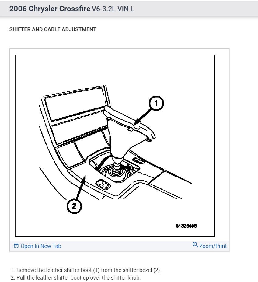

Yes, the shifting mechanism is where I would start, it could be just an adjustment for the cables, I would take it apart to look to make sure it is lubricated and adjusted correctly, you may have a shift cable that has worn slightly. Check out the images (below). Let us know what happens and please upload pictures or videos of the problem.
