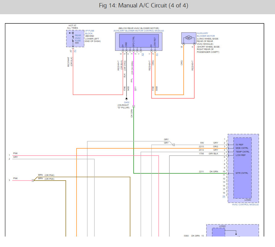

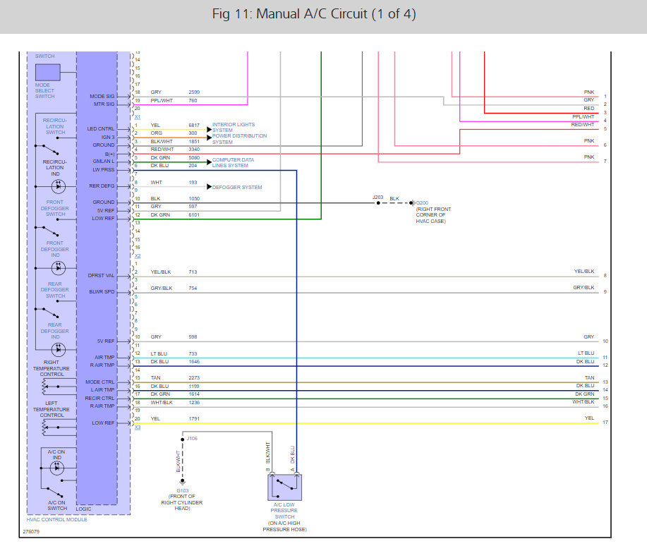

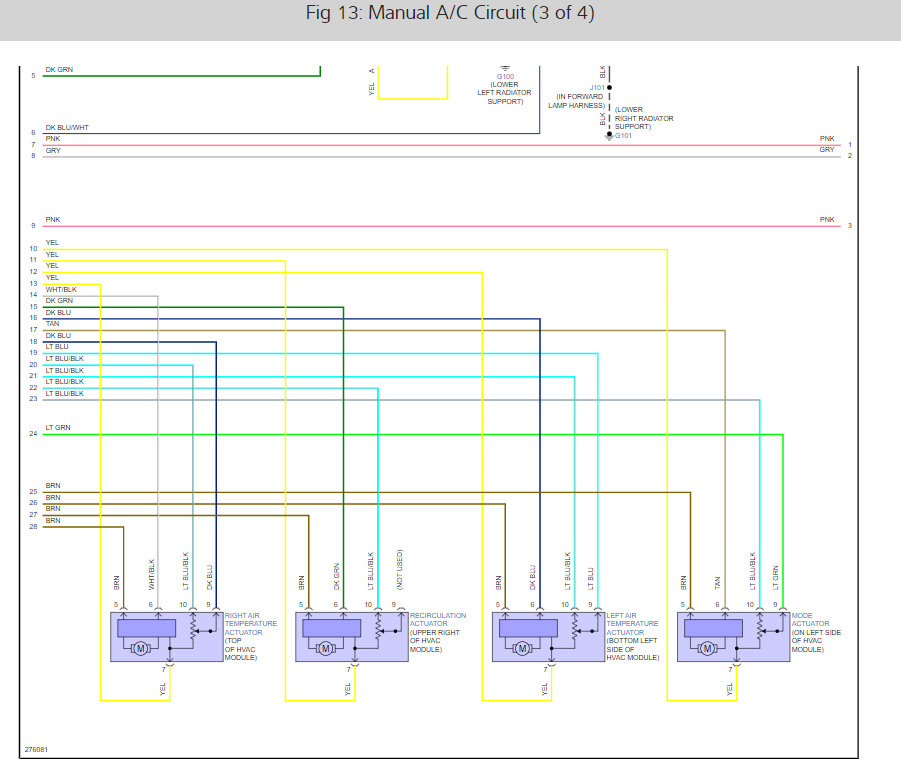

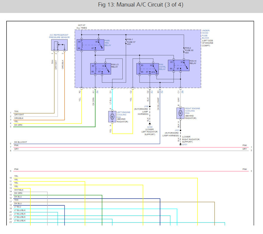

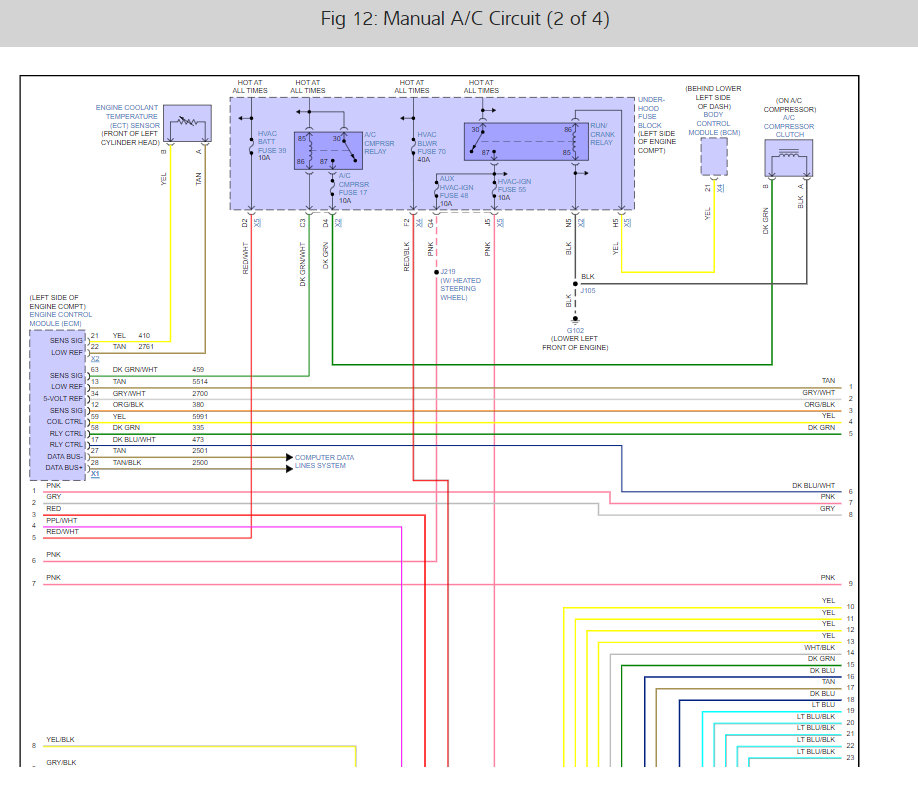

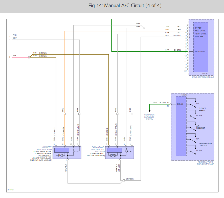

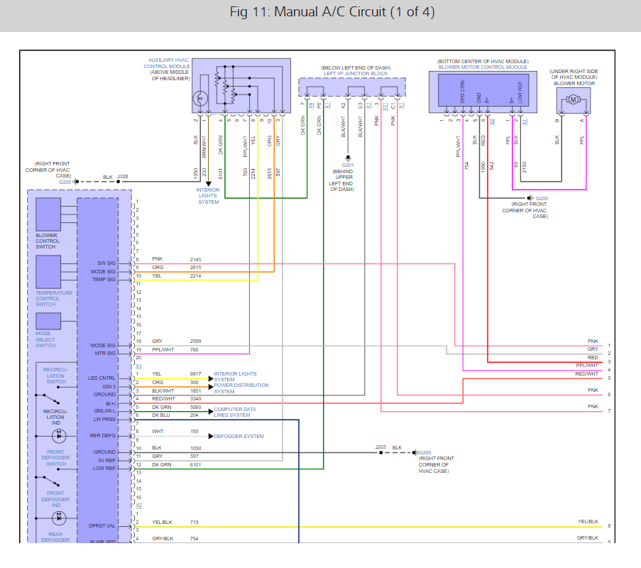

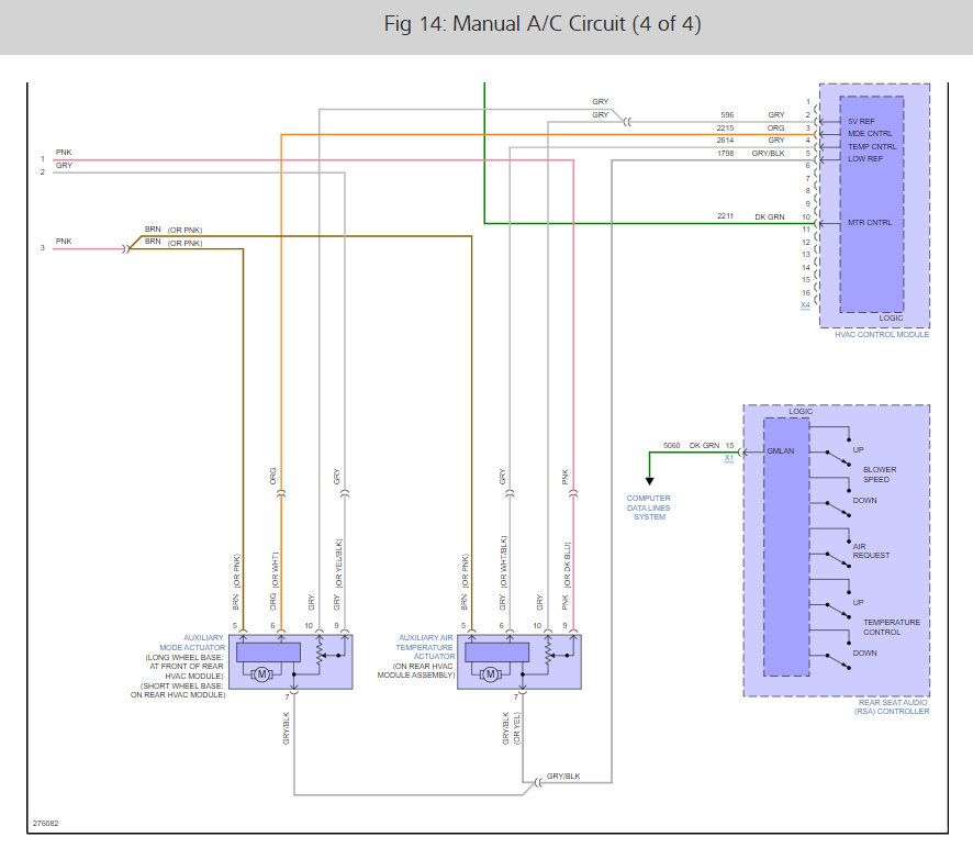

i need the wiring pin out for a climate control #25901393 brown J1, blue J2, grey J3 and green J4. Also, need the same pin out for an automatic climate control #25869946 J1 brown, J2 black, J3 grey, J4 green.
May 17, 2022 at 2:42 PM
  • 55,433 POSTS
Here are the air conditioner wiring diagrams and a guide to help show you how to test the circuits. Please let us know if you need anything else.
