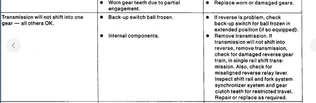

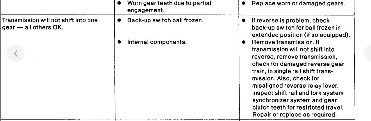

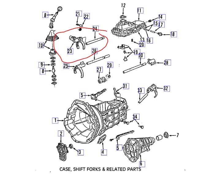

Gears 1 an 2 don’t work, but 3, 4, and 5 gears works fine. Manual 5 speed transmission.
Thursday, January 16th, 2020 AT 7:25 PM
MECHANIC
52,797 POSTS
Good morning,
This sounds like either the shift rail is an issue or something internal has failed.
Most likely the transmission will have to be removed and inspected for the failure.
