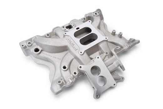

I am looking for the intake manifold for a 1986 ford f-150 with a 351 windsor engine
Nov 23, 2021 at 3:58 PM
This truck came with a 2 barrel carburetor, so those manifolds are hard to come by, which is most likely why you are asking.
Unfortunately, I am not finding any online after a quick search. These are much more rare than the 4 barrel as most people ditched them for the 4 barrel set up.
If you are not able to find one from a salvage yard or off an auction site, then you may have to go with a 4 barrel and either update your carburetor to fit that as well, or get an adaptor plate to fit your OEM carburetor.
Here is a link to Summit Racing who offers one:
https://www.summitracing.com/parts/edl-3771/make/ford
There are many other options, but Summit is clearly a good option.

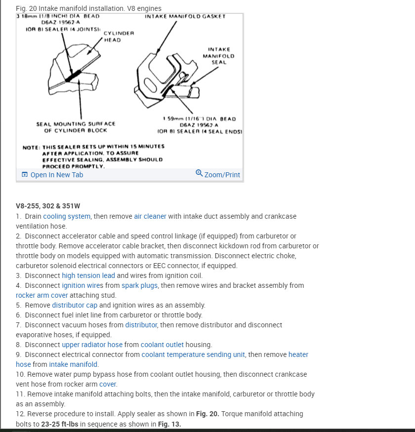

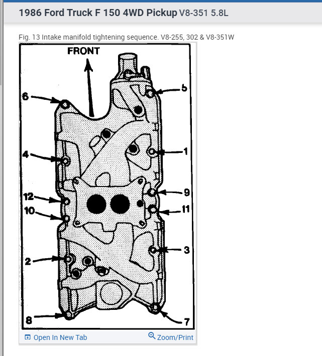

Below is the info from the manual, and picture of the manifold and adapter.
Please let us know if you need more info and we can dig deeper.
