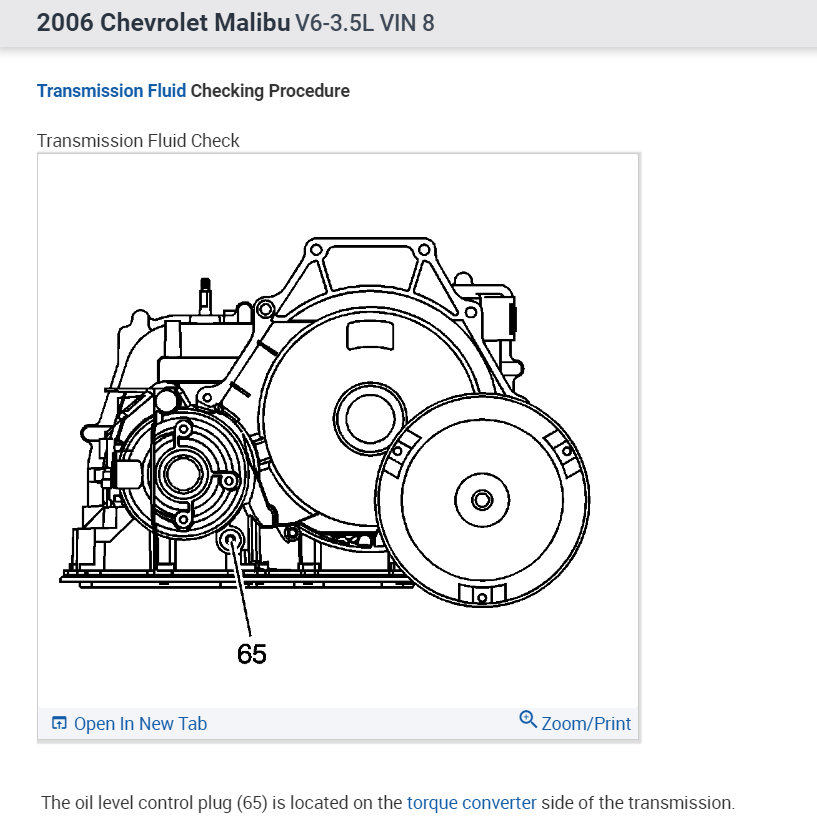

My car turns on but won't go forward or reverse, it goes into every gear it wraps up like if it's normal no grinding noises know anything like that.
Jun 3, 2022 at 4:14 PM
  • 54,837 POSTS

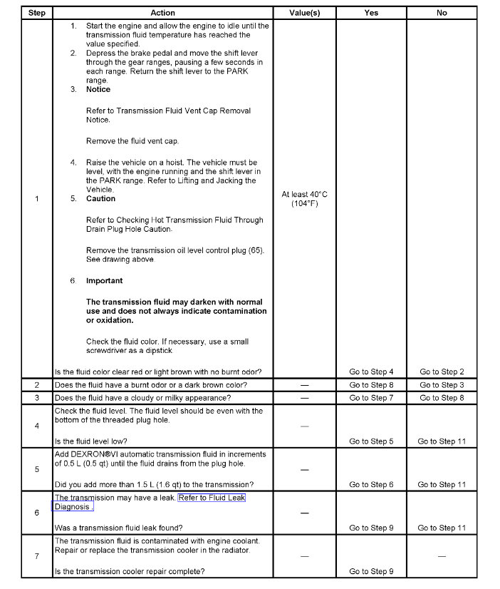

It sounds like the fluid level is low which is an easy check. Here is guide to help you with instructions in the diagrams below to show you how for your car:
https://www.2carpros.com/articles/how-to-check-and-add-transmission-fluid
AUTOMATIC TRANSMISSION 4T45-E
Bottom Pan Removal .................... 6.5 liters (6.9 qts)
Complete Overhaul .................... 9.0 Liters (9.5 qts)
Dry .................... 12.2 Liters (12.9 qts)
Measurements are approximate
This guide can help as well:

RAYMONDPERALE
Looks like there's too much fluid.
Jun 7, 2022 at 4:54 PM
  • 54,837 POSTS
Remove the plug and allow it to drain out to the proper level, this can cause the transmission fluid to get air bubbles in the fluid which can cause the transmission not to work. Make sure the engine is running while checking the fluid level.
