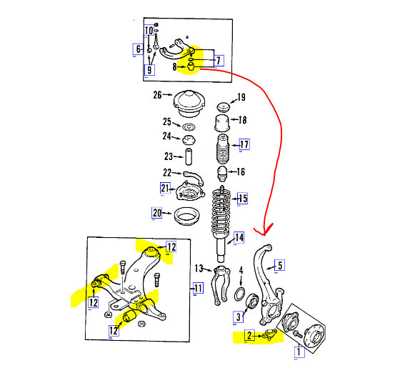

I did hear it. Since this only happens when you first start moving, the first thing I recommend is to lift the front of the vehicle and check if there is play (back and forth) in either of the front wheels. Place your hands at 3 and 9 o'clock and wiggle. Do the same with your hands at 6 and 12 o'clock.
Next, check to make sure the axles are in good condition. Inspect the rubber CV boot at each end of the axle to see if there is a loss of grease.
Also, when you have one wheel safely off the ground, place a pry bar between the tire and the road and pry the wheel up and down to make sure there isn't any play in the ball joints.
One other thought. Make sure none of the bushings on the lower control arm are worn or damaged as well. I attached a pic below showing the suspension components to check.
Let me know what you find.
See pic below.
