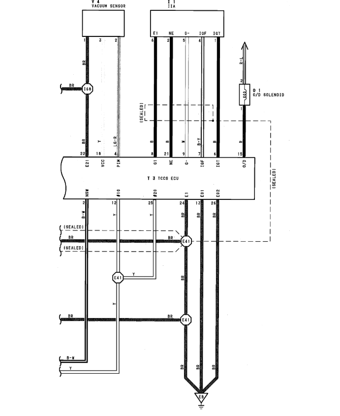

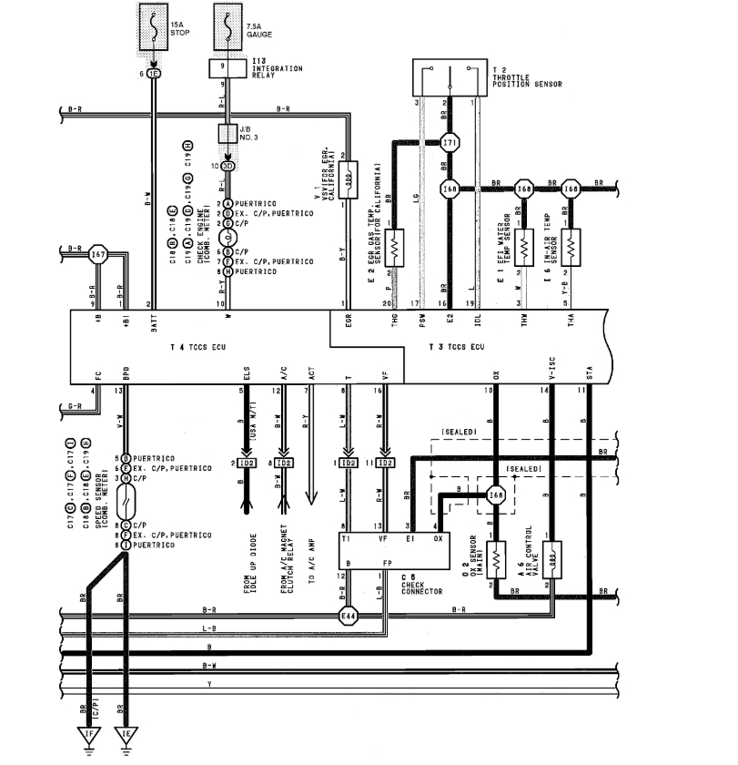

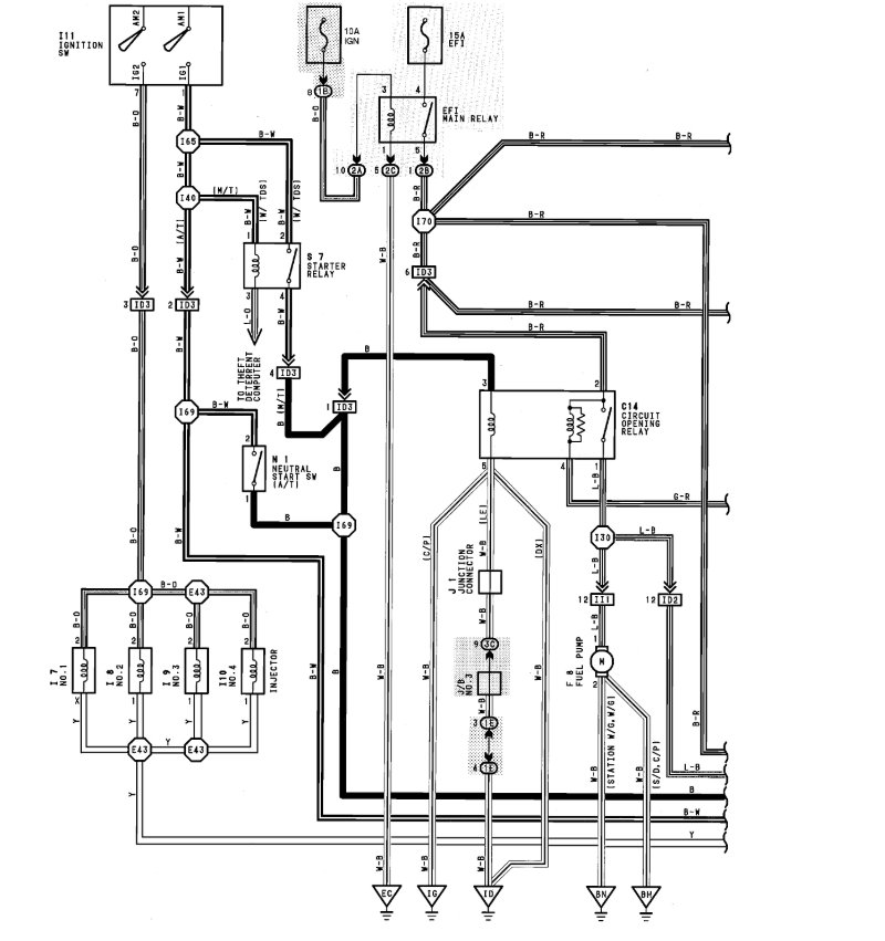

Here is a guide to help you fix the wiring harnesses and the engine wiring diagrams below.
