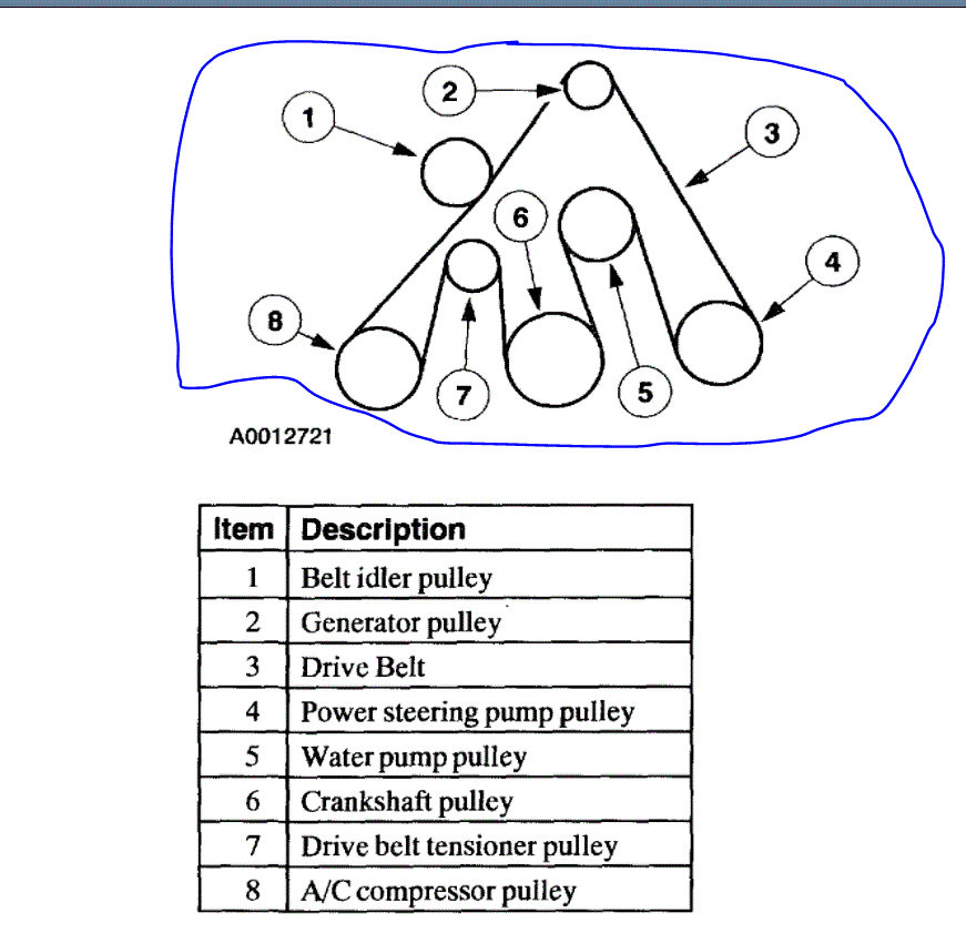

Ticking nose when idling and when I start to get up to 30 MPH it stops
2002 FORD EXPLORER
160 MILES • 4.6L • V8 • 4WD • AUTOMATIC
BIGJOHNJHON
Not too loud, like a fan is hitting something.
Dec 13, 2020 at 9:15 AM
  • 110,194 POSTS
Have you checked the fan for evidence of something touching? Also, inspect the belt to make sure it isn't coming apart.
Here is a link you may find of interest. It discusses engine noises. See if you feel something mirrors what you experience.
https://www.2carpros.com/articles/engine-noises
As far as the serpentine belt on the vehicle is very long. You can do a visual on it or remove it and start the engine for a few seconds just to see if the noise is gone. Then we can determine if it is the belt or one of the belt driven accessories.
I attached a pic below showing the belt.
Check these things and let me know what you find. Also, if it's possible, record the sound and upload it for me to hear.
