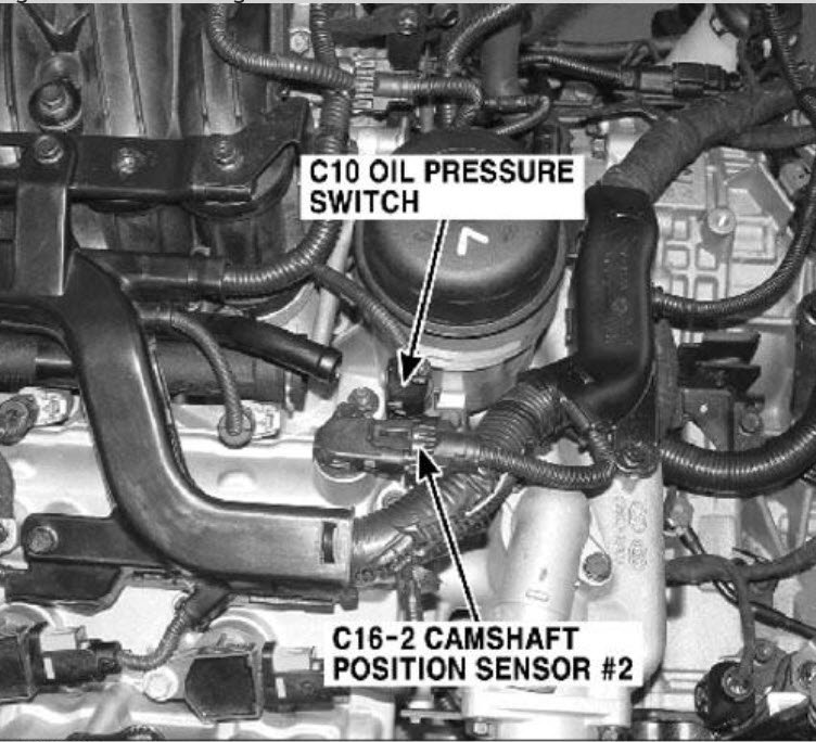

location of the oil sending unit Oil is leaking badly
2010 KIA SEDONA
100 MILES • V6 • AUTOMATIC
AMOSSY2013
Oil is leaking badly just pouring right out. I need to know where the oil sending unit is located so can fix this problem or any advice on how to fix this? on my van. thanks.

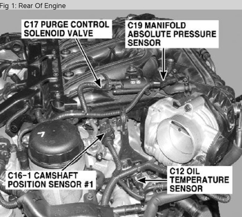

if it is not the sending unit it may be a plug has fallen out or an oil filter loose. there is also a temperature sender so it could be that. I have included both. Check out the diagrams (Below). Please let us know if you need anything else to get the problem fixed.
