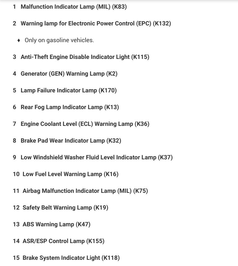

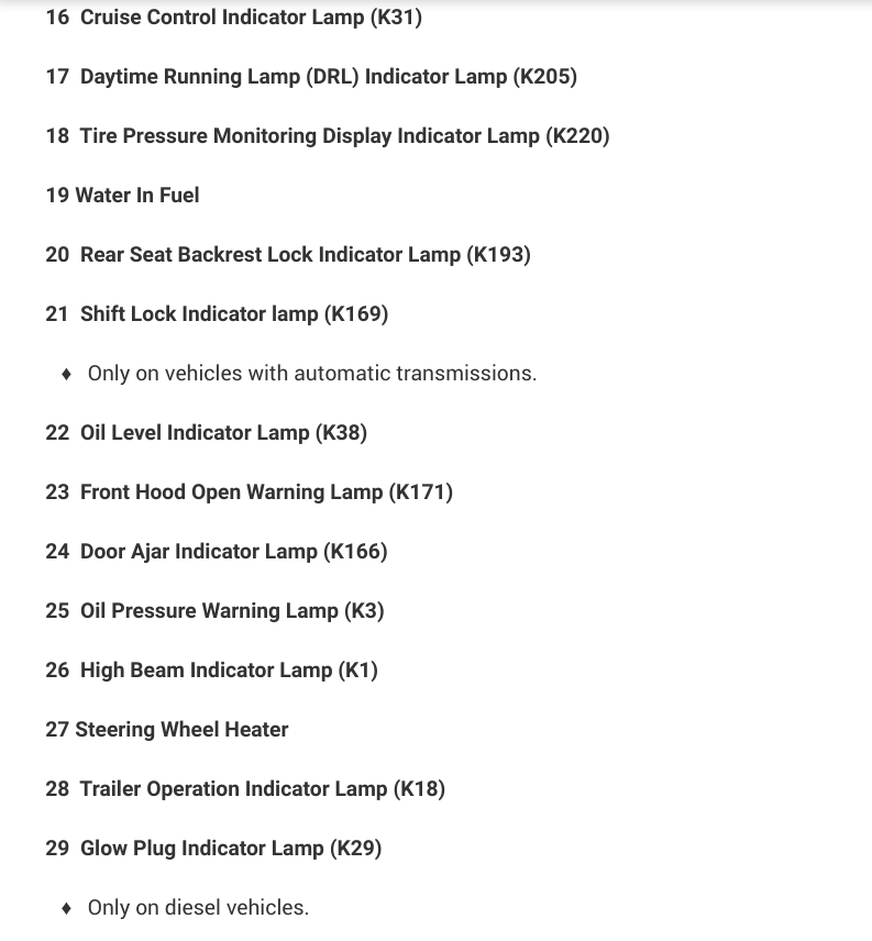

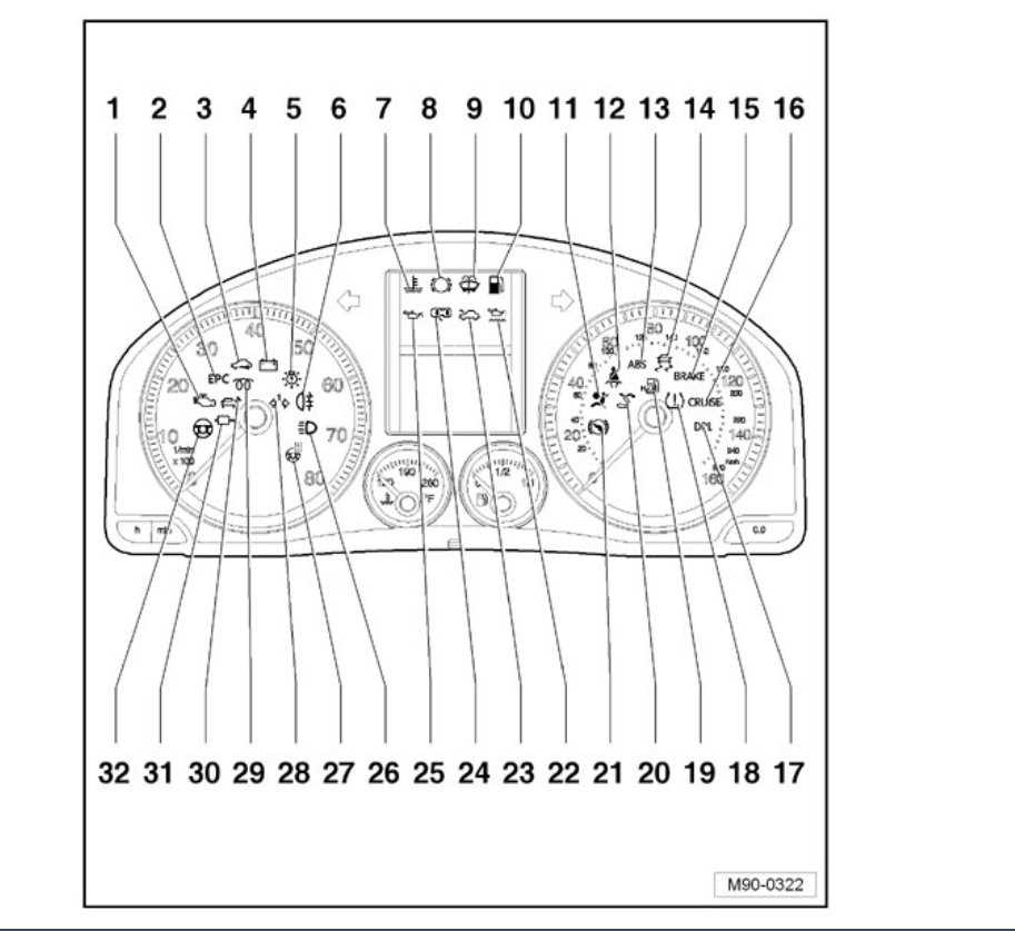

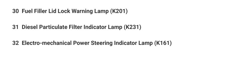

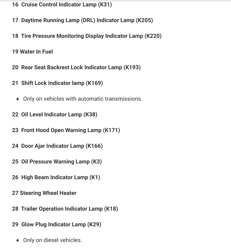

Did some more digging and the vacuum pump had a big leak in the hose going from the vacuum pump to the break booster I fixed that leak and it eliminated the crank case pressure building up. but the abs traction control and a steering wheel symbol and engine light are on I haven't checked the compression yet but it seems to run the same with no issues could the leak from the vacuum pump cause the abs,traction control and the steering wheel symbol stay on? I've cleared all fault codes multiple times taken the battery out and everything and the lights are still on. And if someone could let me know what the steering wheel symbol mean I'd appreciate it. Thank you
Mar 5, 2020 at 9:41 AM
SCGRANTURISMO
  • 4,897 POSTS
No, they have nothing to do with each other. In the diagrams down below I have included a diagram with callouts of your vehicle's instrument cluster. Please go through this guide and get back to us with what you find out. I hope this helps.
