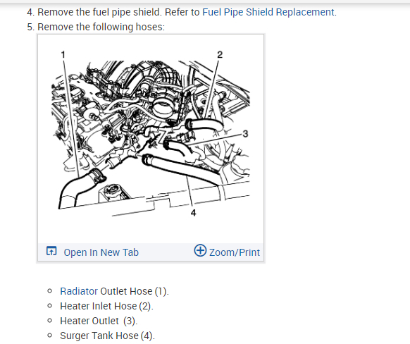

It could be a few things. Let's hope it is a simple thing.

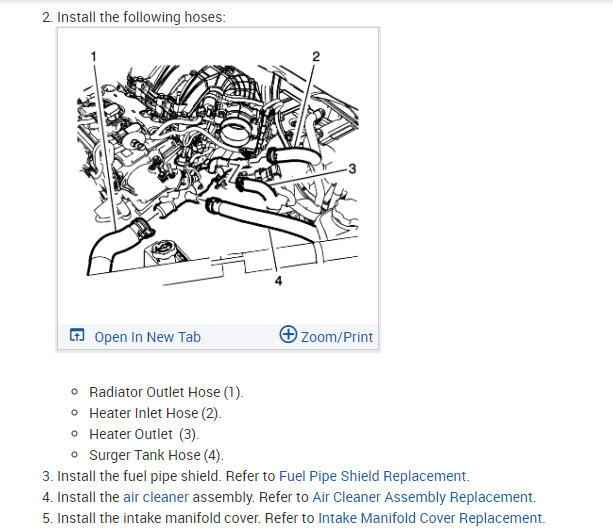

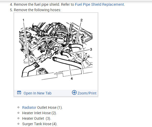

Several hoses attach to the thermostat housing, so make sure to inspect them. If you are filling it through the radiator, check the upper radiator where it mounts to the housing. If you are filling through the surge tank, check that hose. See pic below.
Let me know. Also, if you can, blow out the water from that area, dry it, and slowly add coolant to see where it is coming from.
Take care and let me know what you find.
See pic below.

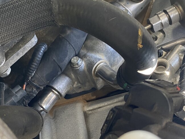

It's not coming from thermostat or hoses, it's a small opening right next to the thermostat housing where it's leaking from.. the leak is internal but coming out in between the head and the block.

Is it the thermostat housing that is leaking? There really shouldn't be anything open. If possible, could you upload a pic of where you are seeing the leak come from?

It's coming from this small gap where it looks a little orange.

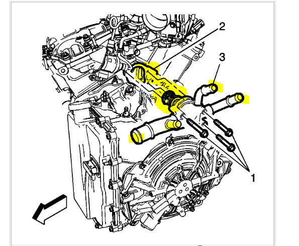

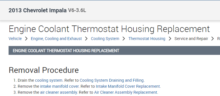

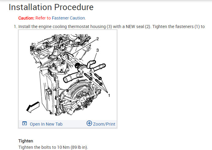

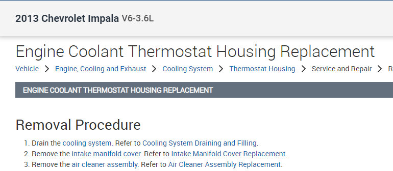

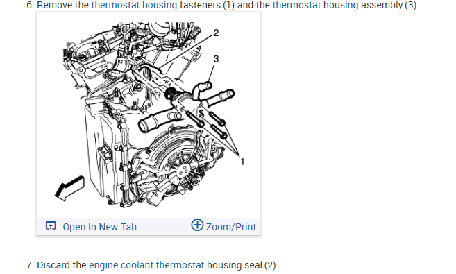

If I had to guess, I would say the thermostat housing is leaking where it mounts to the engine. I would drain the coolant down below that point and then remove the housing to see if that is correct.
Let me know if that is something you are comfortable performing. In the back of my mind, I hear you saying there was a freeze there. How cold did it get and how long did it stay below freezing?
Below, I attached directions for the removal and installation of the thermostat housing. I would think if anything cracked, the housing would have been first. We need to remove and inspect it.
