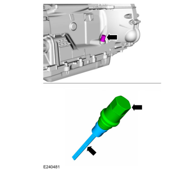

Where exactly do I install the new fluid?
Dec 31, 2018 at 4:36 PM
I am sorry. This transmission gets filled from under the car at the fill plug.
There are two transmissions and the one for yours shows this. I attached a picture for you to view.
the pump you showed earlier looks like a good tool to use to add the fluid. just be sure you do not overfill the fluid level.
