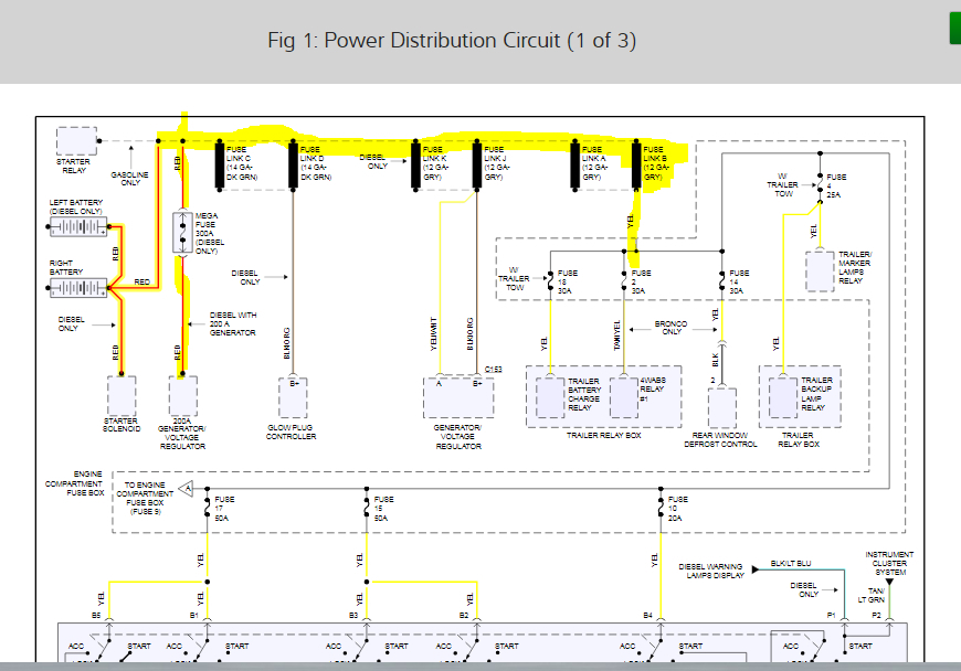

Arced power from alternator power post to engine and blew main power fuse/link. How do I fix ?

No power to fuse panel, so it's Step 8. It appears to require removing the fuse box as the relay is underneath. No clue how to get this done.

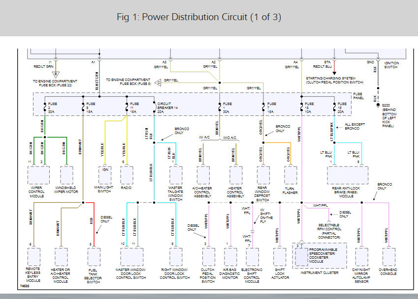

If you are not getting power to the Engine Compartment Fuse Box then you need to replace Fusible Link B. I have sent wiring diagrams in the diagrams down below for reference.
