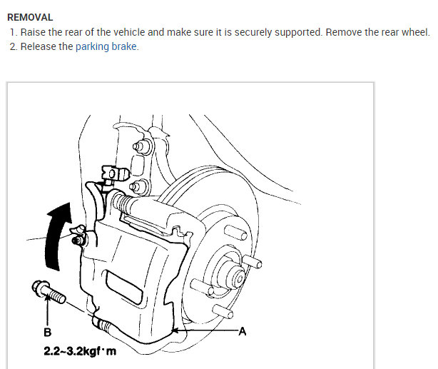

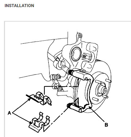

Hello... I have a Hyundai Tucson , and about two months ago the alternator broke, so... I bought a new one. Now I see the brakes are gone in the front I need help. thanks for your answer me !

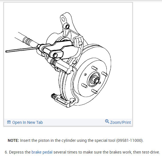

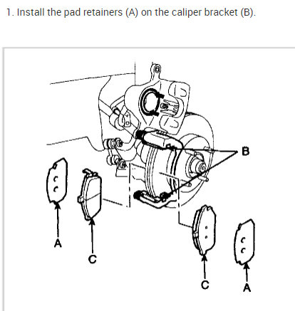

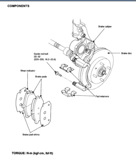

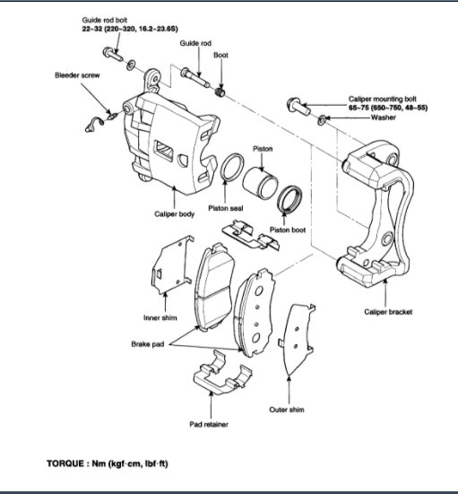

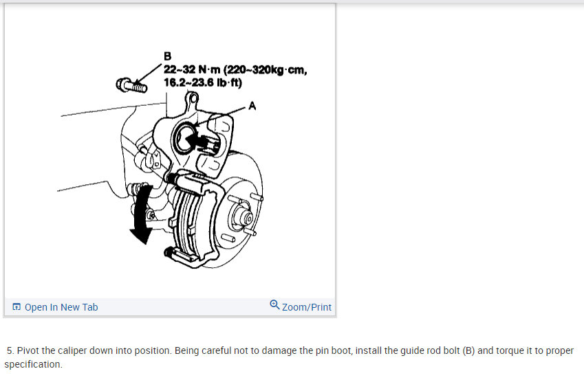

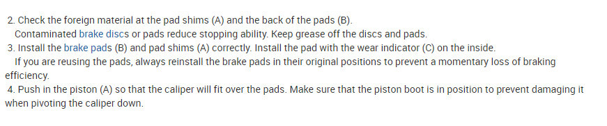

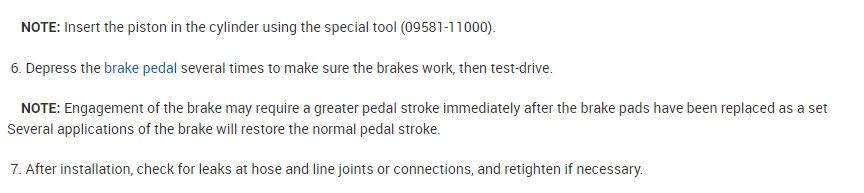

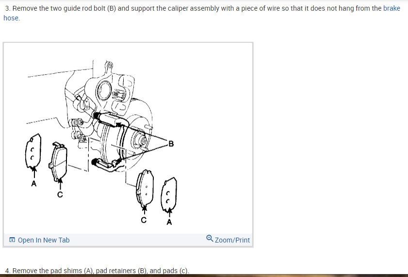

Here is the information you requested. This is a tutorial showing what is involved on how to change front brake pads and brake rotors:
I've attached picture steps below on how to change the front brake pads on your SUV. Hope this helps and thanks for using 2CarPros.
